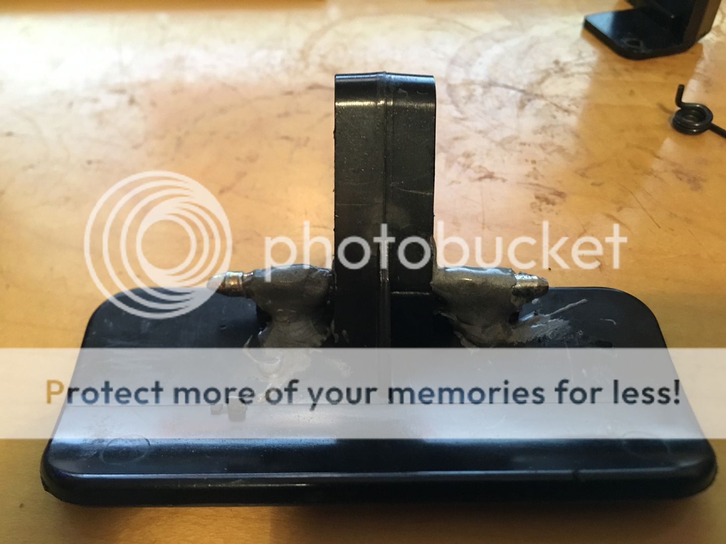

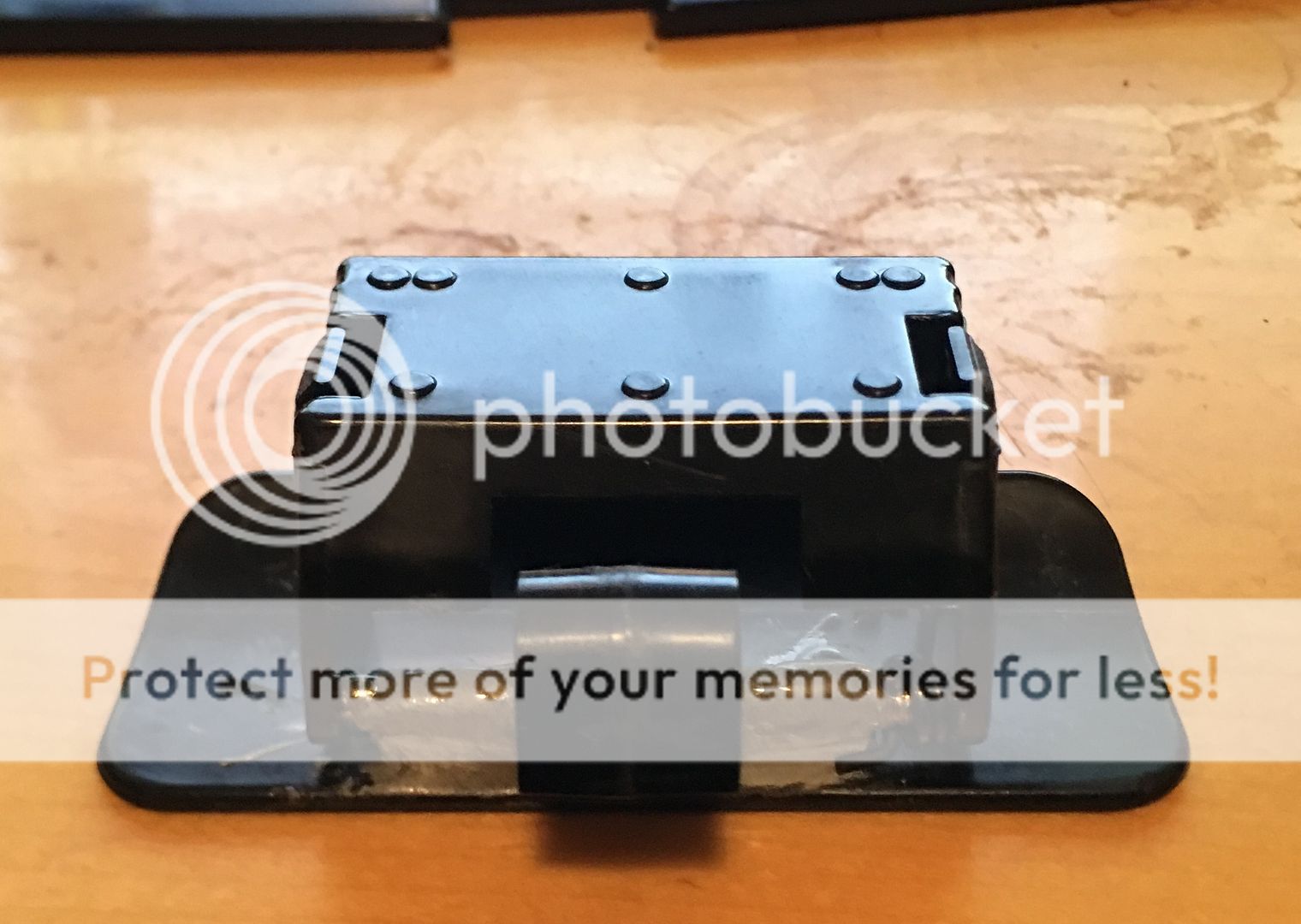

anoneamus
Posts: 774
Location: Cape Town
Re: Glove box lid ?
Post by anoneamus » Tue Apr 09, 2019 1:11 pm
This is how junk they are. This one has never been used and it's almost ready to break (see red circled bit is bending, that piece eventually snaps off).
The fix involves drilling out the center plastic and replacing it with something metal. I've used "metal" epoxy to make the whole thing stable. It doesn't need to be pretty (you don't see this part), just strong.

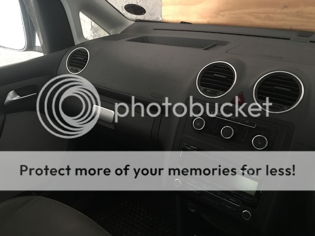

anoneamus
Posts: 774
Location: Cape Town
Re: Glove box lid ?
Post by anoneamus » Tue Apr 09, 2019 1:33 pm
If you have extras (I have 5 in total now!) you can experiment. Here's one I sprayed silver to match the "aluminium" interior bling

Re: Glove box lid ?
Post by bob86 » Tue Apr 09, 2019 2:01 pm
thats perfect, thanks. the pics weren't working on my phone, so had to get the laptop out. then I can also see the others too.
looks pretty straightfoward
