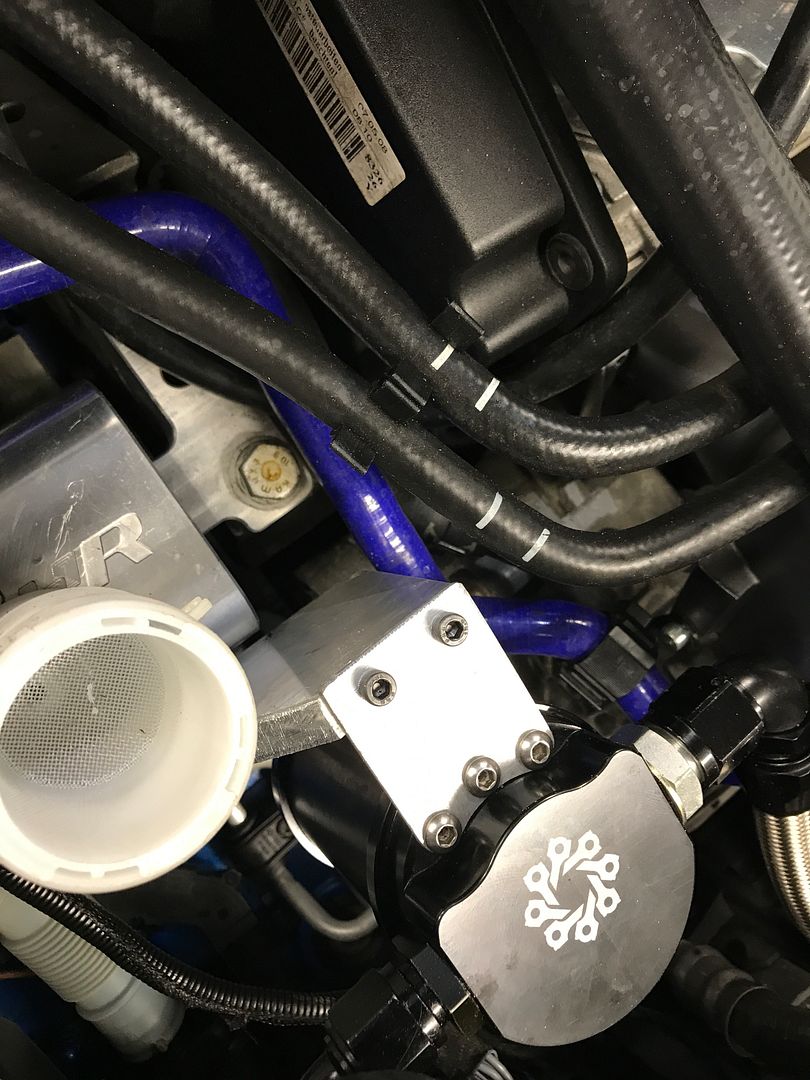

Another thing that needed attention was the catch can drain port. Decided to fit a piece of tubing and have the drain valve somewhere thats easier to access but that meant moving the catch can slightly. Luckily I had some aluminium so made up a bracket from some 12mm flat bar, drilled and tapped some holes and made a different bracket that bolts onto the catch can and attaches to the main bracket. Its big on purpose - there's only 1 mounting point for the bracket so I've made sure it pushes up against the engine mount to stop it moving.
