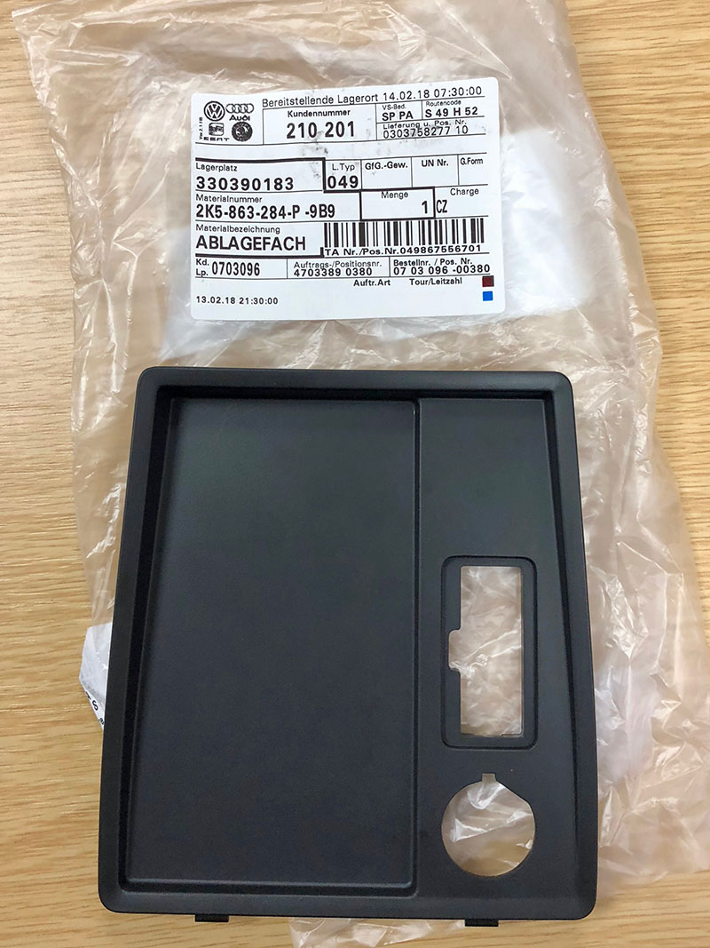

Ordered a replacement centre console tray from TPS, and an Inbay universal Qi pad, which happens to be a similar size to the base of the tray. The new tray is so that if I make a mistake on this I can put it back - basically I will need to Dremel off a couple of plastic lugs from the tray and attach the pad to the underside - then wire up from the 12v supply adjacent to it. There's rubber insert available for this tray, which I already have.

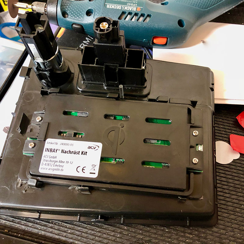

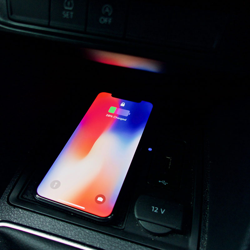

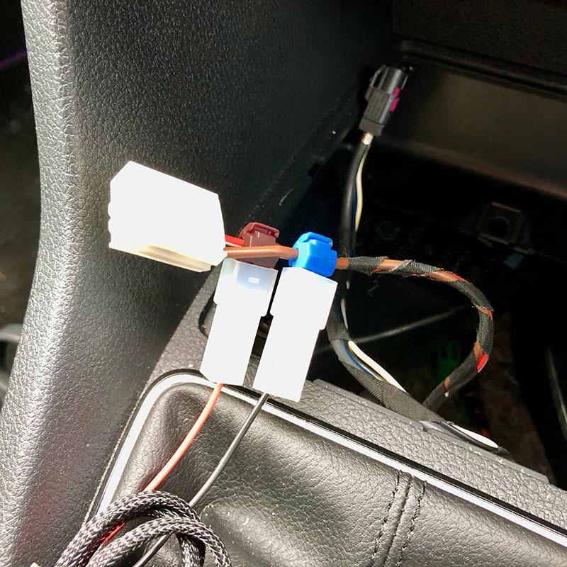

Started the wireless charging today.
Removed tray by pulling up at the front with a trim tool.

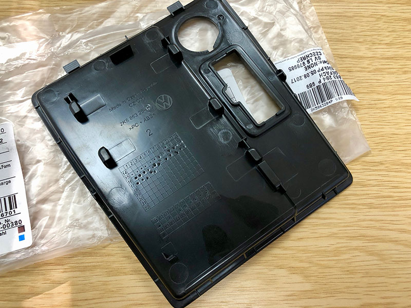

Modded the base of the tray with a small disc cutter to remove the lugs present (judging by the size of these clips, I wonder if a future Caddy will have wireless charging as an option? They were only a few mm different from the charging pad).

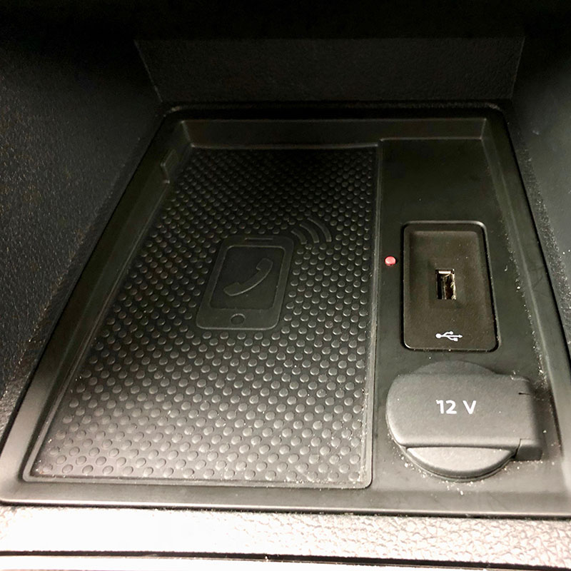

After a couple of test fits to make sure nothing was in the way underneath, fixed the pad to the base and wired to the 12v socket.
Drilled a small hole for the status LED, checked it was working (maximum 8mm gap between phone and pad) and replaced phone tray.

Part no. for tray is 2K5 863 284 P 9B9, around £16 inc VAT from TPS. It probably wasn’t necessary because the mods to the clips underneath were so trivial there’s little risk of breaking it. Note that this is for a mk4 Caddy, you will probably have to do something different for a mk3.
Rubber mat from TPS, part number 2K5 863 330 9B9

What are these crimp connectors you've used here. I don't think I've seen them before

^^ they came with the kit. There's two pairs provided, one for 1.5mm cable, the other for 2.5mm. I ended up using one of each type as the +ve & -ve cables on the 12v socket were different.
They simply snap on with pliers round the cable, and the spade ends of the charger connectors plug into them.
