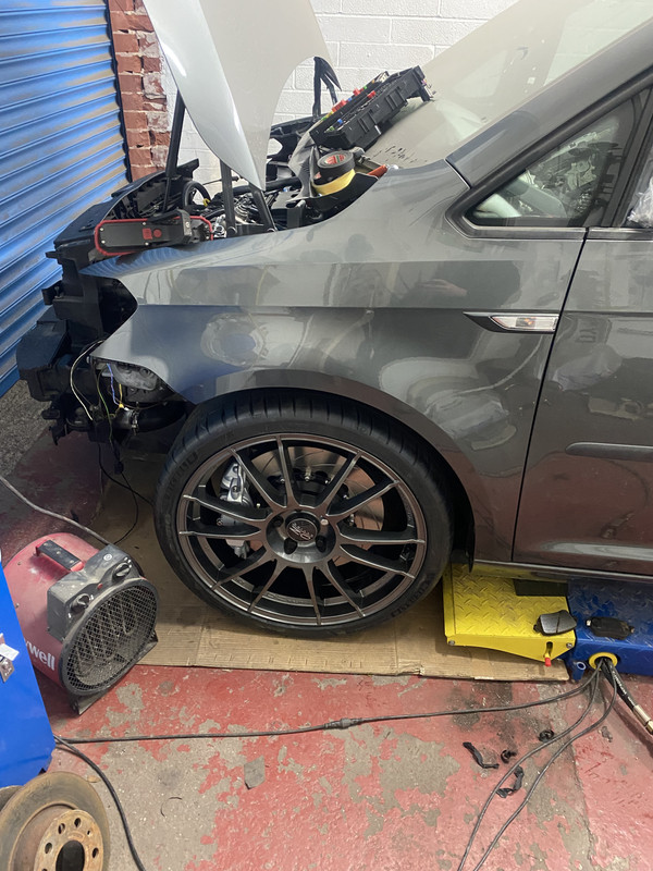

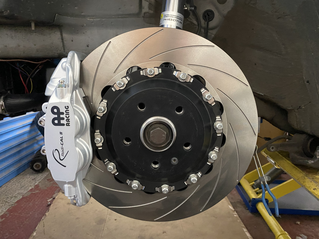

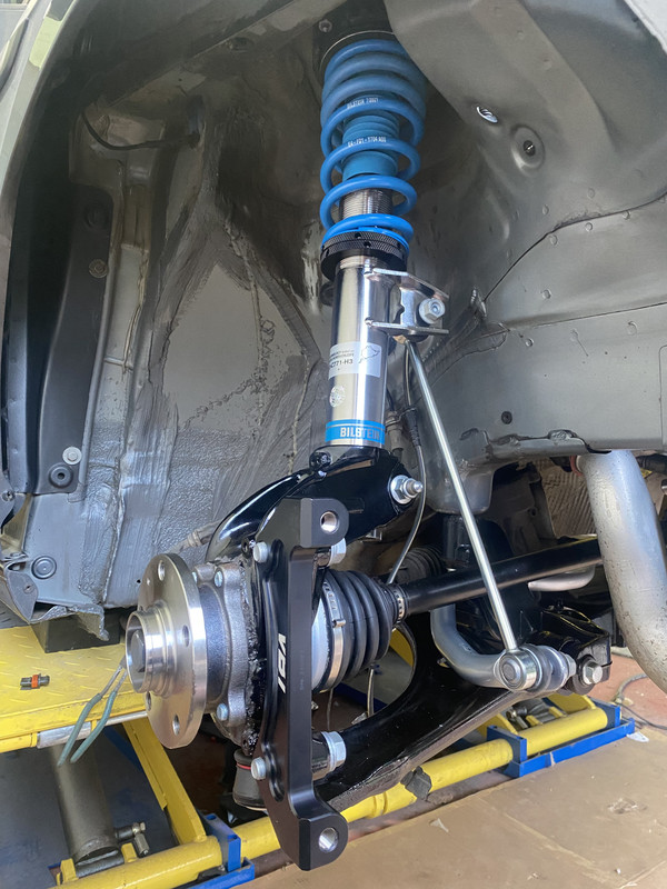

Front end, Aluminium subframe, arms, hubs, new bearings and the brake set up on…

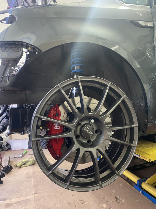

Wheels test fitted…
Moved on quite a bit…
Wheels test fitted…

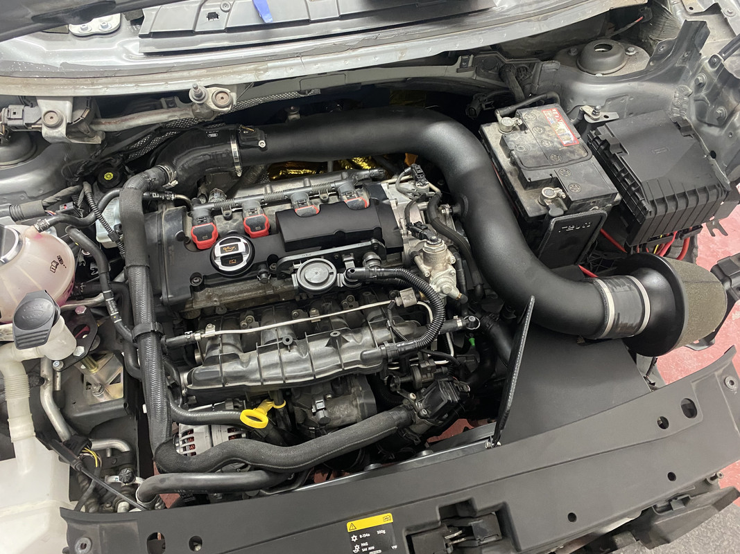

Engine is now in and complete. Wiring complete, just needs a base map to run more than just moving it round…
Still a lot of finishing to do, but it’s in and running.
Huge thank you to Doc… it simply wouldn’t my have happened without his genius!

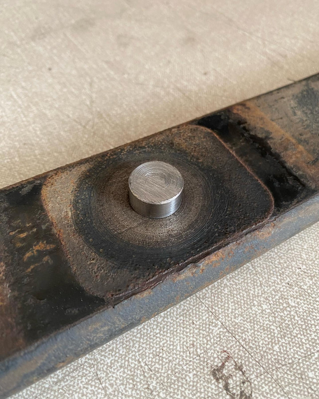

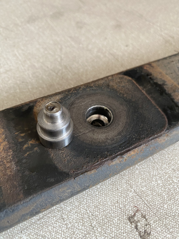

Then onto the rear suspension - the old caddy being on air ride with a 4link and watts links set up, I was keen to have the rear setup right… and tight.

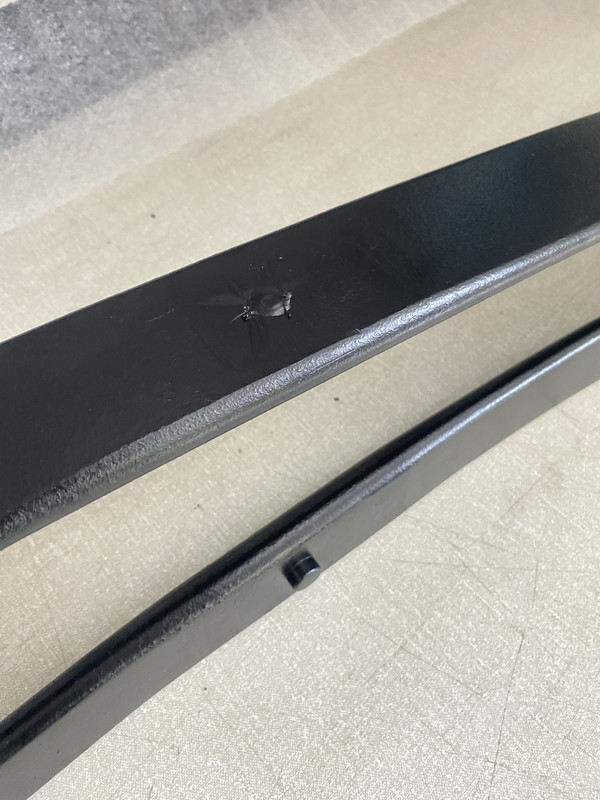

Weld on flip kit instead of shackles…
Which involved reversing the leak peg - which involved matching a new peg and welding it in.

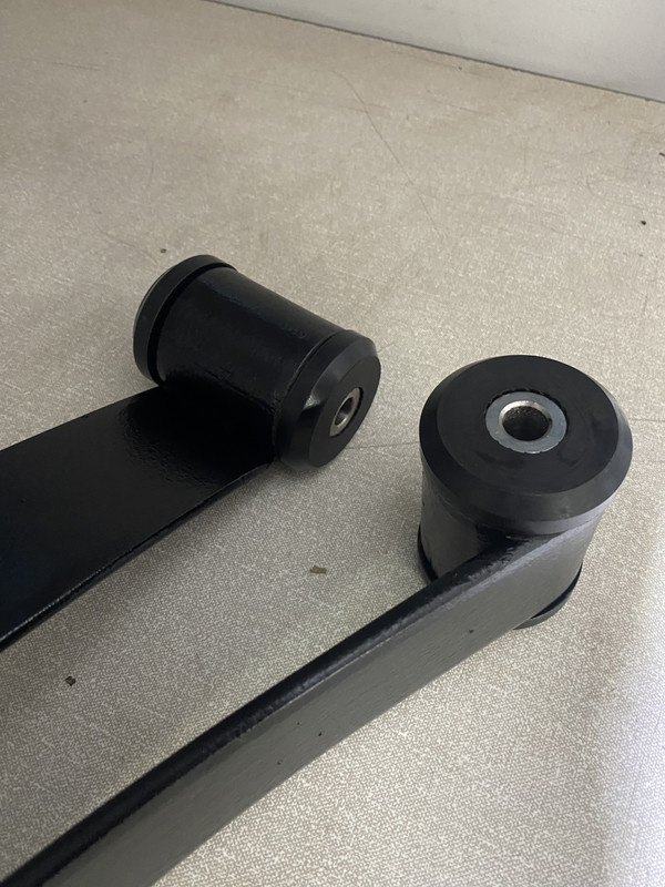

Black race polly bushes installed:

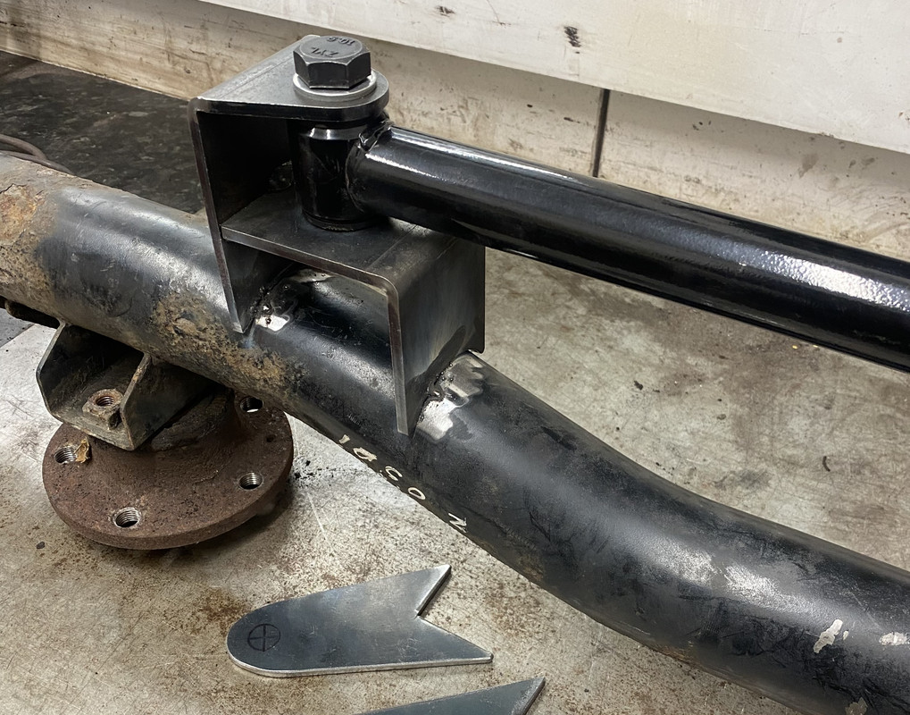

To keep the rear beam central and zero wobble, I designed and made a panhard bar set up.
When on the floor it sits almost horizontal- happy with its position.
Then everything bolted on…

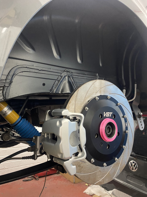

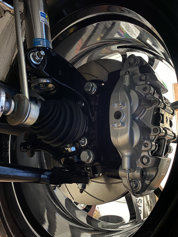

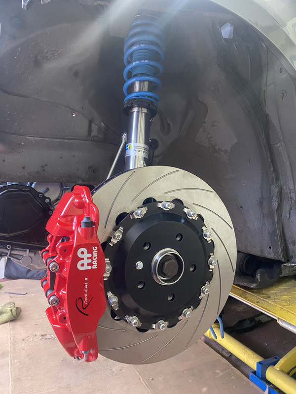

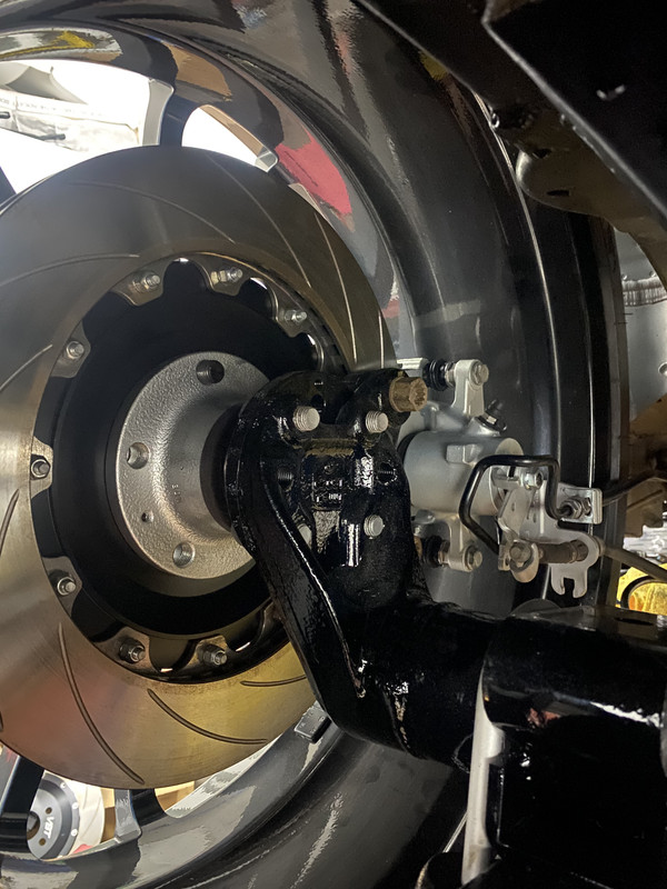

Calipers in for a colour change to satin silver all round…
Brake set up is:
Vbt front Ap racing 4pot radical with twin bell and rotar.
Rear vbt vented r32 Caliper with their 345mm (I think) twin bell and rotor setup.
Brake set up is:

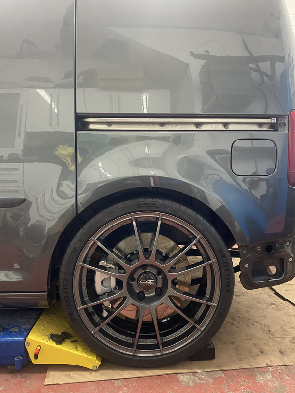

Tyres fitted and tear fit on the caddy..
And they look huge! No rubbing or touching anywhere but then it isn’t lowered to where I want it yet…

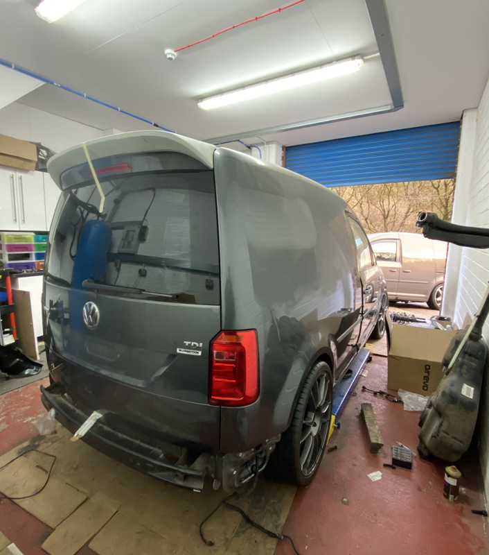

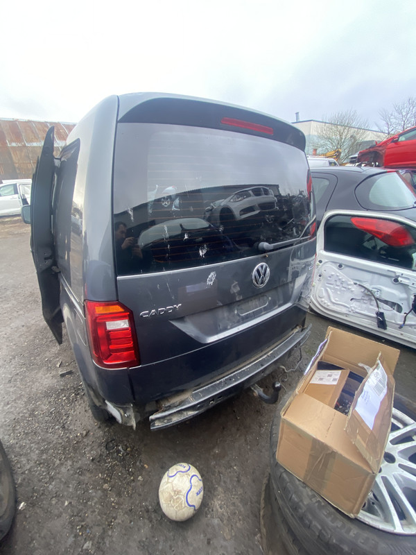

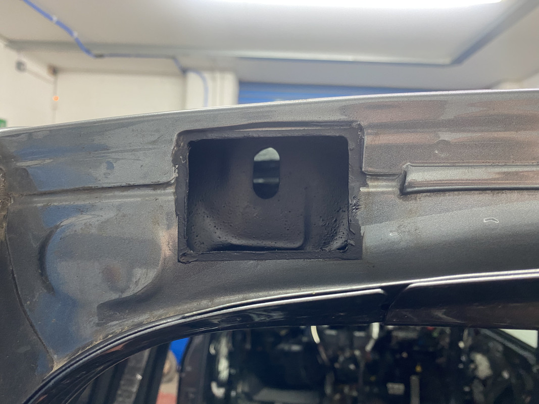

Then I found a tailgate (which I have always wanted) at a breakers - which they let me remove it and everything needed for it!
Then the tricky part of cutting the areas needed to mount.

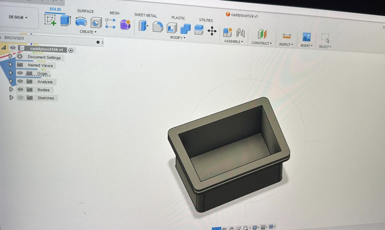

I wasn’t keen on fitting a whole replacement panel which would mean drilling the rivets. Peeling the roof back etc. so I settled on cutting the whole that’s there on the tailgate vans and 3d printing some covers to keep it water tight.
Under seal just sprayed to keep rust at bay before painting - easy to remove with panel wipe/thinners.
3d printed covers:
To spoiler or not to….
Also realised that with the tyres I have gone for, I need to add a touch of camber to the rear. Which on calculating it will match the front camber perfectly.
3d printed covers:

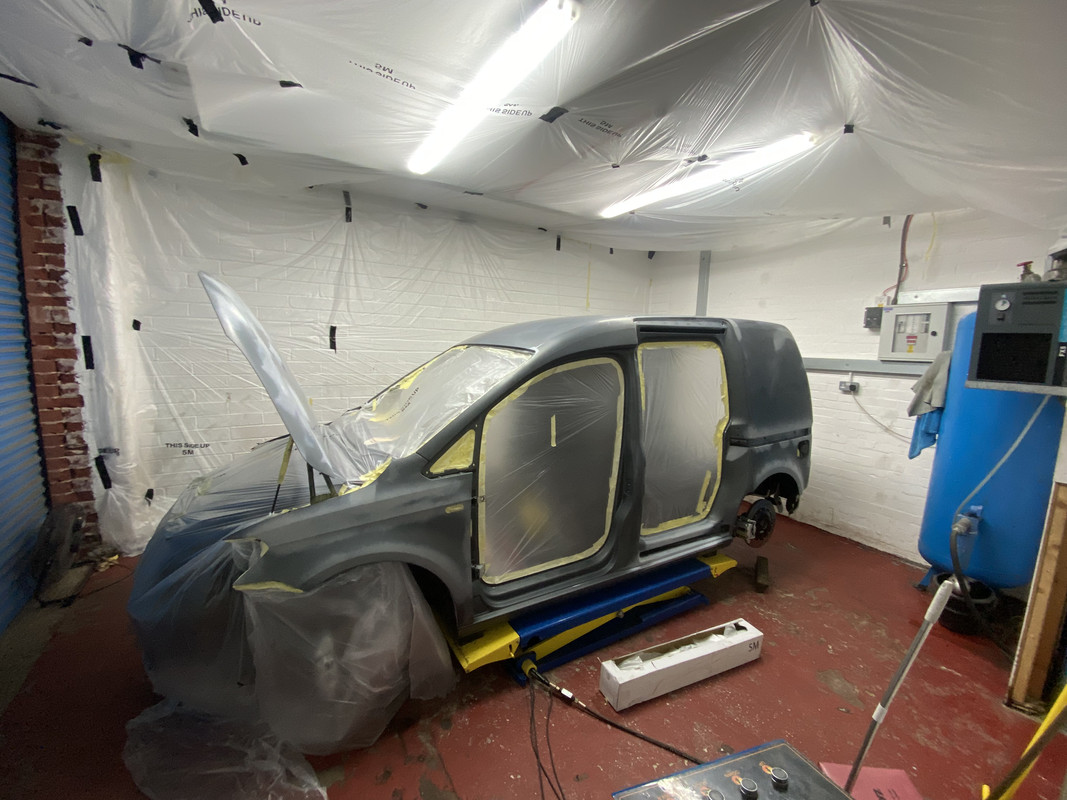

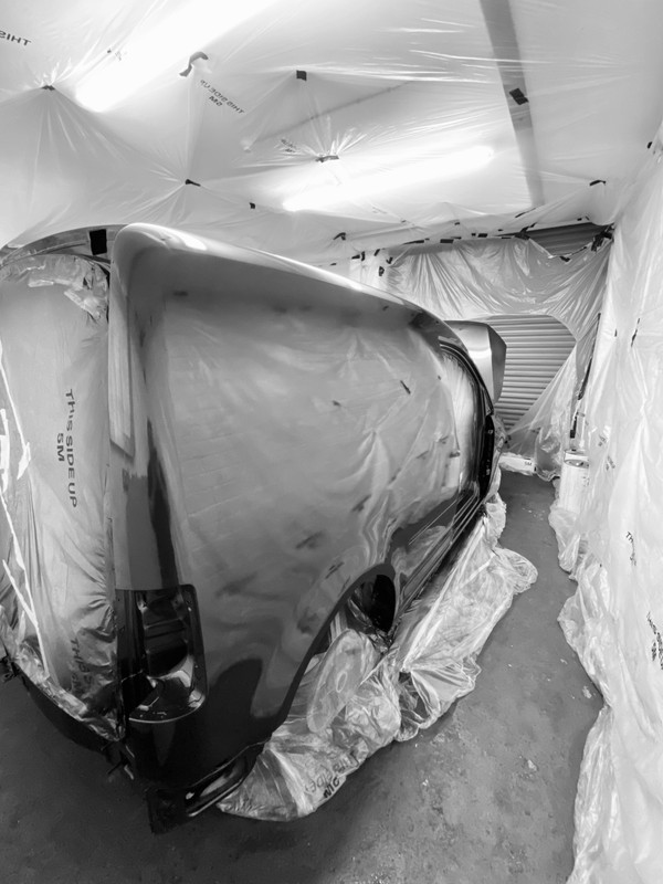

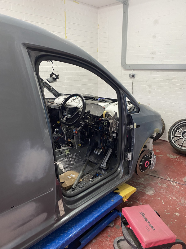

Was never happy with the grey…
Time for a strip down and make the place look like a crime scene…
Almost ready for paint - last of the polymask to on on the walls… and last part of masking off the caddy:
- ToiletTFSI
- Posts: 650
Re: Toilet TFSI - Caddy4
Quite pleased with the outcome… first time painting a vehicle…

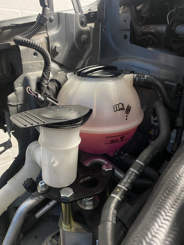

Washer bottle level sensor
