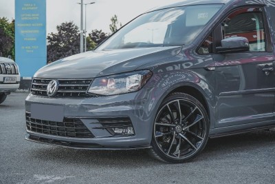

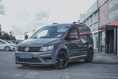

Some pictures of the van on the Eibach Pro-Kit.
Tagllana1
Posts: 45
Joined: Sun Apr 14, 2019 10:43 pm
Location: North Wales
Post by Tagllana1 » Thu Sep 24, 2020 10:55 am

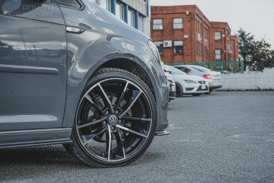

That looks the business!!! Are those wheels 18s or 19s?
Posts: 199
Post by FishermansFriend » Thu Sep 24, 2020 6:54 pm
Hi Tagllana, they are 19".

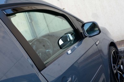

I gave the rubber window seals, trim and mirrors a rub over with touch of Solution Finish after seeing it recommended on here, really took them up nice.

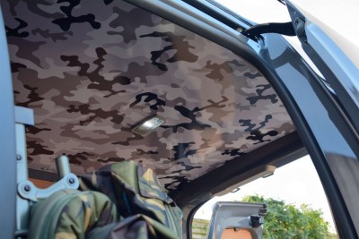

Installed urban camo vinyl wrap on the load area roof lining today.

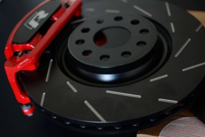

Got the 340mm EBC USR slotted front brake discs and 272mm rears delivered today.

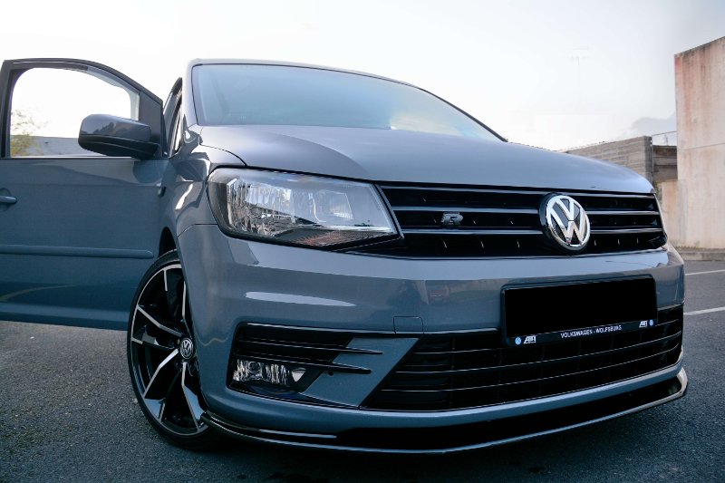

To R, or not to R, that is the question. I finally installed the gloss black R emblem I had in my to do box today. It came mounted on a L-Bracket with a small hole, so I drilled a hole in the grill and screwed it on with a nut and bolt, it also had some 3M tape on the bottom so its nice and secure. I have a black gloss R for the rear I will install later when I remove the gloss black Caddy wording.
