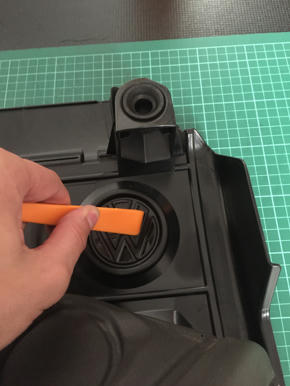

A little tip / hack for Caddy 4 owners in need of an engine cover... you can of course buy a brand new one, I did this...

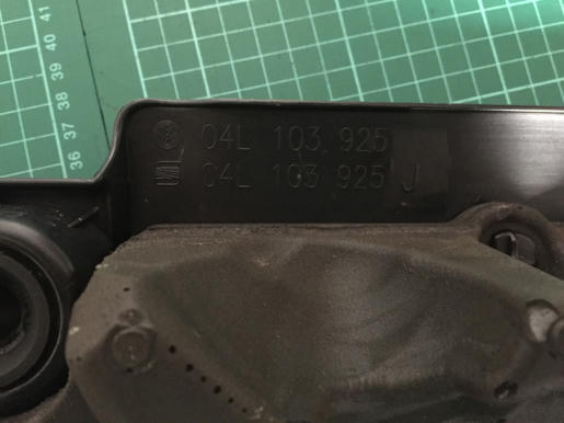

Bought a Seat engine cover with same pn variant

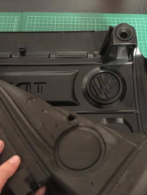

Flipped it over and gently removed the foam away from a couple of tabs
Hello... whats this?
Pushed out the Seat badge with a blunt object (in between the vw logo)...
Voila... oem without the cost, ok so there is no silver paint on the TDI and VW logo... I can live with that considering what i paid for it :)
Part numbers if you need them
PLEASE NOTE - This does NOT work for the Skoda version (the skoda badge is moulded like the vw version!)

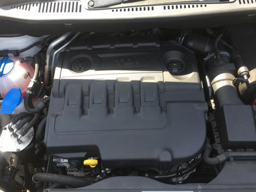

Mine arrived today! Fits great. Thanks for the heads up ImageImage

tonyhill wrote: Fri Jul 28, 2017 4:58 pm Any pic of this fitted yet? so is the VW badge lurking underneath the Seat badge??
Hi mate, this is the Seat version (badge removed)
