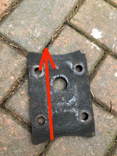

I’ll get a photo up I think I may have put the middle plate ( one with location hole in) the wrong way round forcing the axle forward I’ll post a picture up at the weekend when I have another look

looks like it....is the hole offset in that kit?
Its an easy mistake to make, when your lying on the floor underneath it, looking upwards!

Aye mate it’s an offset hole... surely it’s gotta be the reason like I say I’ll have a look tommorow and post up when I get it sorted

yeah, I reckon....slacken and spin the plate 180°

Can anyone tell where I’ve gone wrong please feel free to tell me I’m
A moron if it’s something simple
Posts: 18480
Re: My caddy
Looks like you've fitted the plates the wrong way around, from what I can gain from the photo of the plate in situ.

They should be installed this way round, arrow pointing towards the front.

Yeah I got it sorted cheers for the help daft mistake but an easy fix... got the van lowered a bit more aswell while I was on Image
