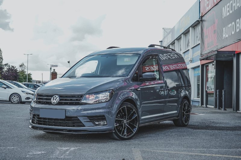

That looks the business!!!
Are those wheels 18s or 19s?
Are those wheels 18s or 19s?Sent from my iPhone using Tapatalk
- Posts: 1034
- Location: Ireland Dublin
Hi Tagllana, they are 19".
