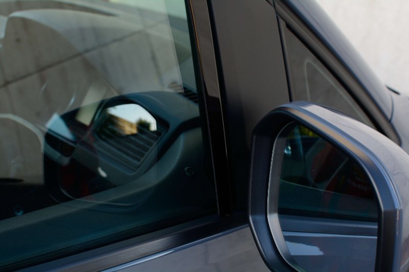

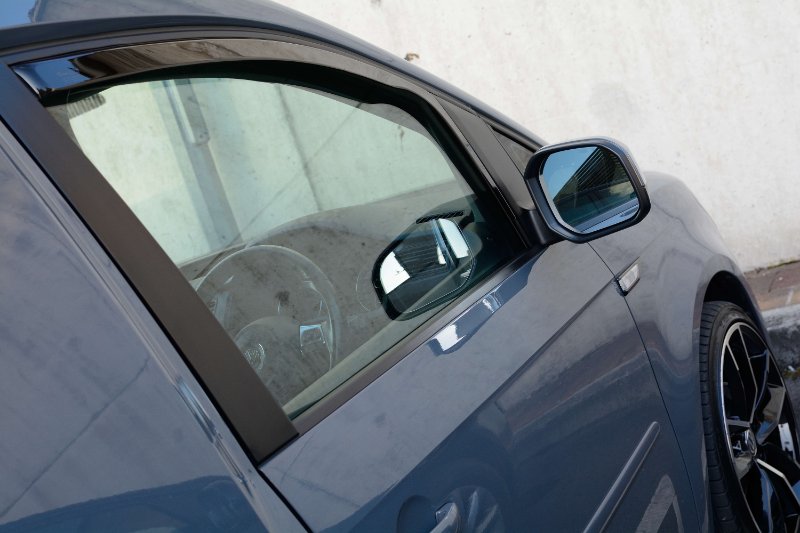

I gave the rubber window seals, trim and mirrors a rub over with touch of Solution Finish after seeing it recommended on here, really took them up nice.
