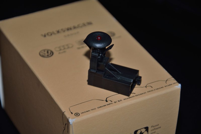

I installed a VW Sleeve Warning Lamp 1K0919238A in the drivers doorcard to replace the bulb the alarm installer installed. Much more neater looking now.

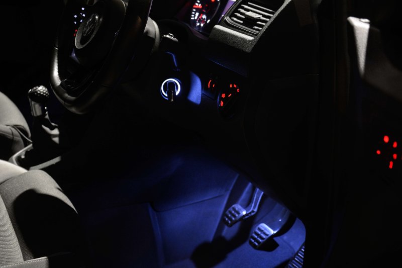

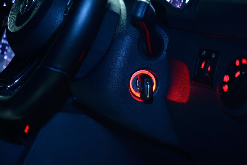

Multi color ignition key bezel light ring installed now with stan-the-man loom. Stan is a genius, thanks to his loom it turms ice white when i unlock/ open the door and red when I turn on the ignition. Really missed this feature, just need the Caddy2K keyring now.
