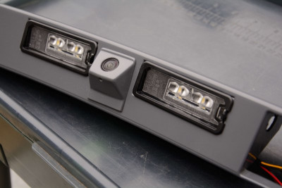

New set of VW 1K8943021D license plate LED's with water tight plugs/ seals to replace the ones I got of amazon. These one also click into the existing openings on the door handle once you remove the halogen housing. I had to drill a 12mm hole in the back of the door handle plastic support to allow the plug to fit and trim a plastic tab or two. I trimmed a hair of plastic off the door handle opening where the LED units click in, the LED units click in solid then.
