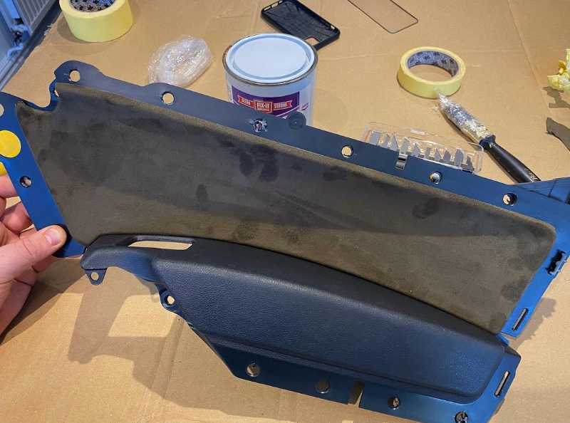

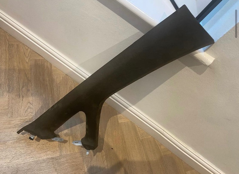

Made a little start on trimming some interior bits.
Still planning out what to do with it at the moment…

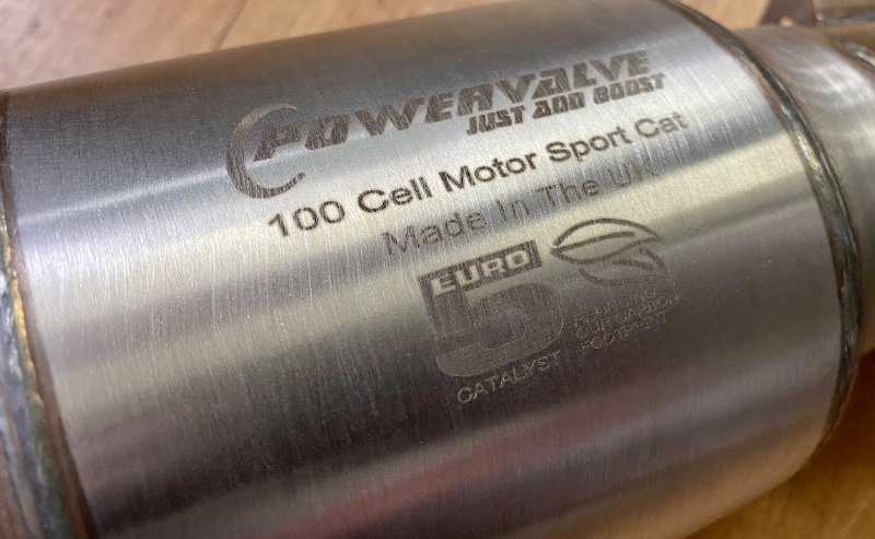

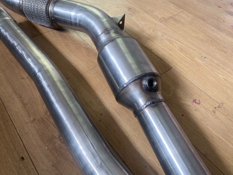

Powervalve 3" down pipe with 100cel cat arrived today ahead of fitting the engine
