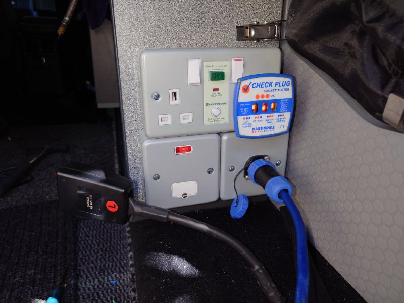

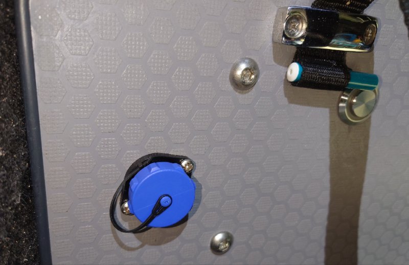

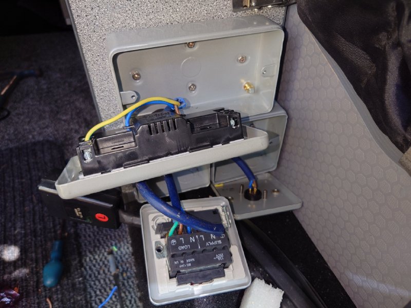

Added a Mains Hook-up
:D
Posts: 2310

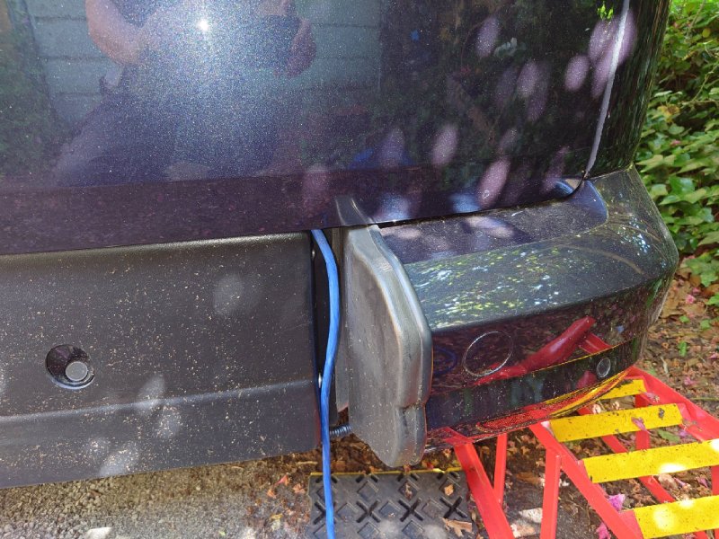

As mine is a WAV conversion I have a handy entry route through a rubber edge strip.

@petrev, a nice tidy safe socket setup you have done there buddy
Posts: 2310

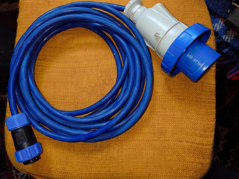

Thanks.
Wanted something less bulky compared to C-Form CEE 16A std. blue plug.
Found the Weipu SP21 range - 3 pin rated at 30A and IP 68, so perfect.

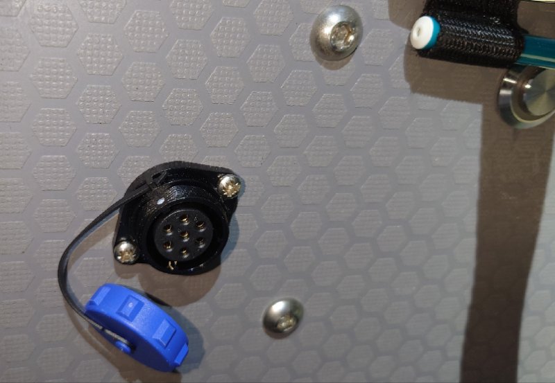

Hmm ?
What's that socket for ? (left hand side rear quarter panel)
Fitted a 7 way relay and a mini 7-pin trailer lighting socket.
Weipu SP21 - 7 pin this time.
