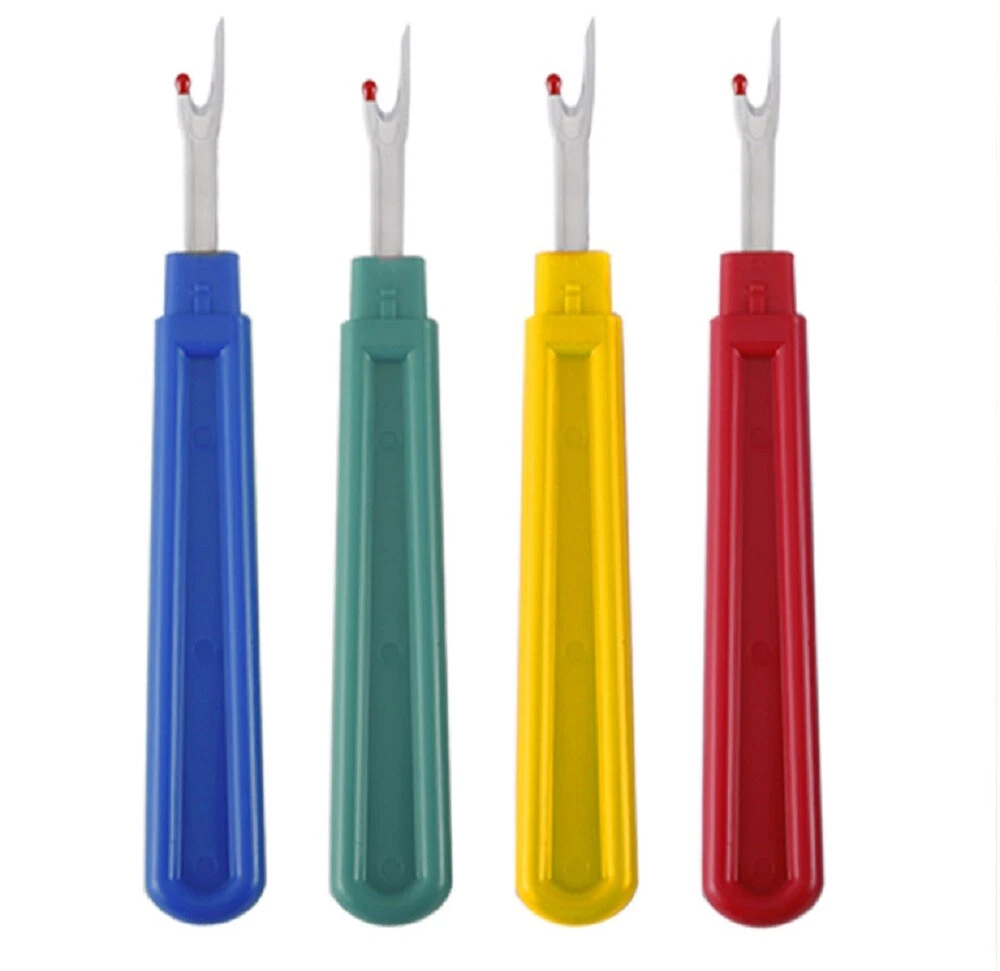

do you you have the unpick tools?
- C Chis
- Posts: 1653
Re: Damo caddy build
Awesome! I love a good wiring harness!

@ToiletTFSI yea have a set from amazon seem to be doing the job so far...
