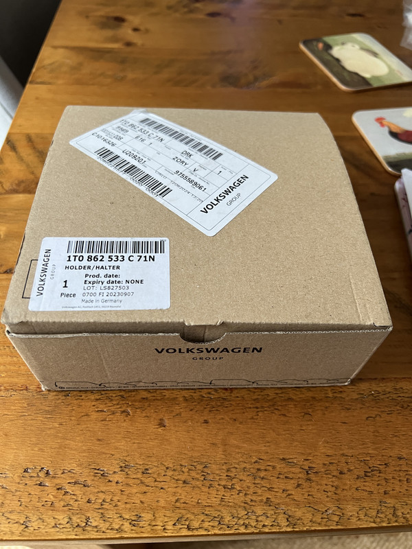

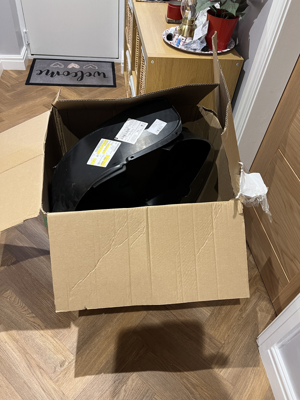

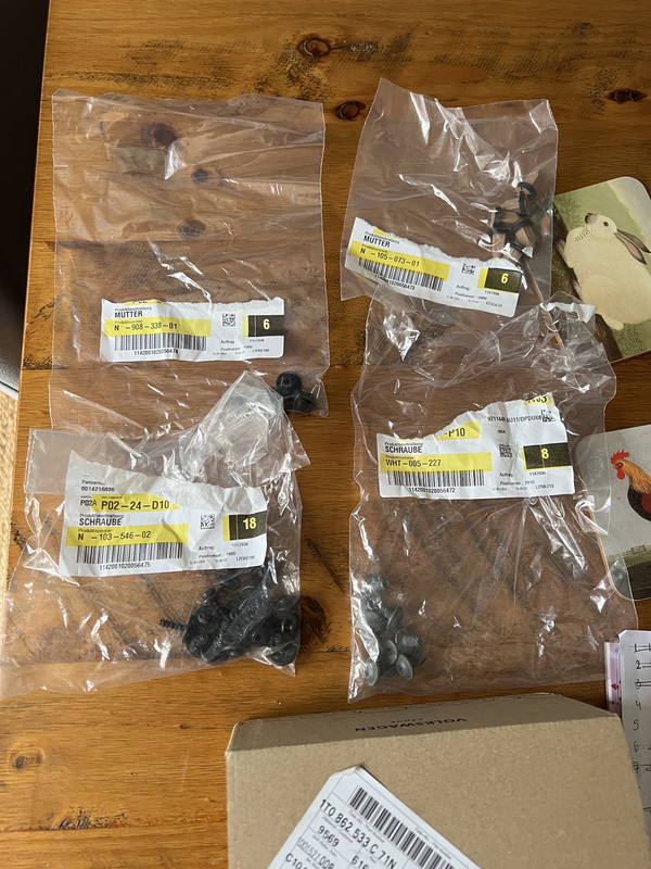

My LLLParts order finally arrived, while I was ordering the arch liners I thought I would order all brand new fixings and also a replacement fold down cup holder for the Touran centre arm rest as this was damaged when I got it.
However since this order arrived apart from the cup holder I have not had opportunity to fit them. When I do get round to it I will set the final ride height for both front and rear as the front Bilsteins are just set on the height they were when they arrived!

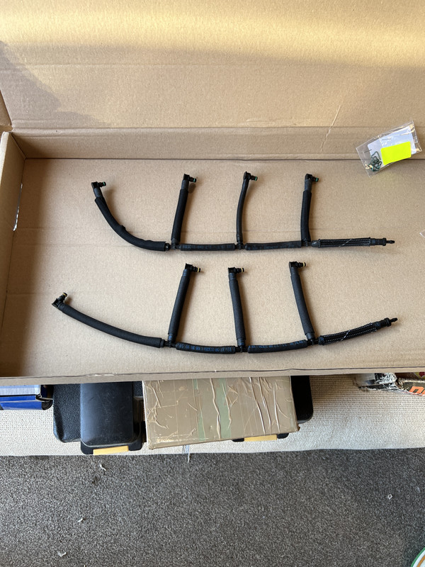

A quick look on here and I suspected the diesel injector return line was leaking, so rather than wait for an LLLParts order I thought for some small o-rings I'd just go to my local VW dealership. All I can say is ouch
£18 later I walked away with 4 tiny green o-rings. Had a look at it and didn't seem much of a job so set about stripping it down. Carefully took out the spring clips, took off the old o-rings at which point I noticed on cylinder 3 that the rubber pipe and fitting which goes into the injector were different like they had been changed for non-genuine parts previously. Anyway I pushed on, getting apart was dead easy putting back together was certainly not. Those spring clips are a swine. I managed to get it all back together feeling dead proud of myself. I go the gaffer to start the engine for me only to find that 3 out of 4 pipes hadn't gone in right and filled the top of the engine with diesel
I had a number of goes at trying to rectify and decided that the fittings didn't seem to want to go back into the injectors properly or maybe the spring clips were buggered. What finished me off was losing one of the spring clips, it bounced off for the final time and was never to be seen again. So I decided the best course of action was to place order number 5 will LLLParts and order a new fuel return line, this is a new design and also comes with different size orange o-rings. I also ordered some new spring clips, a new bonnet strut as mine was mega rusty and a new bulkhead sound absorber/insulation.
New verses old
I'm happy to say after getting the new genuine fuel return line of new design it all went back together really easily with no issues. Especially after the lessons I learnt from before, I laid some old towels over the front and rear areas of the engine to ensure I didn't lose any spring clips. But I also order two extra ones just in case!! I am also happy to say it is now all leak free

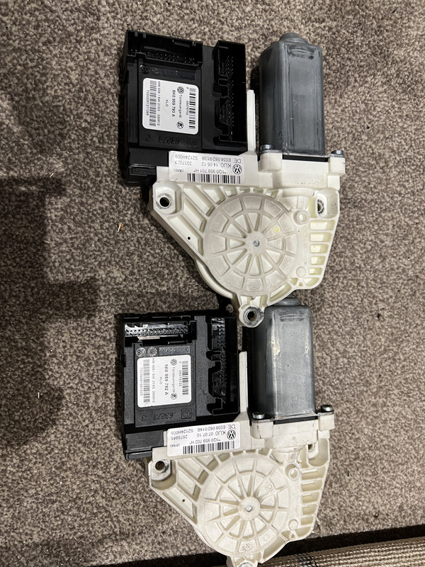

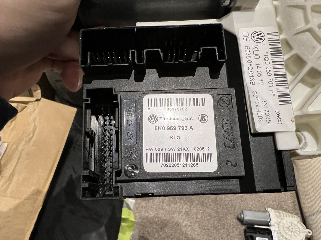

I've also been buying more bits for future plans, so I have a set of 2019 Jetta stalks and a set of Caddy stalks so I can follow @Giddy's brilliant guide for Hybrid stalks. This is all in preparation of me purchasing and installing a MFSW, my preference is a Mk7 style as I loved the one in my AW Polo GTI
I also bought some Sirocco door modules in preparation of installing folding Caddy life mirrors, so again following the excellent guidance on here I have got the 5K0959792A & 5K0959793A door modules which I intend to get refreshed in the Caddy image so they are ready and waiting for when I get some Caddy life mirrors
So I can see a trip to Bellman Auto Electronic Services in Sheffield which is just down the road to get these sorted and finally get the coding done for the mk4 lights
