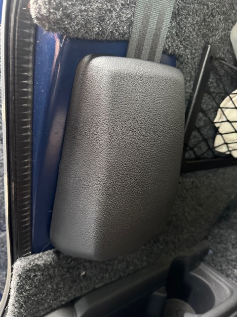

Looking good
They seem a different design to the usual Vanstyle arch covers ?

These are the VW original parts from the VW Nutzfahrzeuge catalog.
viewtopic.php?t=56970#p467198

Ah !
Thanks
Very smart

Hi mate
sorry was waiting on invoice for part numbers
i got them from TPS
now i have twin sliding doors on mine so the parts i ordered were
2K0867263D71N
2K0867264D71N
(these are the caps left and right)
and then
2K0867300B these are the fixing clips and you need 8
(4 each side)
total cost from TPS approx (i have a trade account through work) £26+ VAT so like £31.20 all in and next day delivery
If you have non sliding door I think the code at end is E71N
Hope this helps
