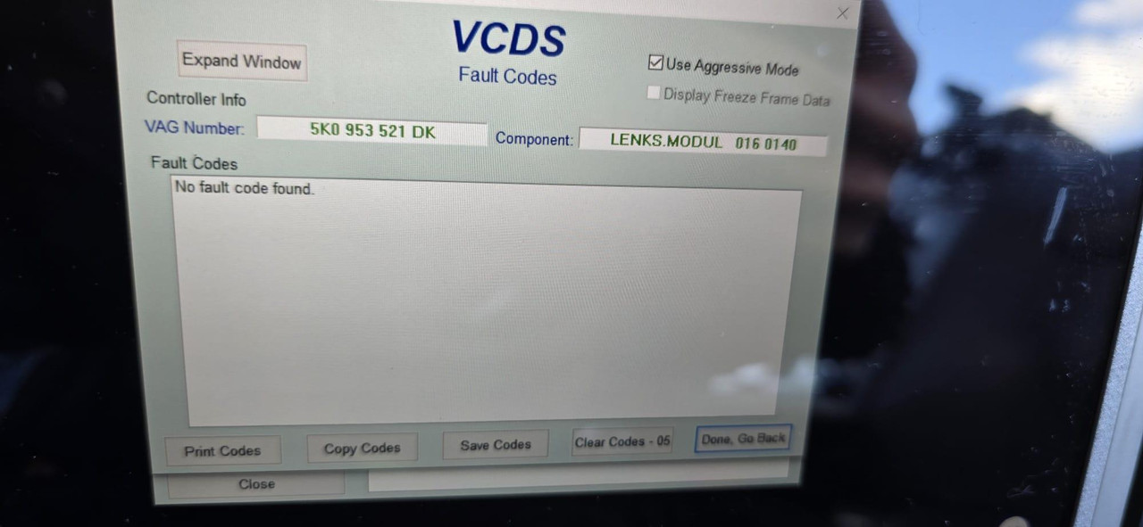

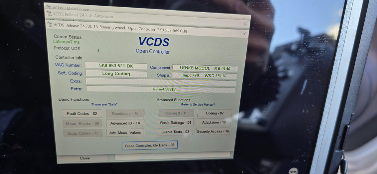

So Car Sparks has given me the pictures as below:
Now I'm not 100% sure on this as a google search gives me a return for Indicator stalks and i was sure i was after a squib ring.
any ideas?
any ideas?
- Doc
- Not God, just a bellend
- Posts: 18787
Re: White Caddy, actual work Van!
You need to click on the [Advanced ID] to get the actual SWCM part number, the number for the complete stalk set will work but you won't need the complete stalks and SWCM.
I'd bet on it being a 5K0-953-569 SWCM due to your caddy being 2014 without MFSW.

So i haven't had much chance to revisit this until today.
I phoned up VW and tried to get a 5K0 953 521 DK and it doesn't exist. they were somewhat vague about it which didn't fill me with confidence.
So asked about the 5K0-953-569 as per Doc's suggestion and they have that part but as 5K0-953-569 AF
Now i'm assuming this is correct and its maybe a replacement part? I think the van I have is maybe an example of 'end of an era, facelift model about to be released, use any part out of the parts bin'
So I've texted car sparks guy to confirm as its a £409 part and its 'special order' whatever that entails and can't be returned.
- Posts: 56
- Joined: Sat Oct 12, 2024 10:34 am
OK so just ordered the part 5K0-953-569 AL...
It seems the AF Part has been superseded.
Hopefully that is now correct, especially as its a £409 nonreturnable part.

Mr Car Sparks has been and gone.
the new squib ring has been coded and fitted and now the steering wheel sensor(?) has been sorted so now i have no error codes.
Sadly this hasn't actually fixed anything else. i am led to believe the Body Control Module is at fault.
Now at least i can buy a second hand one of these so it shouldn't cost me too much to sort (they're about £50 on ebay)
The labour for the fitting cost me £220 so I'm expecting that again plus the part.
Thansk to @doc for the info on the squib ring, his info was spot on and i at least haven't wasted £409.
