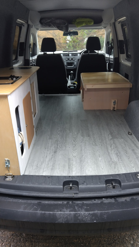

Wooden beam cut to separate the two bed sections, and first section built up fully.
Shown in van as a single unit. This part of the bed holds the fridge and portable toilet. If I am using the van to take a bike this set-up gives me a bench and a bit more room to move about.

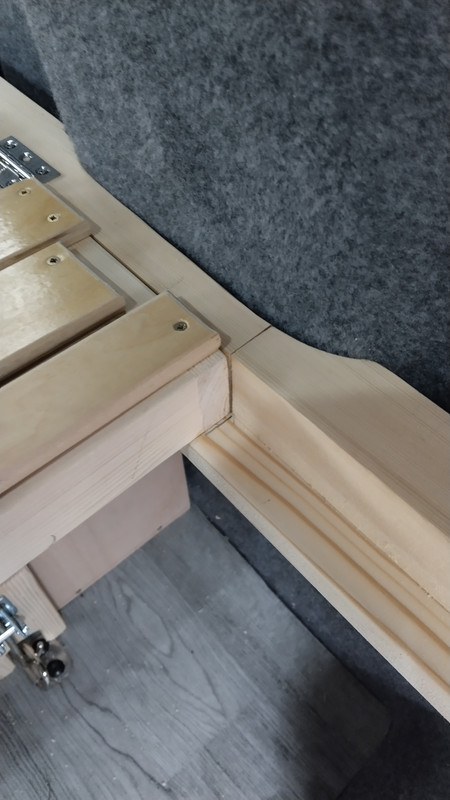

This shows the cut in the beam.

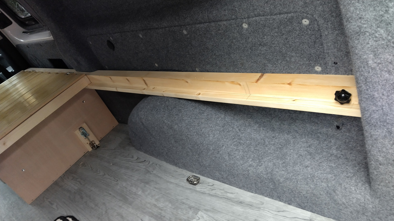

Beam in place. The beam is made from a 44mm sq and 18mm x 69mm pieces of pine. I cut those staggered so that the beam is held down and in place. With the other section fitted it's held firmly in place.
A few more tweeks and the whole bed will be firmly fixed to the van and removable without use of any tools.

Btw, how have u fixed things like this to the van itself ?
PJD
Posts: 446
Re: Micro Camper Daily Driver Build
Post by PJD »
stu_b wrote: Sat Feb 22, 2025 9:12 pm Looking really really good
You must have some nice tools to work with to create such high quality
The grey studs are the standard VW ones that hold the removable panels, all I have done is carpeted them.
The black thing is Just one of those standard vehicle usb sockets.
The beam of wood is held on in the way I described previously with a rivnut fixed to a large washer, but this time fixed onto a piece of wood that sits behind the square opening, where the jack normally is located. The small black screws hold it in place with a piece of wood In front.
