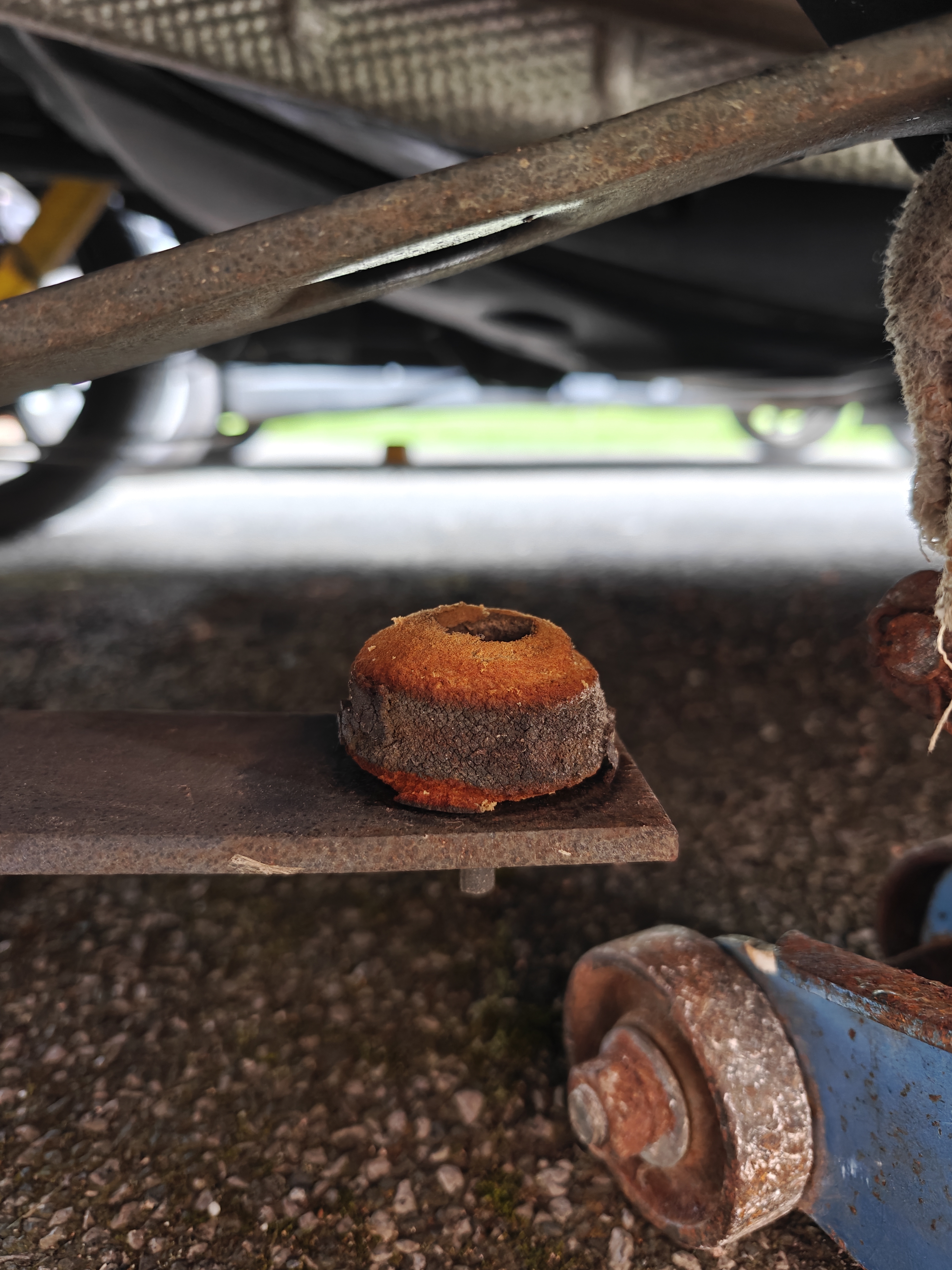

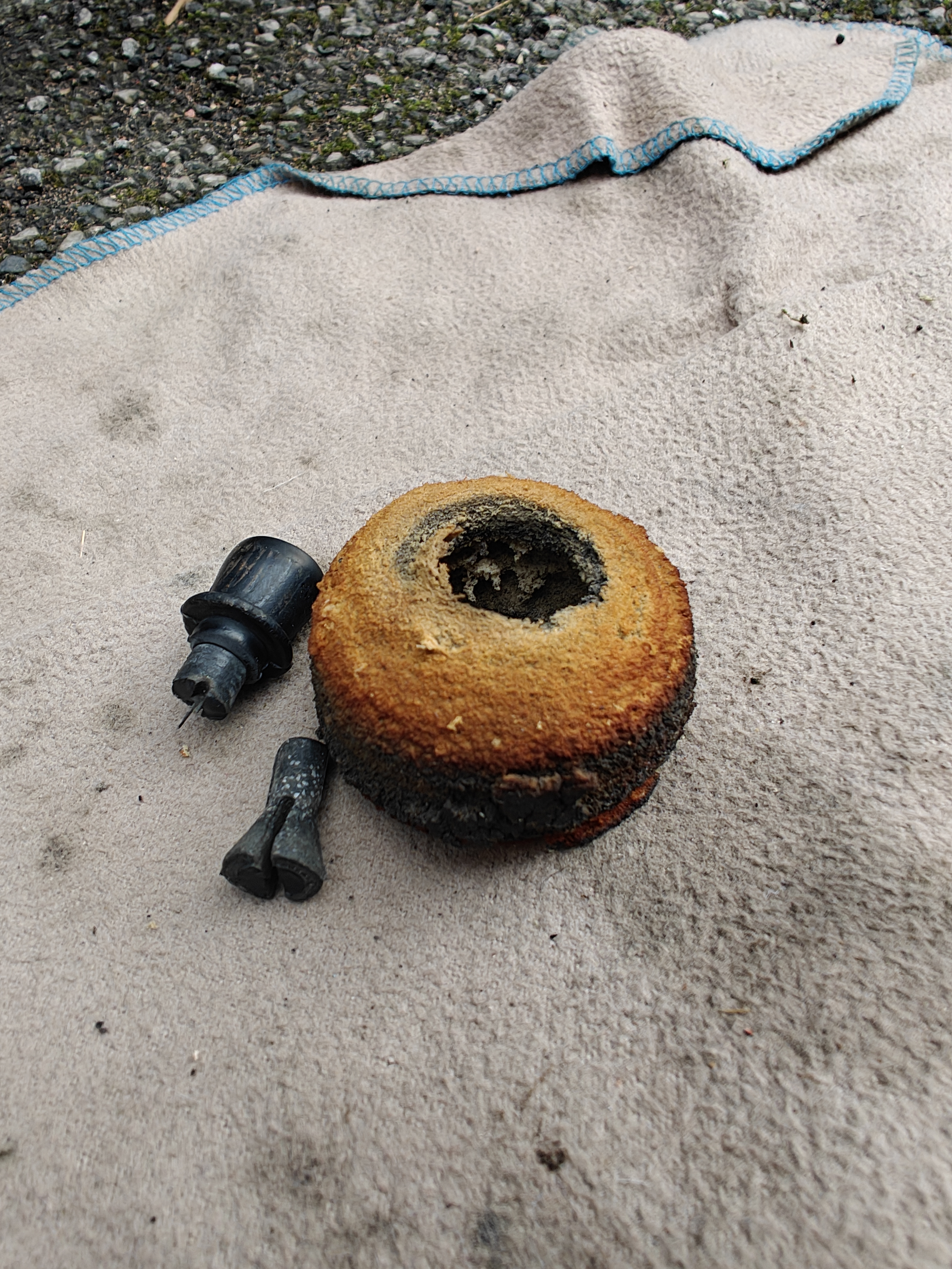

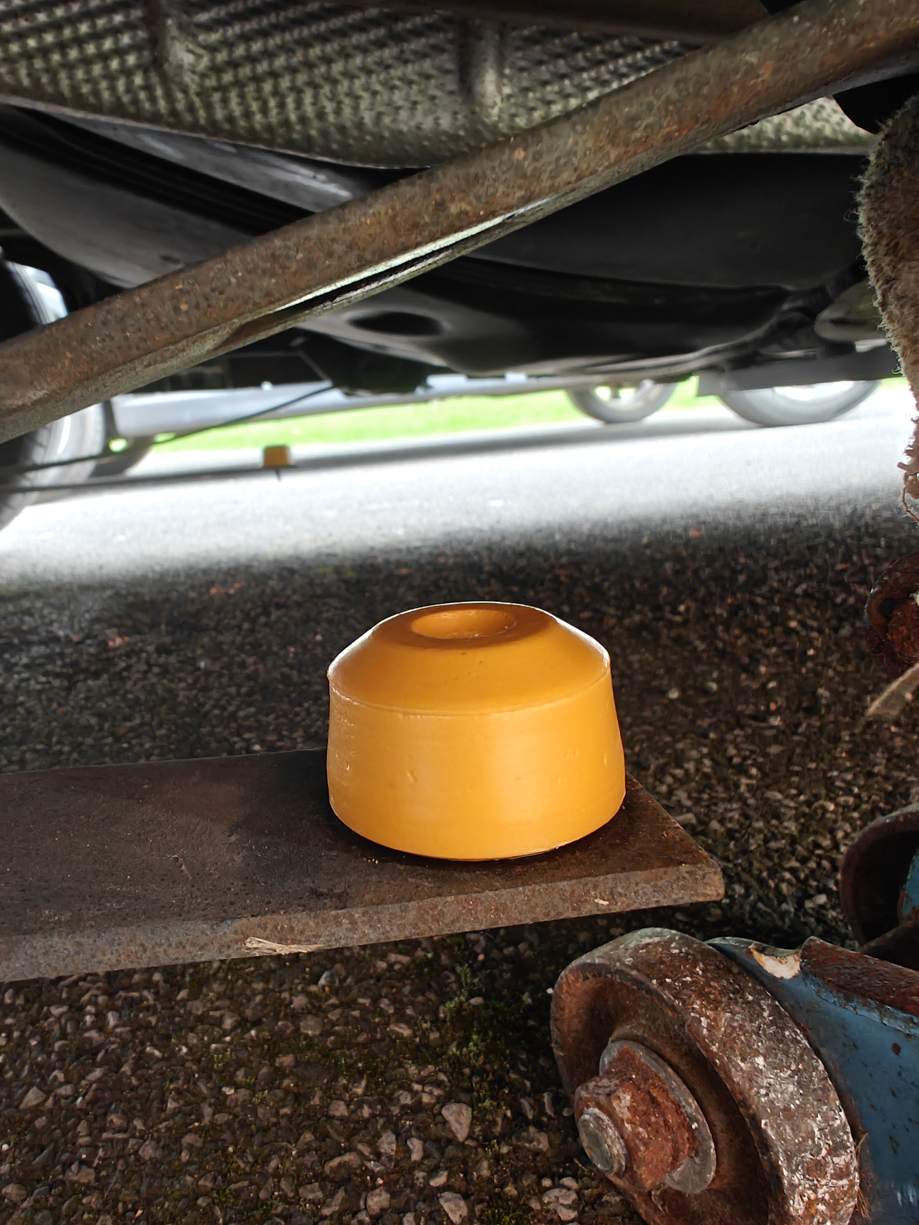

Post by juliang71 »
A simple job that I've been meaning to sort for months now. The leaf spring bump stops were literally falling apart, no idea how much VW charge for these so just bought a pack of 4 from eBay for £10.88 delivered. Fitted this AM, best to use a bit of washing up liquid to help them on. Pliers underneath to pull it down as you need to get the rubber lug through the hole in the leaf spring.
