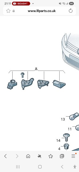

Both my headlight adjusters have been stripped so cant align them vw sell the for a crazy 45£ each side for couple of tiny bits of plastic any alternative to this thanks

Are these the adjuster? There like a big nut screw it my headlights have actually stripped were they thread in

The big nut type things on top are for adjusting the actual headlight to get the best fit with the bumper and grill. They dont adjust the actual aim of the headlight beam. The beam adjusters are at the back of the headlight near the inner wing and are a white plastic allen bolt shape. There are 2 on each headlight. One for sideways movement and one for up and down movement. Hope this helps.
