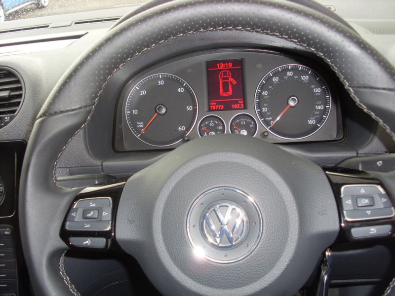

do all the buttons work with that steering wheel matey?

I have the mf steering control module off a Mk6 Golf GTI & MK6 cruise control stalk to be fitted on Monday. I am assured that these, along with the latest version of vag com to activate will work all of the buttons, you have to have a mk6 stalk for cruise to work with Mk6 control module. If its not the latest version of vag com, I think you only have 90% of the buttons working. You also have to have a slip ring version c or above for it to work. Believe me, I have not a clue about anything like this but have found all this information on one of the Mk5 forums and ordered all the parts so I hope it works. Keep you up to speed next week!

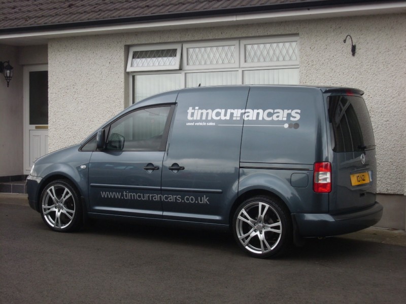

Thanks for the comments Matt. The spoiler is a two piece sportline bonded together and filled. Just noticed a couple of days ago the filler has split all the way round. Thought the bond (Black type I use for fitting rear spoilers and side mouldings etc.) would have been good enough. Maybe you would have a better solution.

hmmmmm let me know if it works cuz i have heard many things and they all say none of the mk6 stuff works on a mk5 platform.
thats why the steering wheels are so cheap.??? but u will need the beta 10.3 vag-com to play around with mk6 stuff like that. :P

I would suggest splitting in two an then drilling a few holes into both halves and bonding metal pegs into the holes as well as the mating surfaces and then grind a bit of the spoilers near the joint to allow for a skim of fibreglass.

ive one on my tailgate aswell, the fella bonded it together but i think he did somethin like you said matt bonded bits into both pieces and then joined it, hasnt cracked or anythin and i have it on a couple of months.
