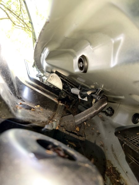

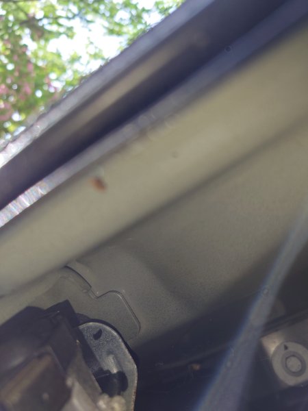

Picked up a puller from Screwfix (£9.99) and bingo ! Off they pop.
Now I can see the brackets (2) that have to be replicated to mount the twin opposed wipers from a Touran.
Fun 😊
Outer bracket/mount - Inner in the background.
Inner
Where the inner one has to fit ...
Goes around the rubber bush that replaces the blanking grommet ?!

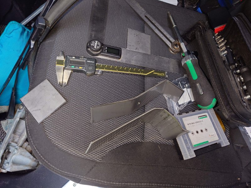

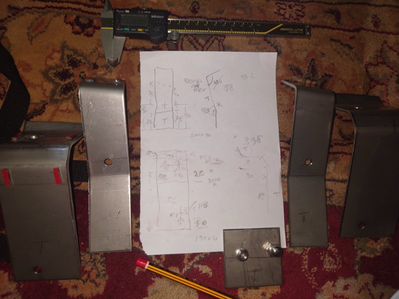

Bit of metal folding
