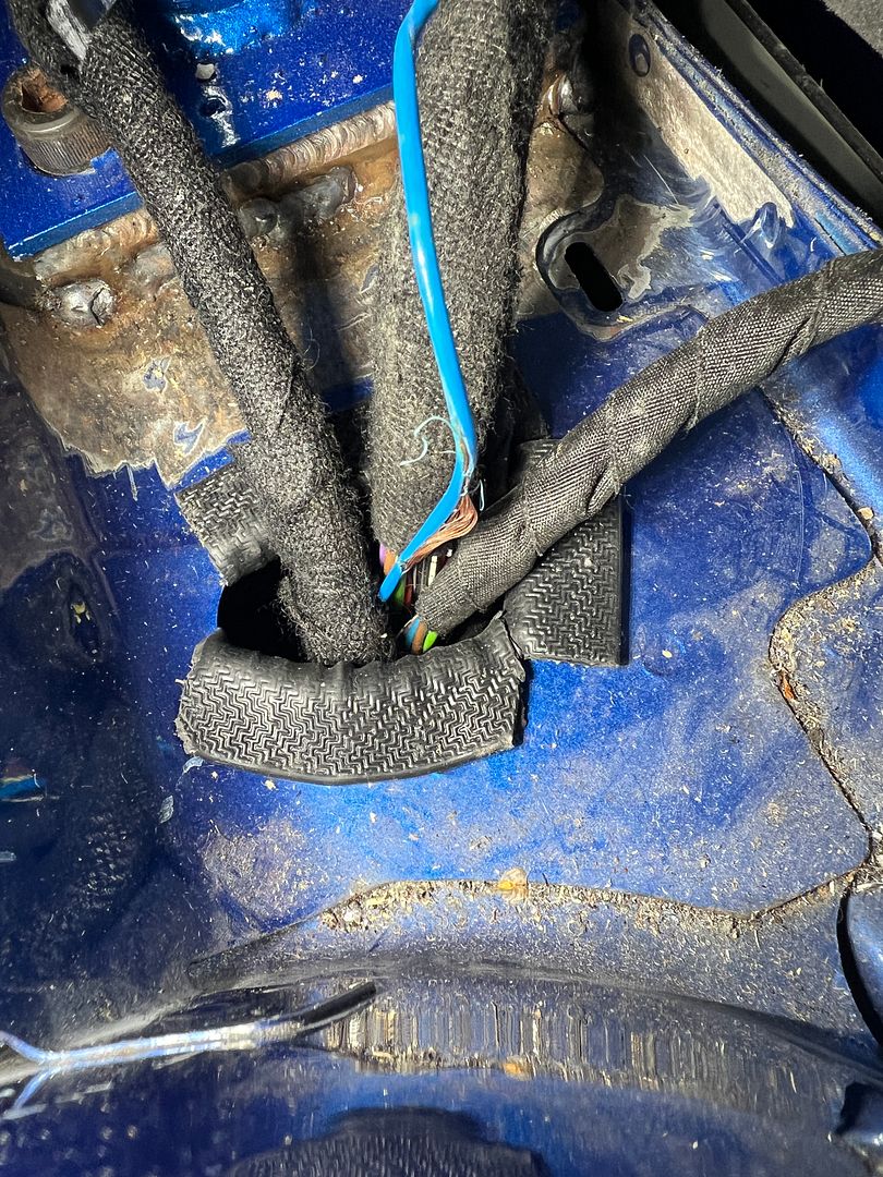

Well its been a while since I had anything to show but a recent fault developed in the air suspension wiring that meant it was not powering up and after all these years decided to finally sort out the rats nest under the passenger seat.
Full disclaimer, when the caddy was first put on air ride, intermotiv knew it was going off for a full interior build and so he fudged something together to get the single compressor running. This has then been bodged and messed about with going to other places and finally the setup was changed to a 2 compressor system. This therefore is not a fair representation of his work but I wanted to show the before and after.

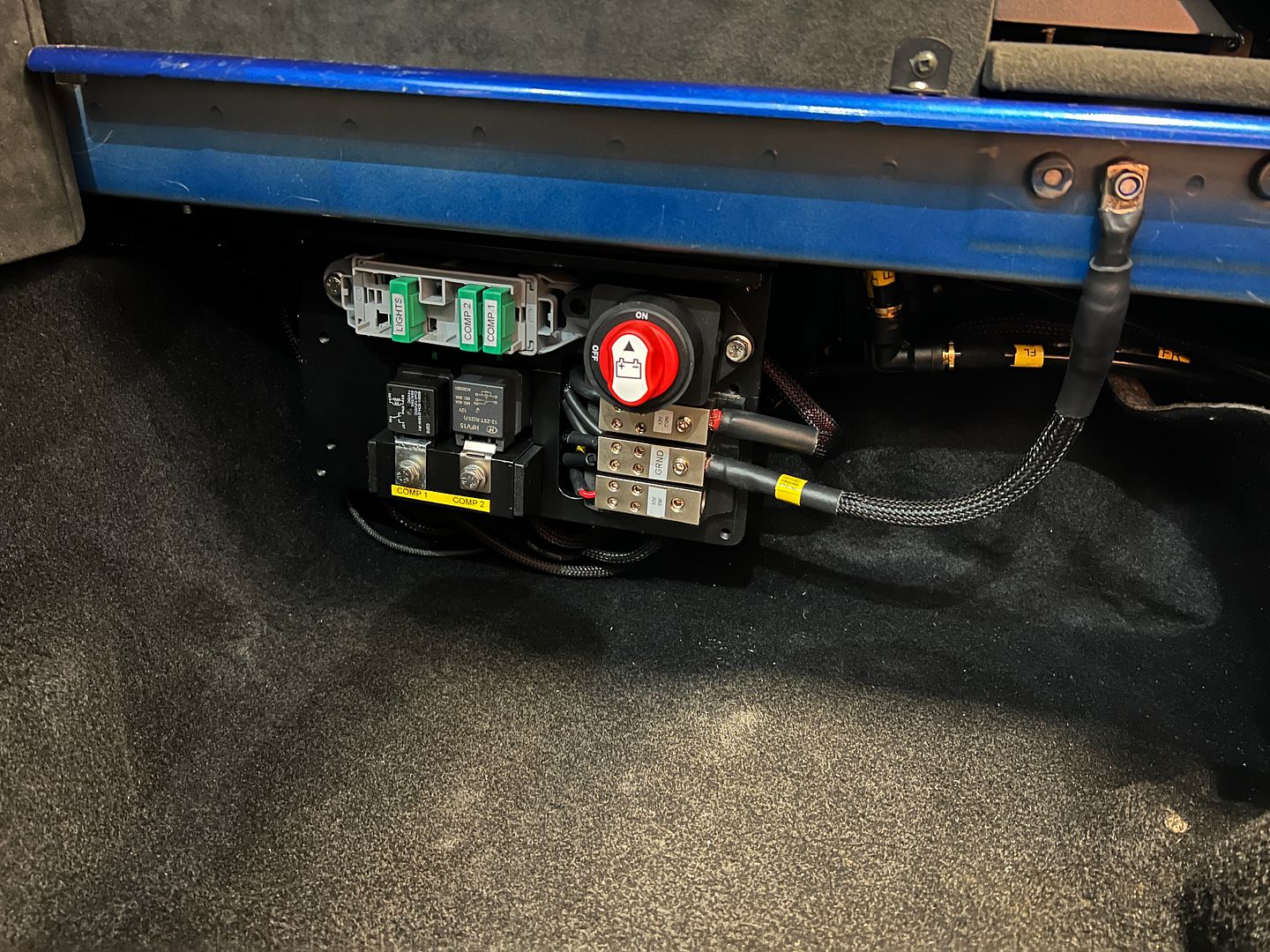

I realised that the 2nd compressor wiring was wrong and now I believe it was never running. I bought the air lift 2nd compressor loom and correctly spliced that in. I also added superseal plugs at either end of the compressor power and ground wires to make servicing and fault finding easier.
I then packaged everything up on a piece of aluminium angle that could be mounted under the floor behind the passenger seat.

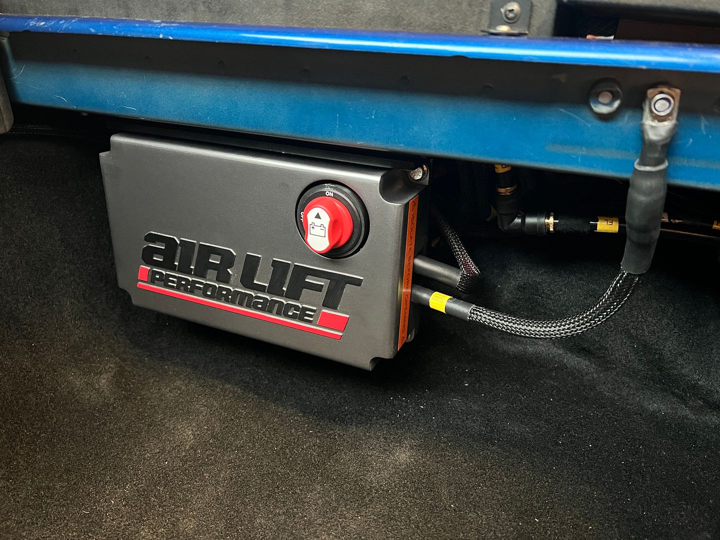

This is the final installation with a battery isolator switch to also make it easier to service/fault find. I also spent some time shortening all the air lines and labelling everything plus I added anti chafe sleeving that matches the air lift looms.
Changed the glass fuse in the engine bay to a proper vw style 80a midi fuse running off the main bus bar (on the far right) and swapped out the stereo install style power cable for oe style red.

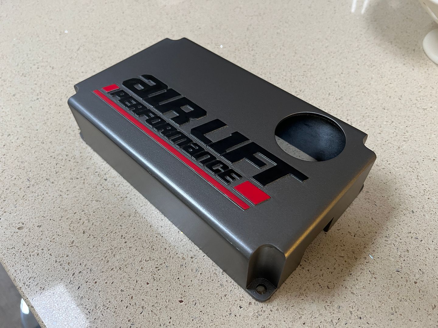

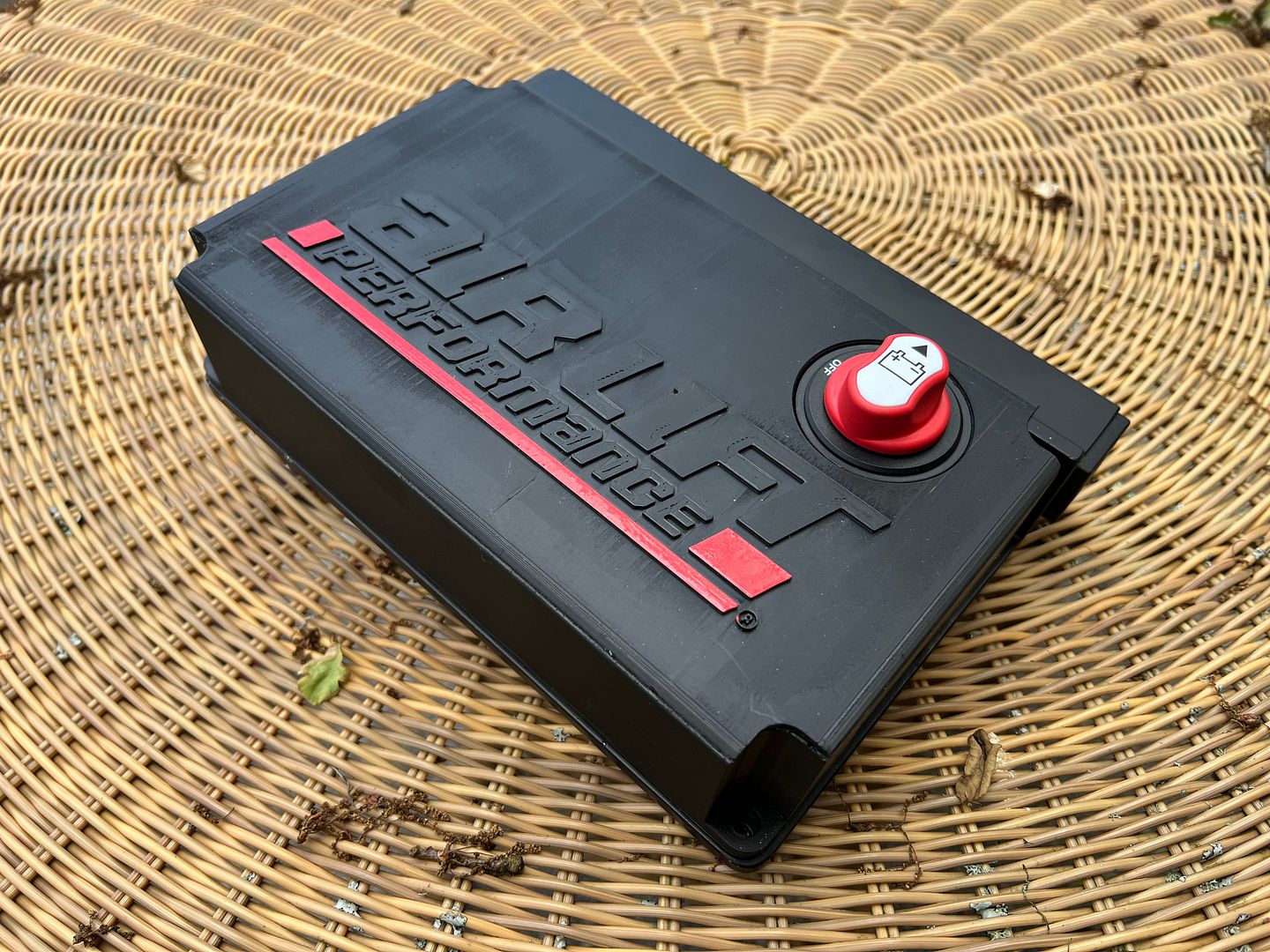

Designed a lid for the air ride fuse box on sketchup
and then 3d printed it (ended up printing the lid part separately to the base to save on support material and then glued the 2 parts togther)
Painted with a few coats of high build primer and a grey/bronze paint (and paint pens for the logo)
and then installed
