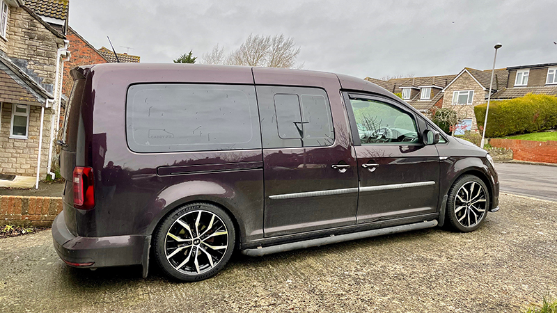

Been a while since anything has happened to my Caddy, hardly used it last year, working from home since March, and no bike trips or holidays. However MOT is due now after the 6 month extension from July 2020, and I've replaced all 4 tyres. The Brescia replica alloys were getting a bit tatty, couple of dinks and a bit of peeling lacquer, so decided on a change, now has Santiago replicas with new tyres.
Needs a seriously good clean. Next stuff to do is replace the side bars with side skirts currently on order from RK Designs, and is booked in at the beginning of February at my local car audio place for speaker upgrade & sub-install.
