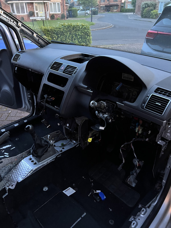

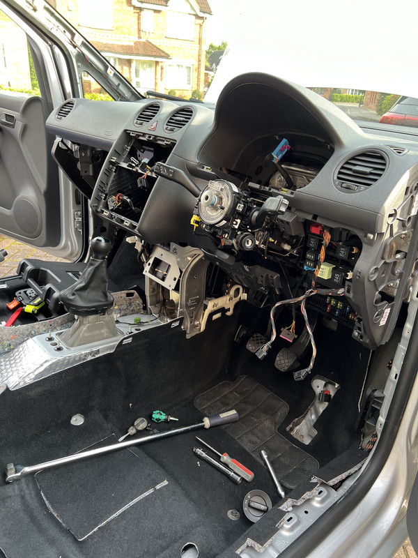

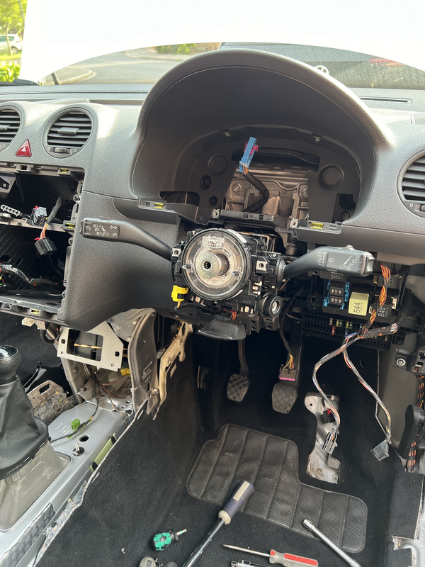

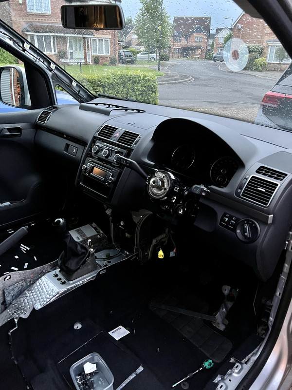

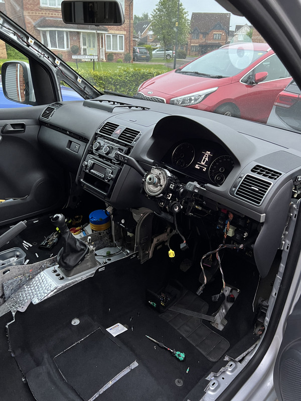

Well Sunday was wet day so spent the time cleaning the Touran dash, door cards and centre console. The centre console was disgusting

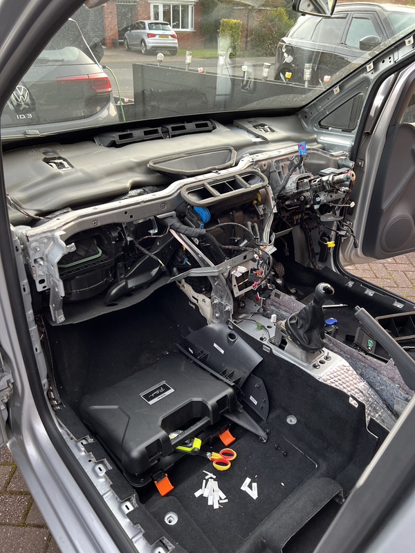

This evening I though I’d make a start on dash removal and get things ready for the Touran dash install
Dash out and Touran brackets, centre support and vent ducts installed
Dash just sat in for the minute as not happy with the foam on the vent ducts, plus I was running out of light
Another step forward

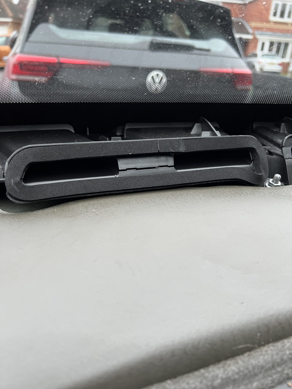

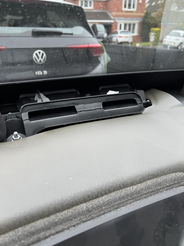

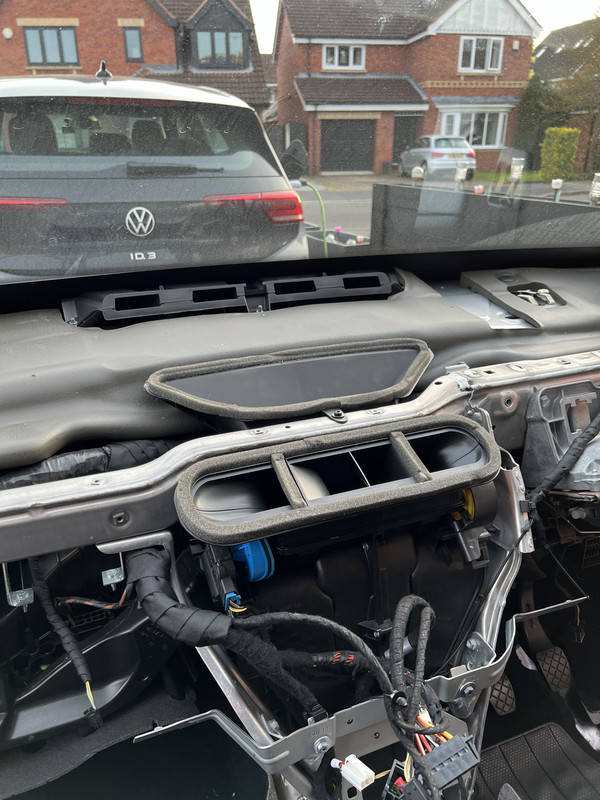

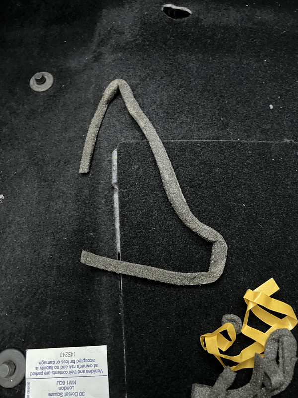

Did a bit more on the van this evening started by pulling the dash back out to sort out the screen vents ducts. I ordered some 10mm x 6mm window seal foam from Amazon. Unfortunately I didn't get a picture before, but the original foam had moved, was covering the openings and was starting to break up.
First one done
Next one cleaned ready for new foam seal to be fitted
Finished article, I added a little superglue on the edge before butting up the seal to make one solid piece. Although the eagle eyed will see my error on the first one!!
I then started to put the dash back in and build things up, however I started to lose light so had to call it a day

First one done

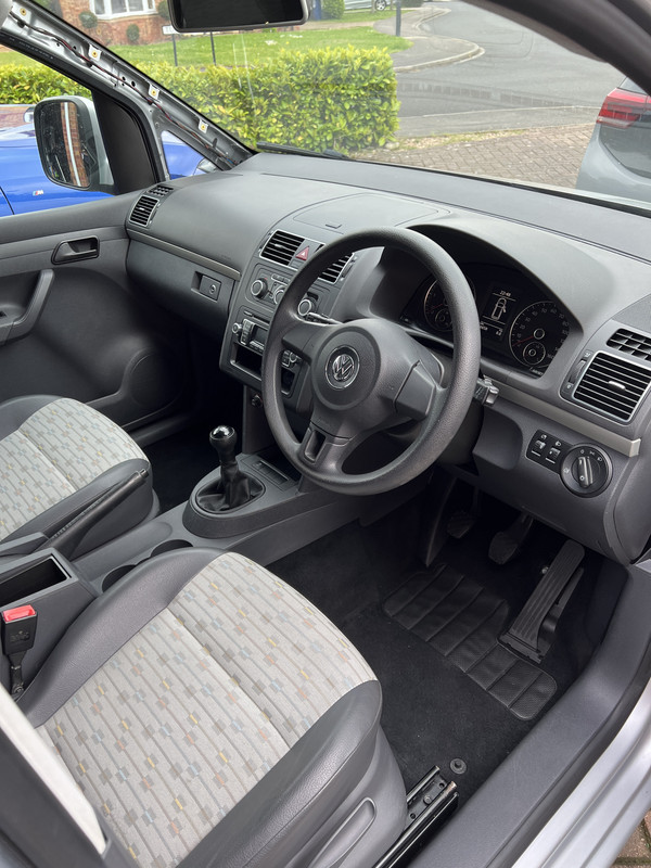

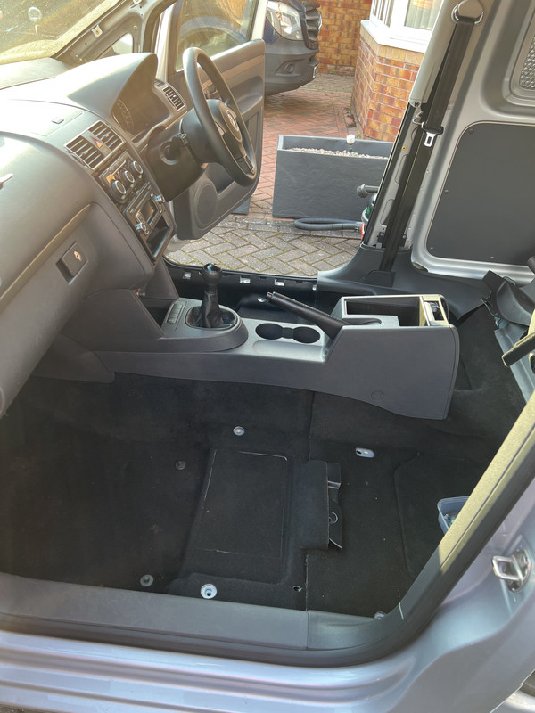

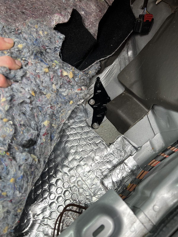

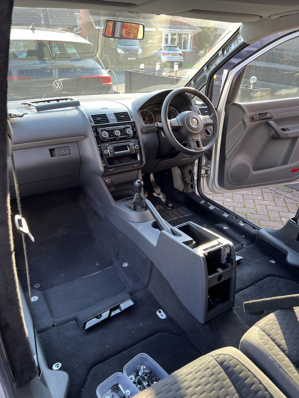

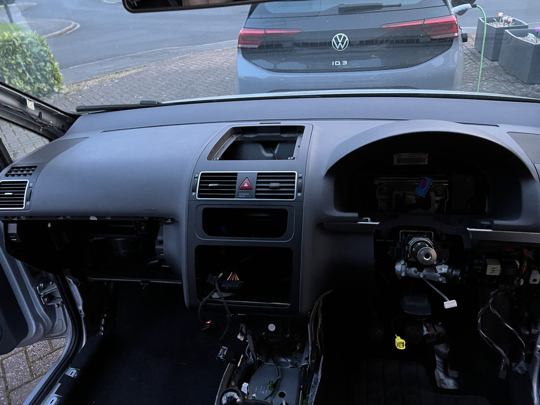

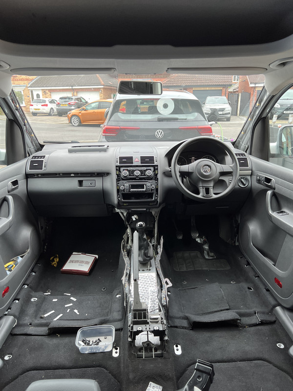

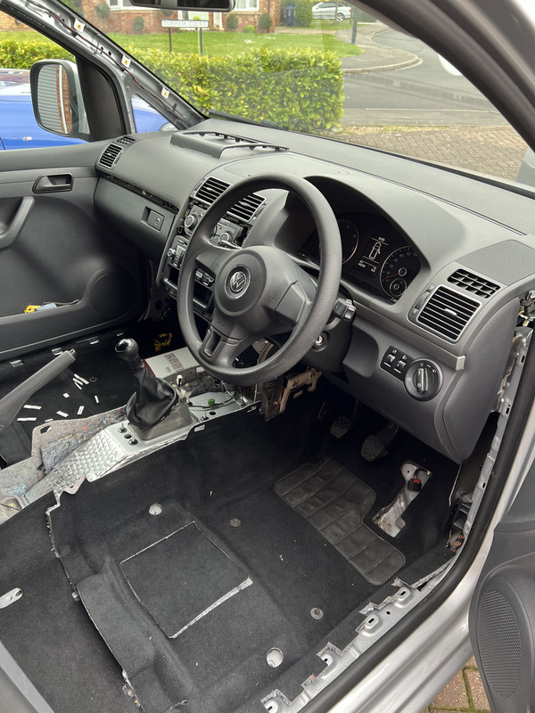

Had a good day on the van today, managed to get the dash install finished off

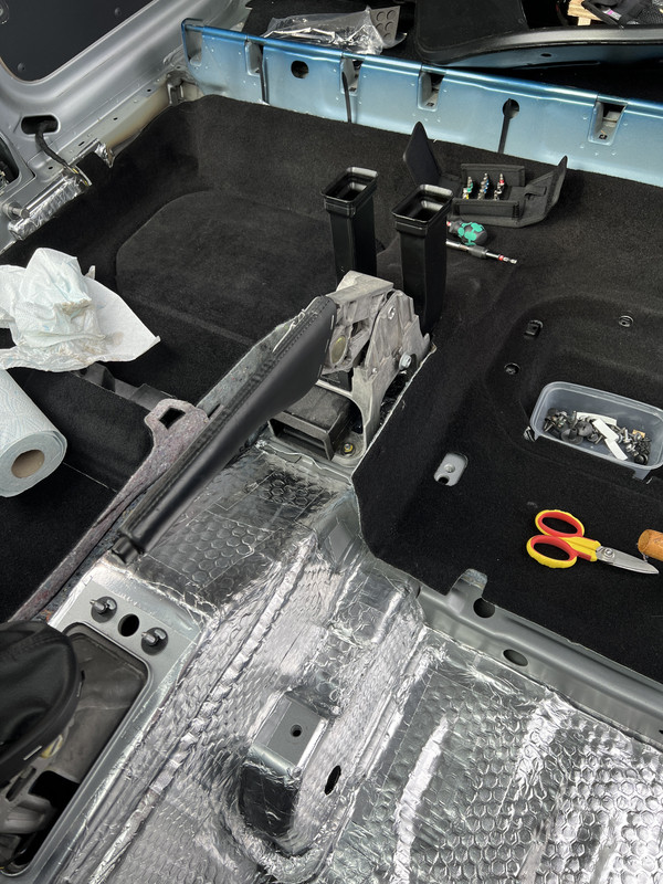

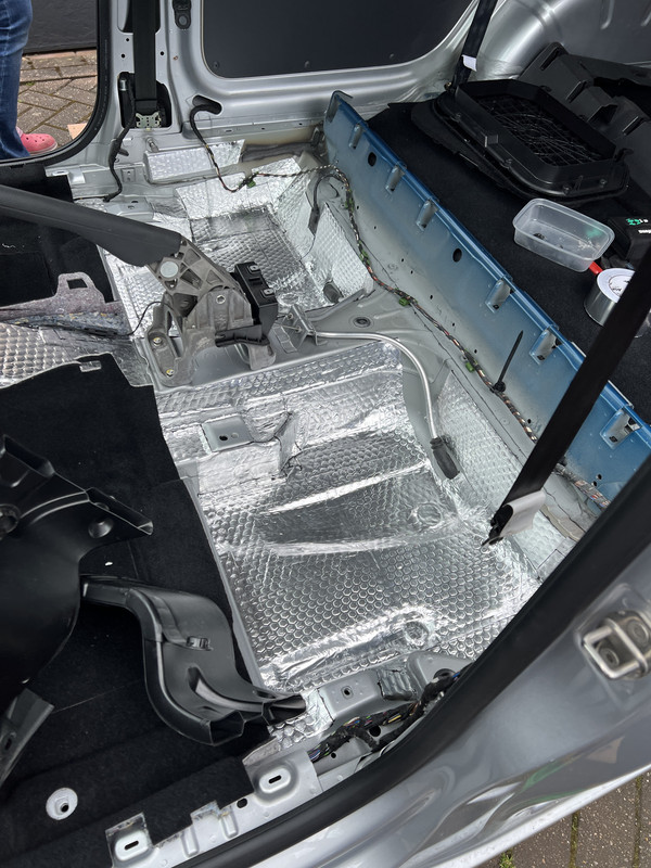

Stripped out the rear and we installed some Dodo sound deadening around the rear floor area, after we installed the sound deadening we installed silver tape over all the joints in the rear but also revisit the front much to the bosses disgust!!

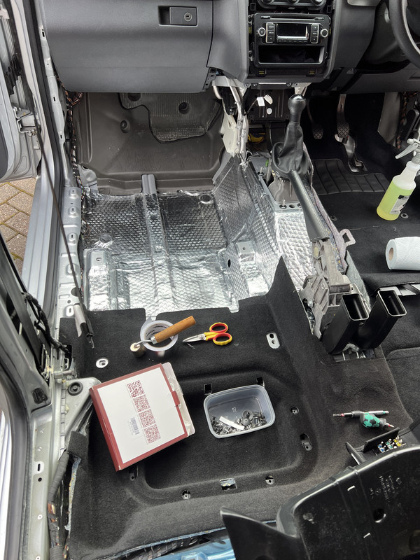

Started to build things up and put the front and rear carpets in final, I then also installed the centre console to complete my Touran dash install
Just need some alternative front seats so I can install the Touran under seat storage and would love an AW Polo GTI MFSW

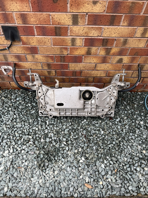

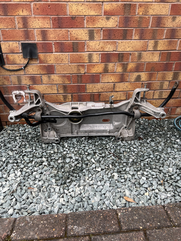

Gave the aluminium subframe I picked up the other day a clean, not bad for £29
I'll probably strip it down and take to work and vapour blast it, it'll come up like new
The subframe and the 1.4TSI hubs are for the next phase of mods, but need to save a little first!!

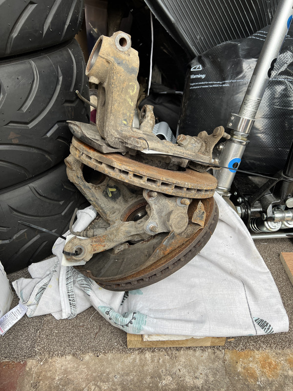

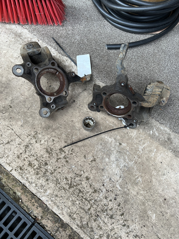

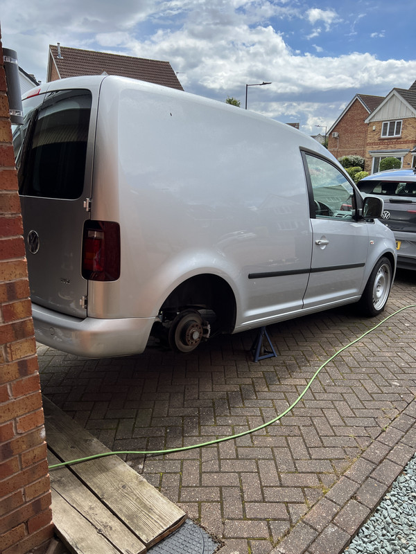

So some of my plans have had to change as my front wheel bearing has failed and I was stuffed if I was going to swap it on the hubs that are going
So the van has been off the road while I collected parts.

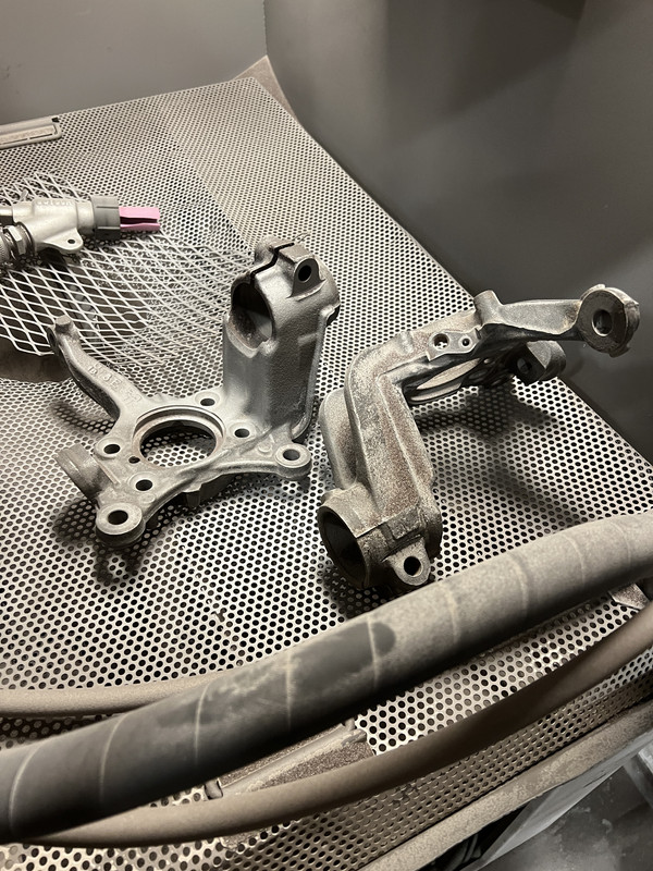

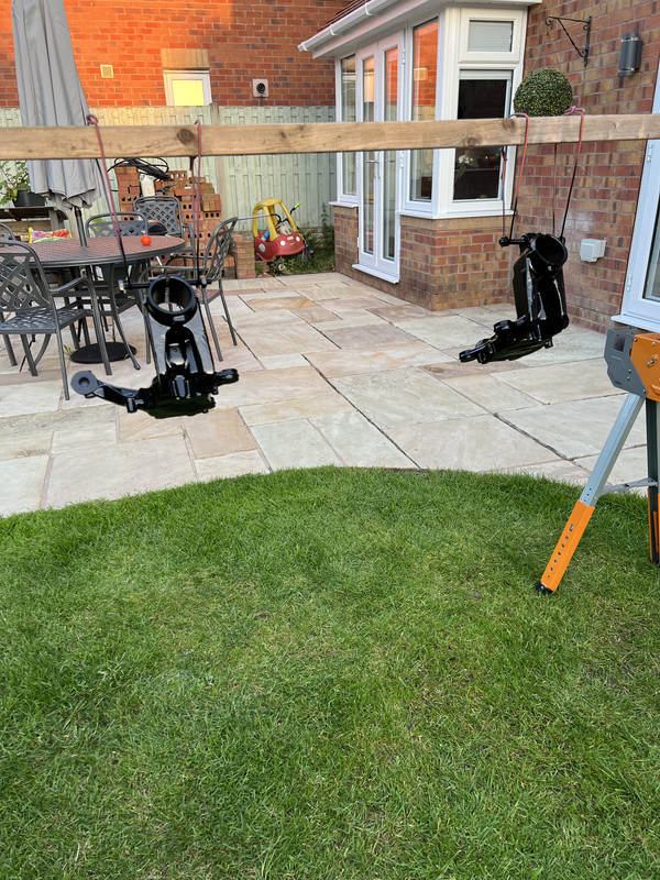

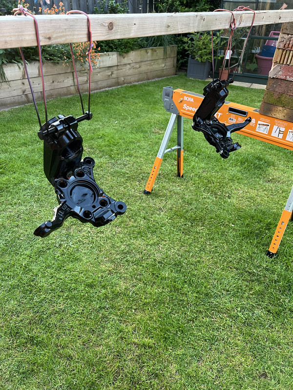

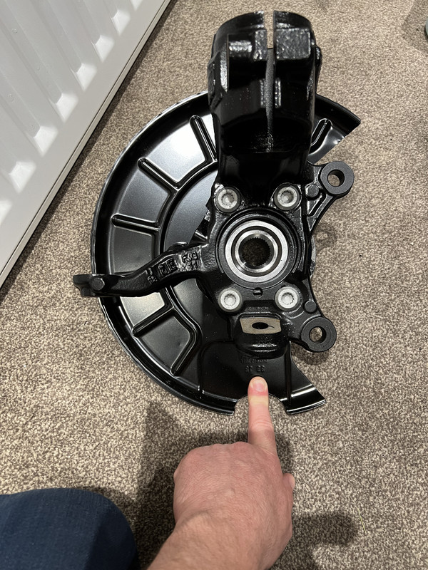

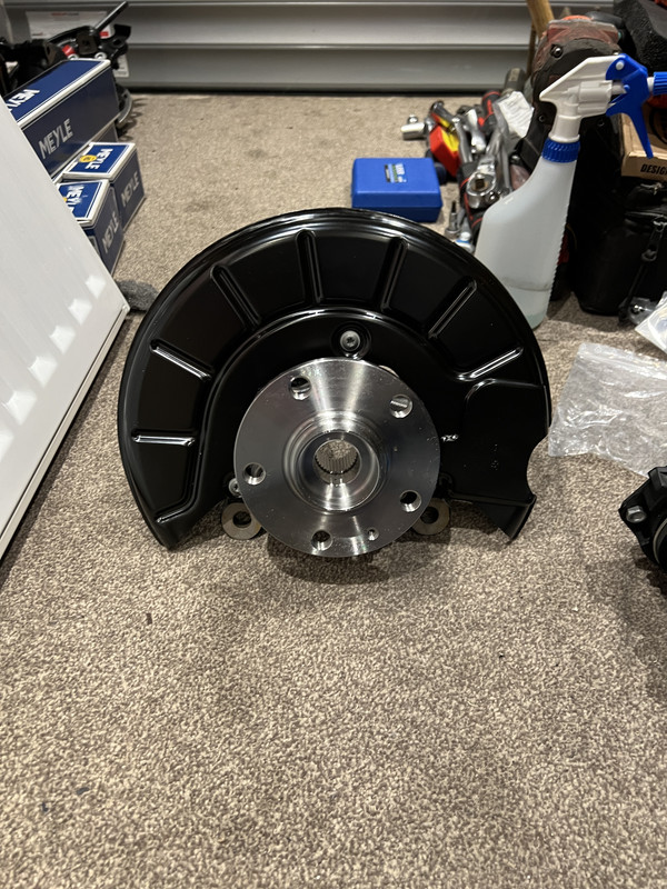

So first up was overhauling the 1.4 TSI hubs I picked up from Synetiq I showed earlier in my thread
I started by stripping them down
I took them to work and blasted them back to a decent state
Good old smooth satin black Hammerite had them looking nice

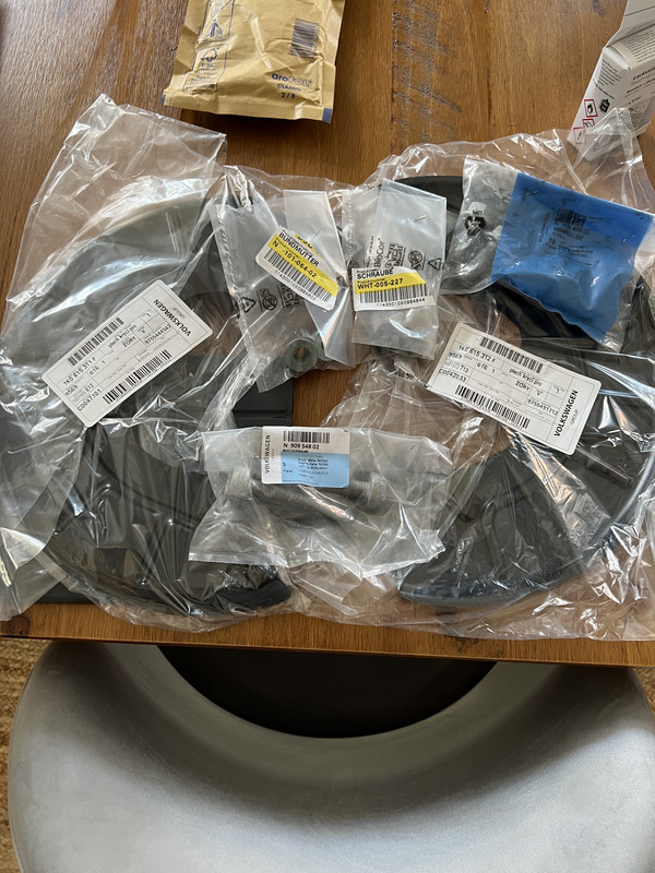

Some brand new components from VW and SKF had them looking as good as I could get them

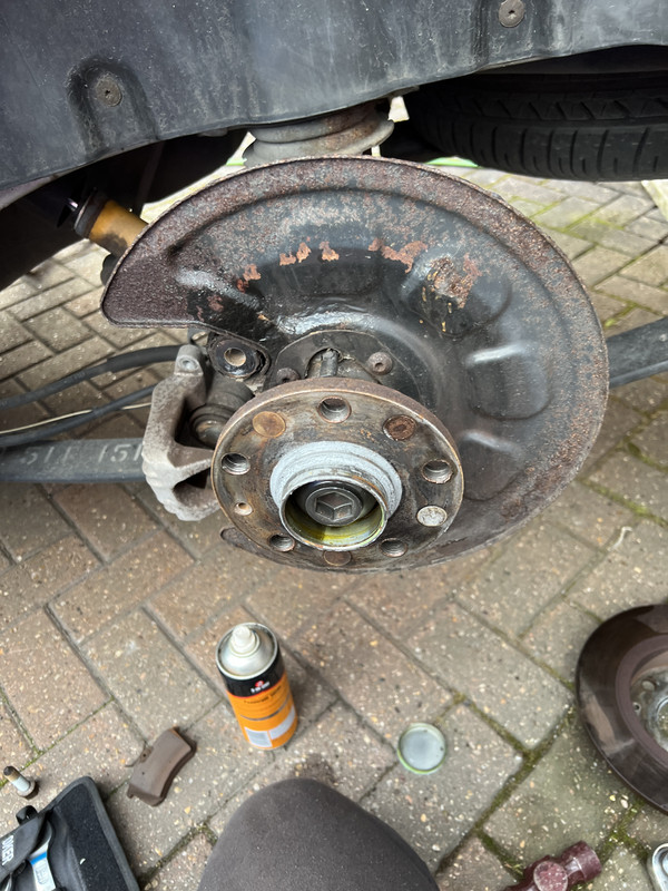

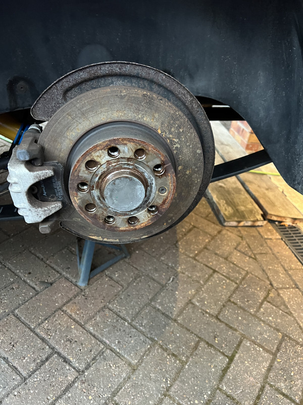

Next up was the rear which I treated to new SKF bearings
There are a few components that need swapping out later when I do the brake upgrades

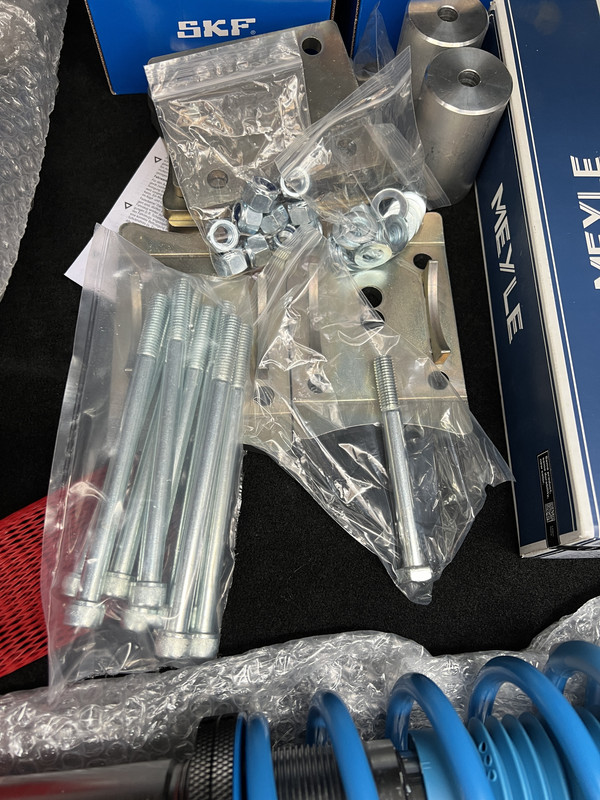

So while my van was out of action I had time to think about what would be beneficial to complete while I had it laid up and what I had to wait for.
So I placed an order for some parts, unfortunately some were on back order so I couldn’t wait and had to have another trip over to Darkside to pick up their Bilstein coilover lowering kit

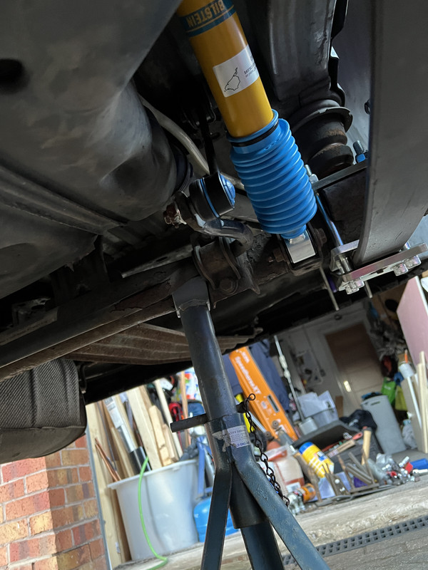

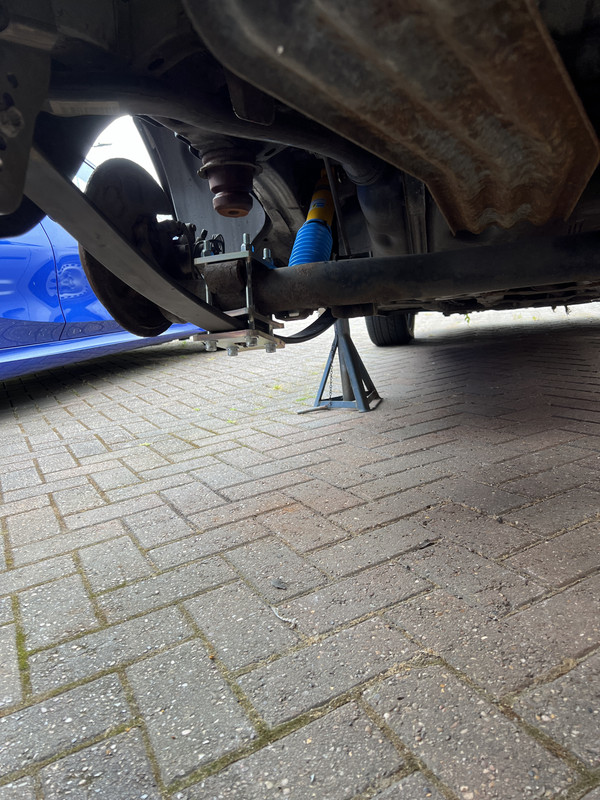

So with many of the parts in my possession I made a start with rear

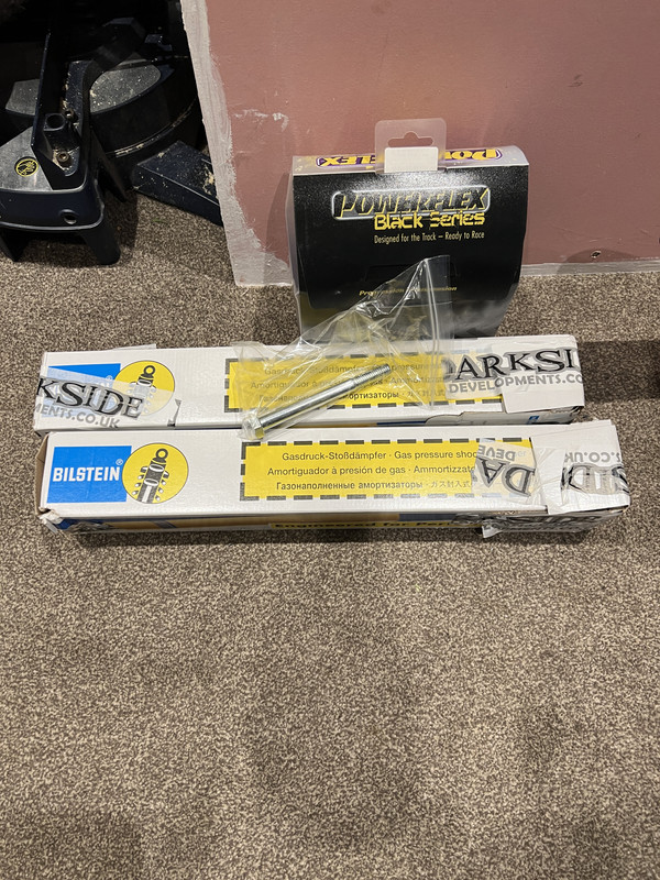

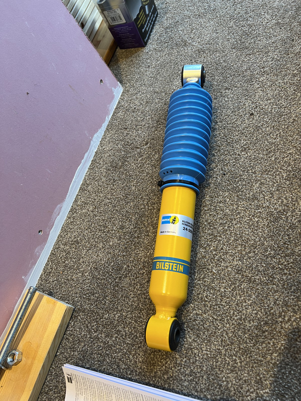

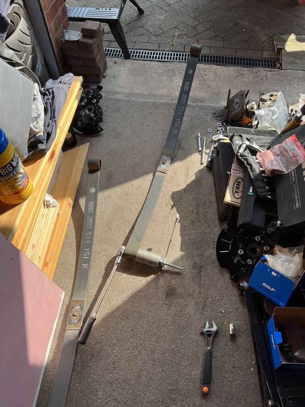

The rear shocks and leaf spring powerflex bushes finally turned up so I managed to get the rear complete. I also fitted new Meyle ARB links

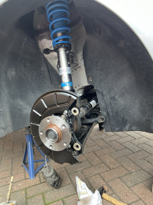

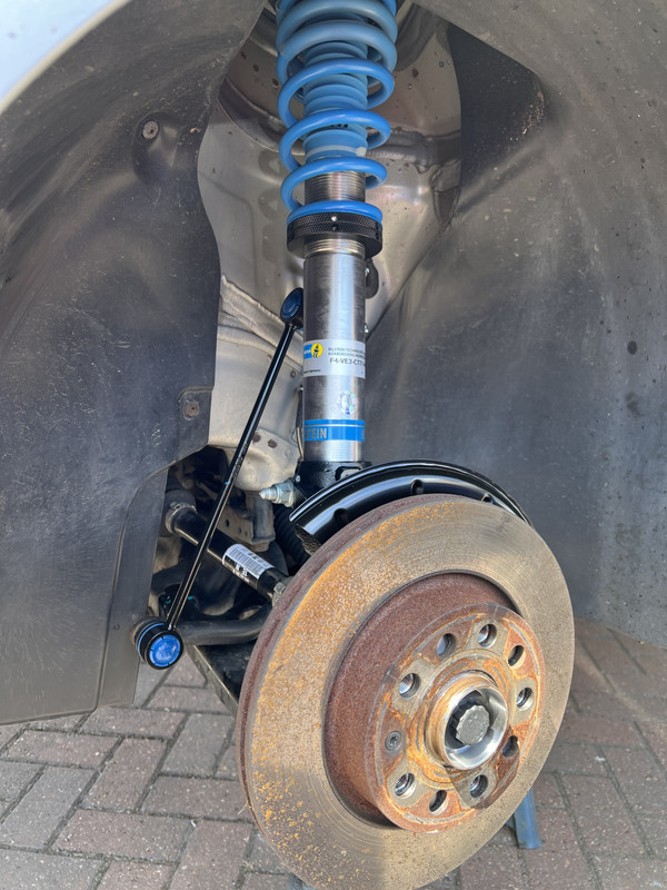

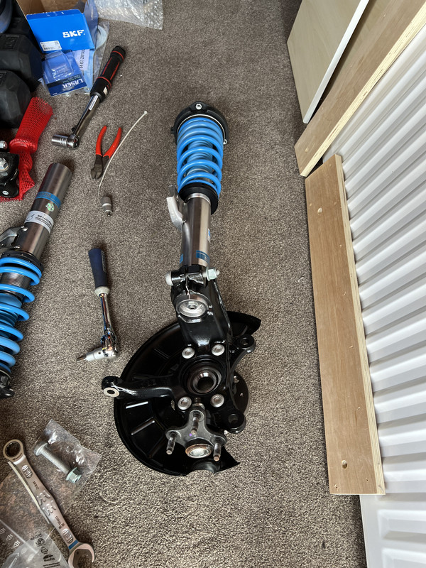

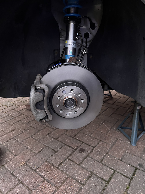

So I took Friday off to make some headway between the van and having to take the ID3 to get a tyre repaired
So made a start with the front, so built up the replacement hubs with coilovers
First one bolted into position
A few more bits added including Meyle HD drop links
I purchased some interim 2.0 calipers which until I fitted them didn’t realise I needed a bigger front disc. Quick order placed with Euro Car Parts and I’ll be picking up some Brembo discs tomorrow, good job they’re open Sunday. Last few bits to do tomorrow, brakes to bleed, final torque of bits once it’s back on the floor.

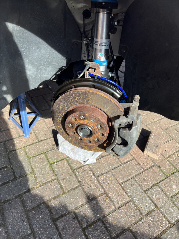

Nath&Alex
- Posts: 127
- Joined: Sun Jan 17, 2021 10:51 pm
Re: Nath‘s Reflex Silver 1.6TDI Match
Another day, another box of new car parts

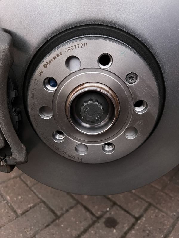

A quick job this evening especially when all bolts are new and not fully torque up yet New Brembo 312mm discs and pads everything put back together and torqued to the correct value
Just need to bleed the brakes tomorrow when the boss can help, then wheels back on and lower it down for final torquing of components. Then off to get wheel alignment sorted
