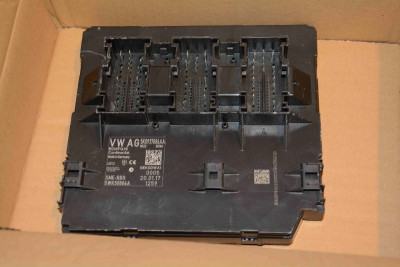

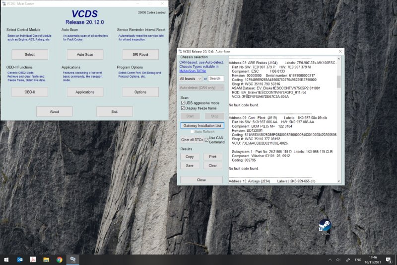

I installed a 086 BCM, replaces the 085 one I had installed. Coded and adapted the keyfobs, everything is working as it should.

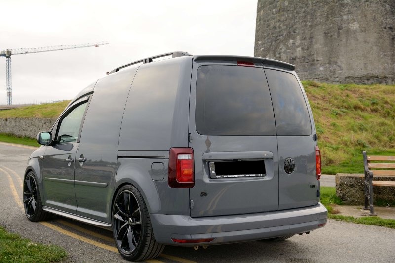

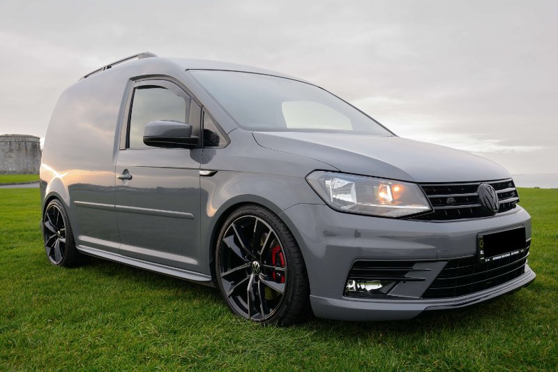

Some pictures of the van with the KW kit installed. The shorter drop links didn't work for me. The drive shaft and ARB were rubbing when turning so the original ones are back on.

I will let it settle for a few days, maybe some adjustment needed at the rear with centralizing plates.
