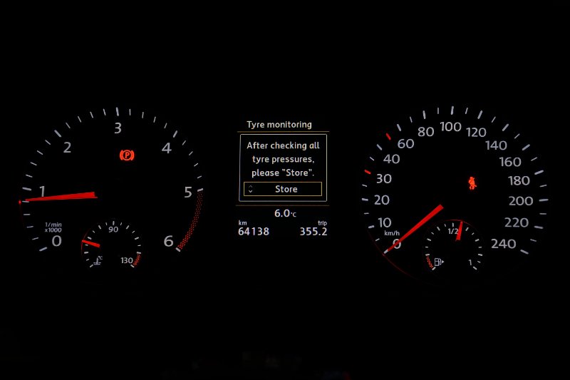

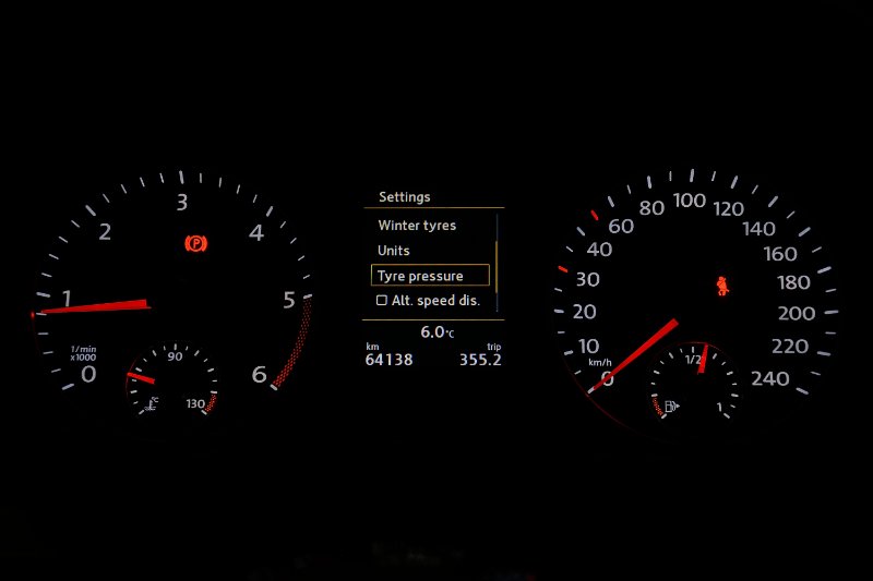

I enabled in-direct TMPS using the ABS in my 2017 MK4 van tonight :D . I followed the instructions in the How To part of the forum apart from the ABS coding. I had to change 03 ABS coding BYTE 15 from E3 to D3.

Robert helped me with the ABS coding, he was very helpful, thanks for the contact.

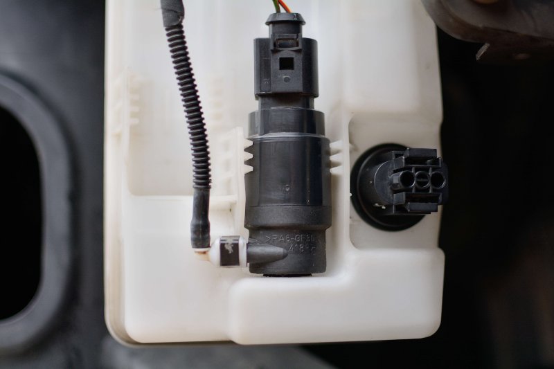

I fitted a Screen Wash Level Sensor and plug today while I had my bumper off, just waiting for some terminals to arrive so I can wire it up.

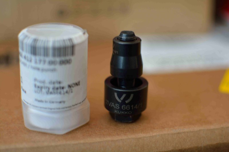

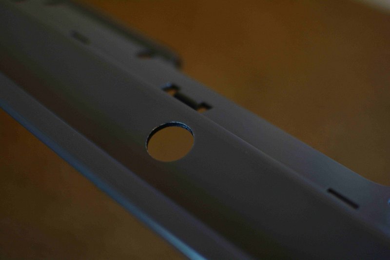

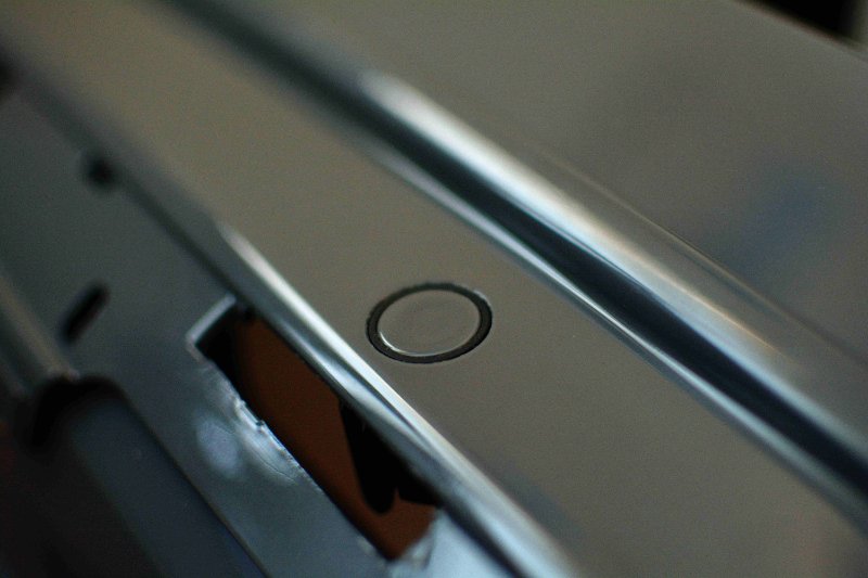

Prepping the rear All-track bumper for PDC sensors using the VW VAS6614/1 punch to create the holes.

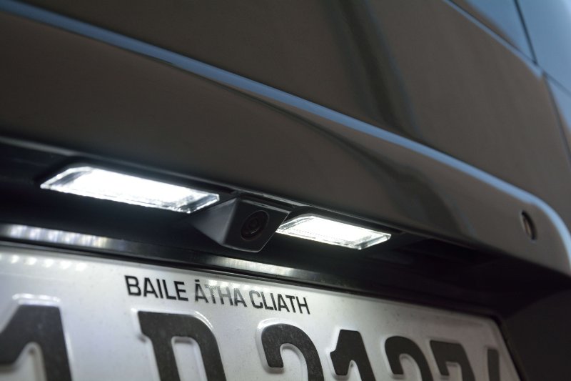

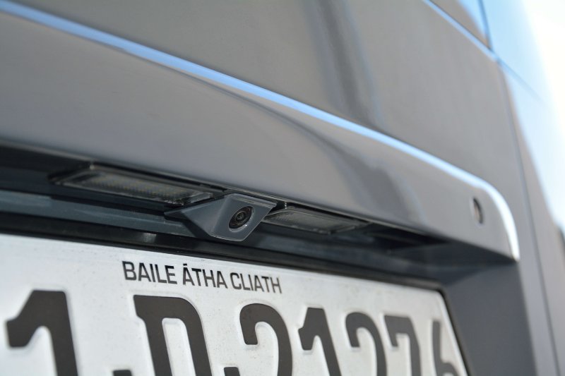

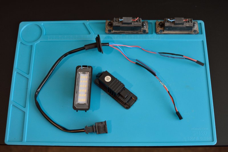

Installed these LED number plate lights today https://www.amazon.co.uk/gp/product/B06 ... UTF8&psc=1
Once I removed the halogen lights and housing for the bulbs the new LED ones clicked into the existing openings. I cut and re-used the existing wiring harness just like in the how-to part of the forum, soldering on the plugs from the new LED lights. I did try using the BMW lights in the How To part of the forum and they would be a better option but my reverse cam was in the way as the BMW ones were a bit bigger.

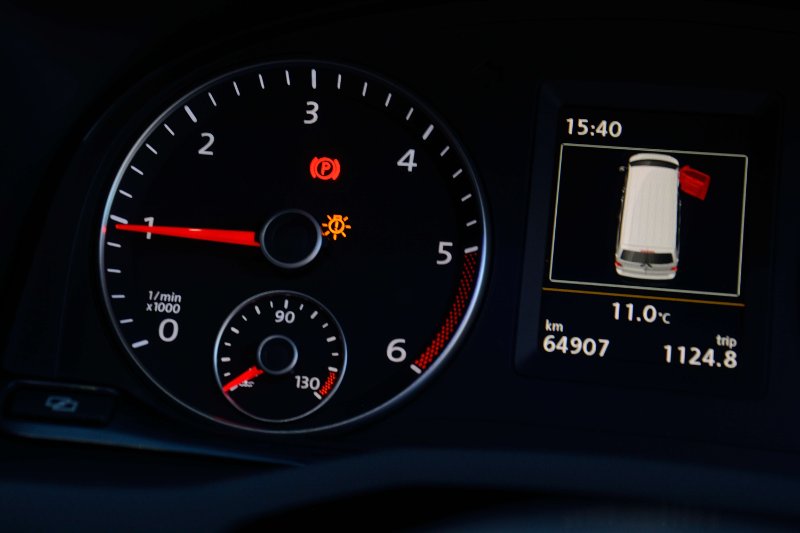

Coded as per the instructions in the How To part of the forum, no dash warning light.

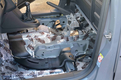

2mm sound deadening installed on the cab floor, getting ready to install the Caddy carpets. A perfect time to run the wiring for the PDC harness.
