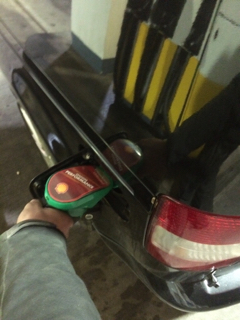

This still feels so wrong. I have to keep telling myself it's right every time!

HahaOllie370 wrote:This still feels so wrong. I have to keep telling myself it's right every time!
Has anyone ever looked at you funny or asked if you knew you were putting petrol in your van? I would if I saw someone doing it I think..

Re: Taddy TFSI
No one has said anything as yet, but I'm sure people have looked and thought it!
