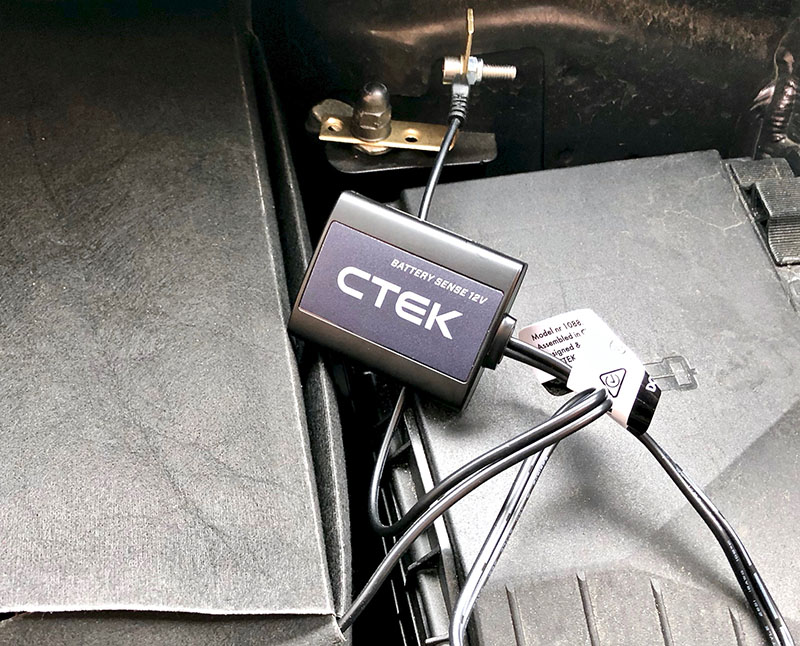

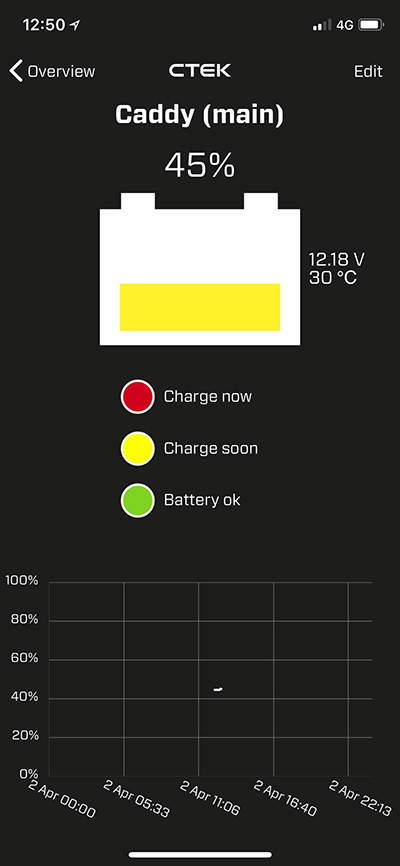

Had a few battery issues a month ago during the snow. Cold temperature coupled with van not being used for 5 days meant a flat battery. AA came and started it and I think it's the 500mA wifi that's draining it, this is how it will be until I get round to fitting the leisure battery for the AV system.
In the meantime I've fitted one of these to see battery state and get notifications of potential starting problems. It's a CTEK Battery Sense and will also get another one for the leisure battery.
It's not recommended to fit anything directly to the negative battery terminal on EU5/EU6 vehicles with IBS, it's also very difficult due to the captive nut on the battery post, so made up a small bracket to attach to the separate negative post next to the battery, ensuring that it's "outside" of the intelligent battery sensor.
