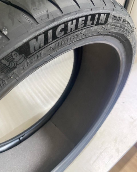

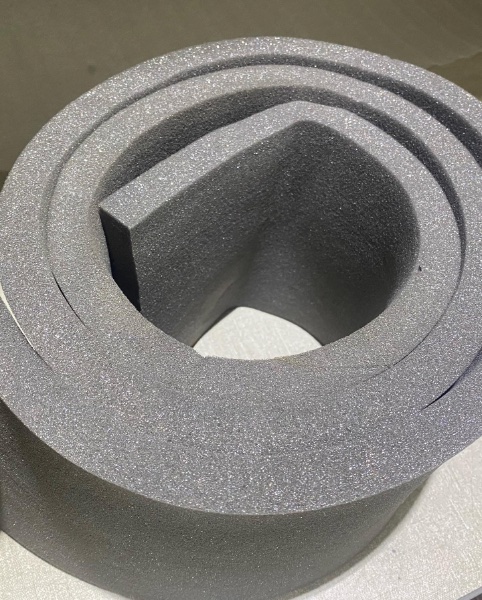

So having seen this on a friends front Mclaren tyres to reduce road noise I decided to add some 16mm thick open cell foam to the inside of the tyre. Common on EV’s too.
Good for a few db’s.

Ye I hadn’t till we were swapping out the oe tyres on a friends Mclaren 570s for wider tyres, before going the ring.
Difference was quite a bit louder… beyond what 10-15mm wider tyre would do. Tests would suggest 2-4db and a change in sound.. as it’s not linear measurement.

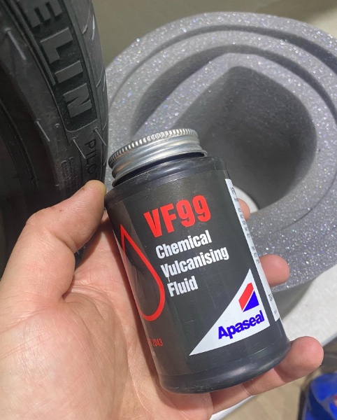

Only thing I read is a small fraction of these tyres suffer from the foam coming away and sometimes giving a vibration. So I have bought a spare piece of foam so I can see how well the contact glue has done first.

The pirelli pzeros R01 tyres on my rs3 have this foam in them to. I suppose them being 235 35 19 profile probably helps some what with the road noise. Interesting mod you doing there buddy. I think your the only one I've read on a few forums that as gone this route. Thinking outside the box indeed

Little update on the foam in the tyres... went back to them today and its all bonded very well. The foam rips before the glue comes away!

I love your use of foam in the tyres. It’s exactly what you see inside the acoustic Michelins that cost about £20 more per tyre. Next time mine are up for renewal I think I’ll follow your lead.
