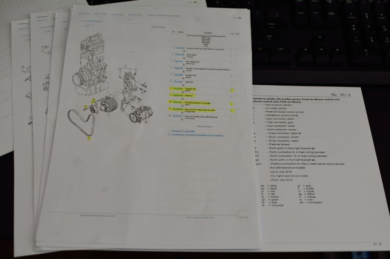

I spent a lot of hours going through all the forum posts and parts/ current flow diagrams making sure I got all the parts and terminals. This forum is the best caddy encyclopedia about, so much info and inspiration.

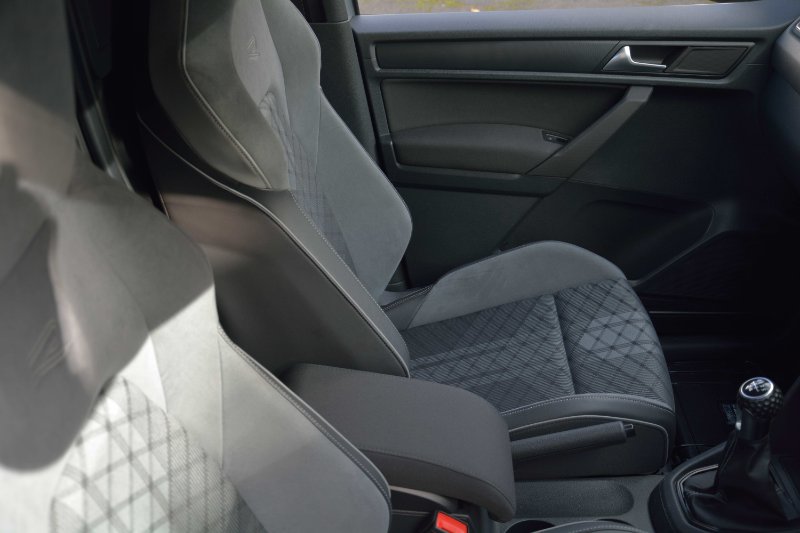

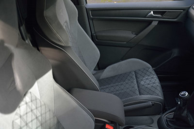

Center console in titanium black and ratchet arm rest with black cloth to match the door cards installed.

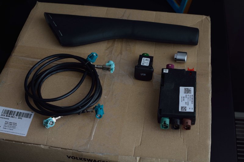

Sure is buddy. I have a leather handbrake with chrome button and a USB port to add to it now.

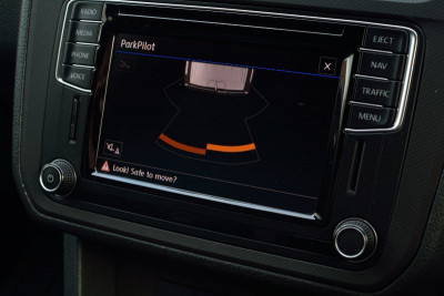

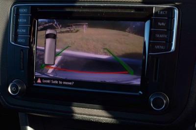

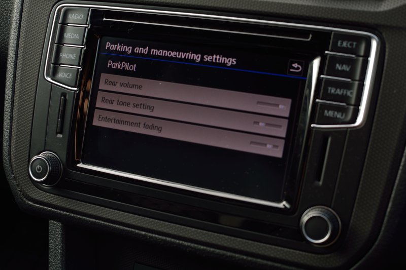

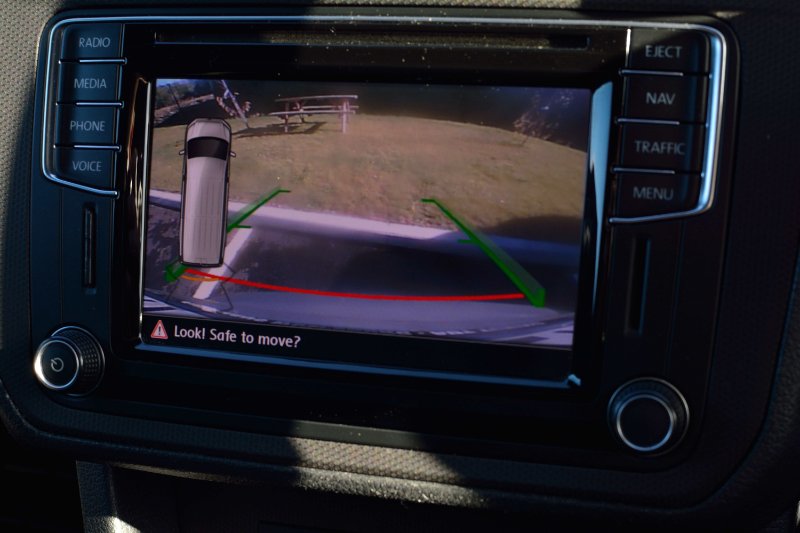

I have Park Pilot working on my MIB2 head unit now. I had the PDC working for a while but I couldn't get the car/ van image to come up in Park Pilot. I changed vehicle type with VCDS in 5F Infotainment from caddy to crafter and then the image came up, there must not be an image for a caddy and that's why it wasn't showing.

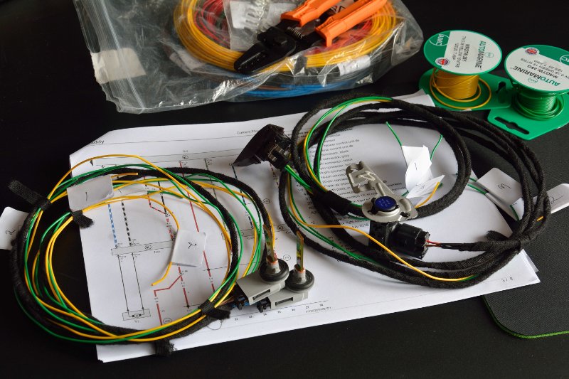

Looms finished for A/C Compressor, High Pressure Sender, Sunlight Penetration Photosensors, Air Quality Sensor and left and right vent temperature sensors. Everything is ready to install now :D

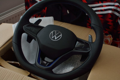

New steering wheel, MK8 R Line with touch sensitive controls and heating.
fishynos72
Posts: 326
Joined: Mon Aug 24, 2020 10:12 am
Post by fishynos72 »
Stunning piece of kit that wheel.
I've a paddle-less version awaiting install in my van.
