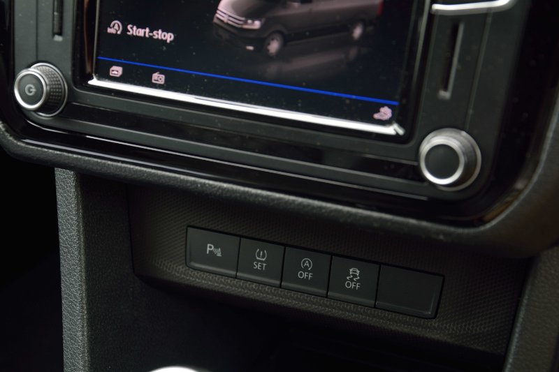

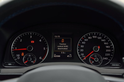

Park Assist, Tire Pressure and Electronic Stabilization dash buttons installed and wired now.

Why not go further ESC OFF and HDA?
Hill Descent Assist
Byte 6 bit 1 (0 -> 1)
Byte 14 bit 6 (0 -> 1)
ESC OFF
Byte 15
Bit 6 (0 -> 1)
Bit 7 (1 -> 0)
Hi Robert,
Thanks for the tips, I will have to do some research. Do I need a dash button for the Hill Descent Assist?

FishermansFriend wrote: Thu Mar 23, 2023 9:26 am Hi Robert,
Yes you do.
Just run fused ignition feed via switch and bring it to PIN 8 on your ABS unit.

Firstly- love this thread, for the OEM mods, and the nice photos.
The hardest part would be having a button made for the Hill decent control that fits in the mk4 caddy dash.
Someone like double-apex might be able to help
How many is too many Volkswagens?
Thanks for the info Robert.
Hi fishynos72, thanks again. Yes having it look right would be the hardest part. Thanks for the contact, ill check them out.

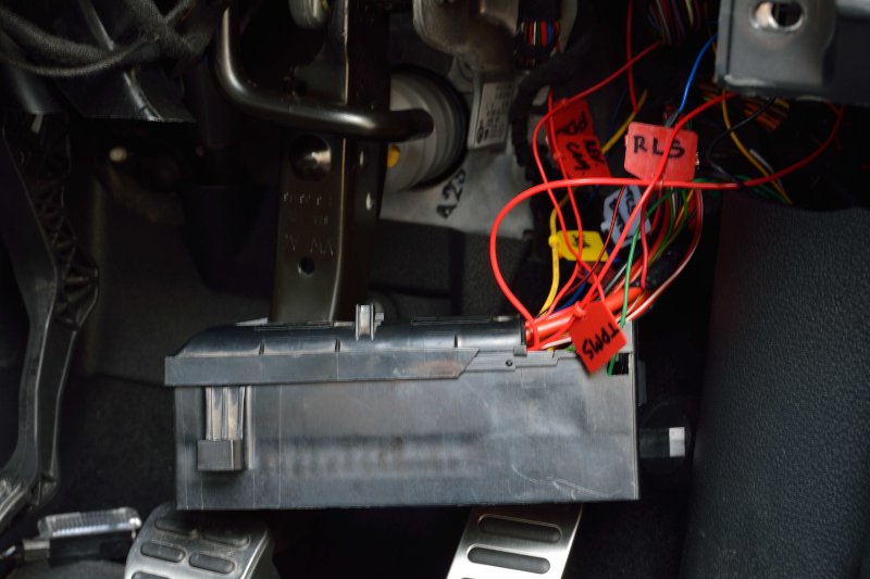

Been tidying up the fuse box the past few days, it was a mess. I re-run all the wires that were added since I got the van and got rid of the fuse holders that plug into the front of the fuse box, re-pinned with terminals into the back of the fuse box. Followed the OEM routes as best I could and labeled the wiring I had added.
Install the CAN Bus extension cable also, really handy to add more wiring to the CAN Bus now.

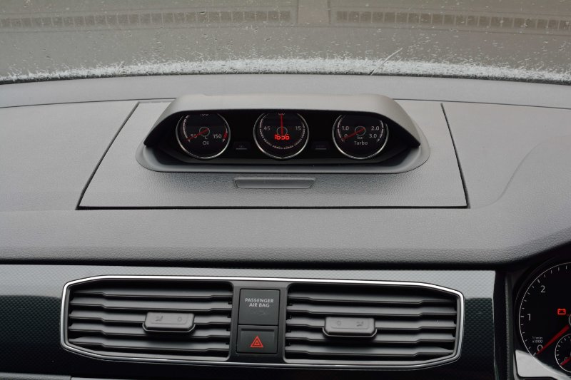

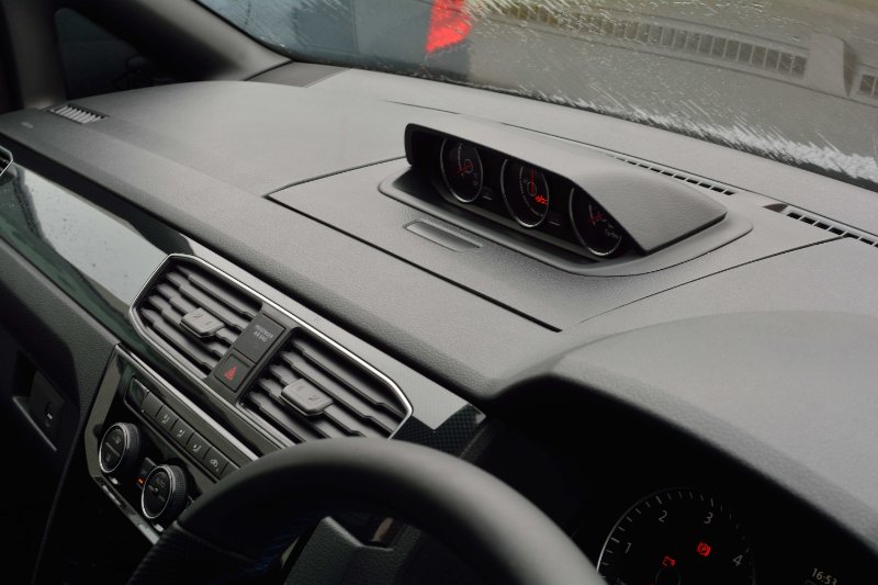

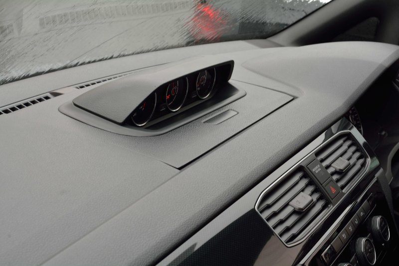

Gave the dash top box another sanding to make it fit a bit better.
