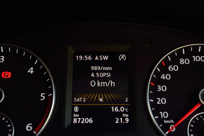

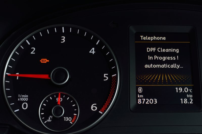

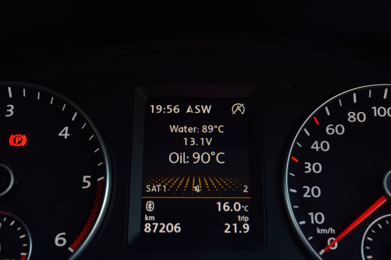

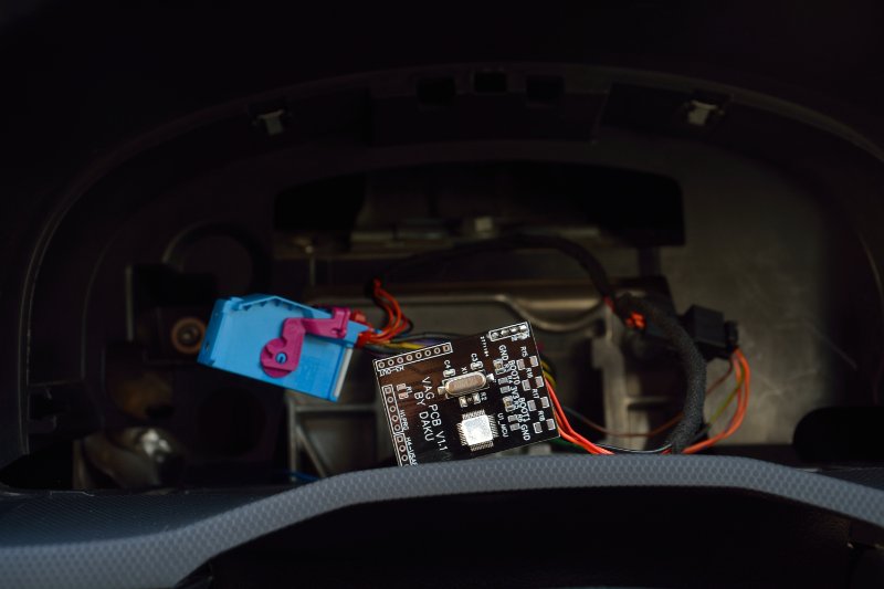

Installed a Daku VAG PCB, it gets connected to the Instrument Cluster CAN-BUS and it brings up extra options like DPF purging message in MFD and DPF purging icon during purging, when its finished the icon disappears and plays a gong sound. Its also displays coolant and engine oil temperatures below factory minimum of 50°C. There is another screen showing RPM, boost PSI and KM/h digital reading.

- Posts: 18787
Oooh, that's a nice addition.
I love these type of interface units that keep the look as OE as possible, utilising the technology already on the vehicle.

Yes Doc, I thought so to. It has a few other features like Bluetooth Icon For Any Module, Front Assit Green Led, Green Side Assist LED. I got it from Robert VW if anyone would like one.
