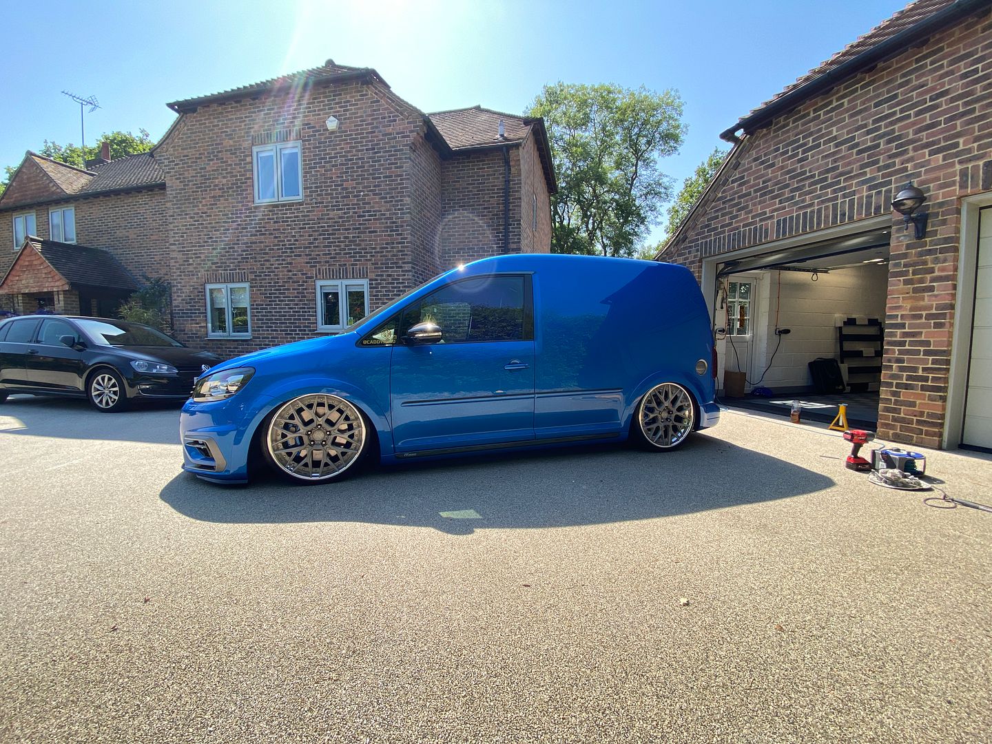

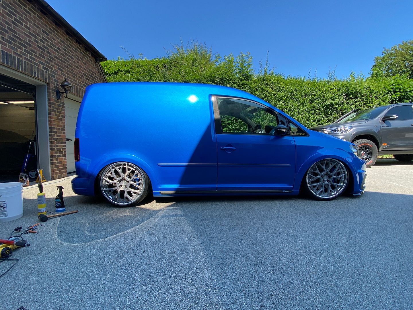

Bet in real they look even better Dan, caddy looks great.
Verstuurd vanaf mijn Core-T4 met Tapatalk
- Posts: 4505
Re: Caddy R360 build thread
Nice choice mate. They look amazing
- brooneye
- Posts: 1471
- Joined: Sun Jan 17, 2016 6:51 pm
New wheels look unreal!!
- Posts: 506
- Joined: Wed Feb 21, 2018 7:02 am
Those wheels look amazing. As does the rest of the can.

Absolutely mega build! Looks incredible!
- Posts: 143
- Joined: Sat Sep 28, 2019 9:43 pm
Ok I’ll be honest here... I’ve skipped a few pages. But WOW!
Credit to you dude that a stunning van and awesome amount of work done to it.
Absolutely love the wheels, but as said before, clearing them would piss me off lol! I have BOLA B12s and they annoy the hell out of me

Still improving this van to unbelievable levels, looking sooo sexy Dan
R22LRM
Mk5 Tfsi powered
Mk5 Tfsi powered
- Posts: 3
- Joined: Mon Nov 02, 2020 8:39 pm
Looking good, confirmed for me that BBS is the way to go, looking forwards to seeing the KW kit in place
