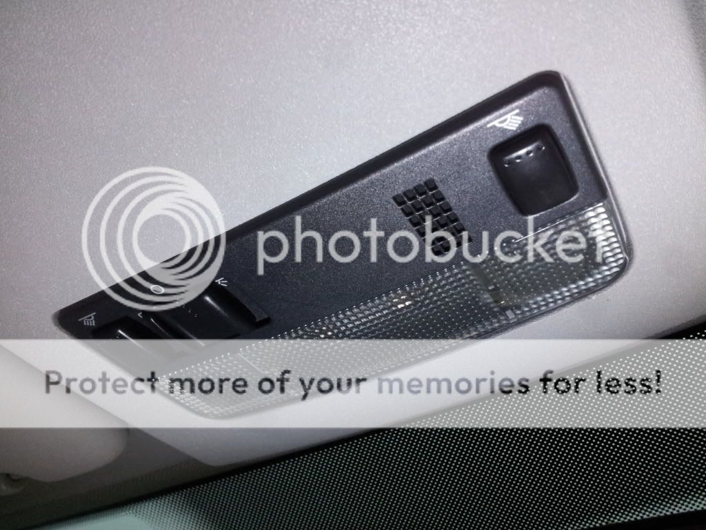

Octavia VRS interior light added.......

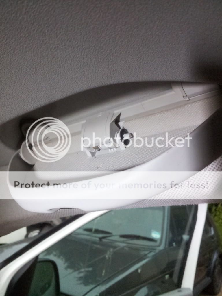

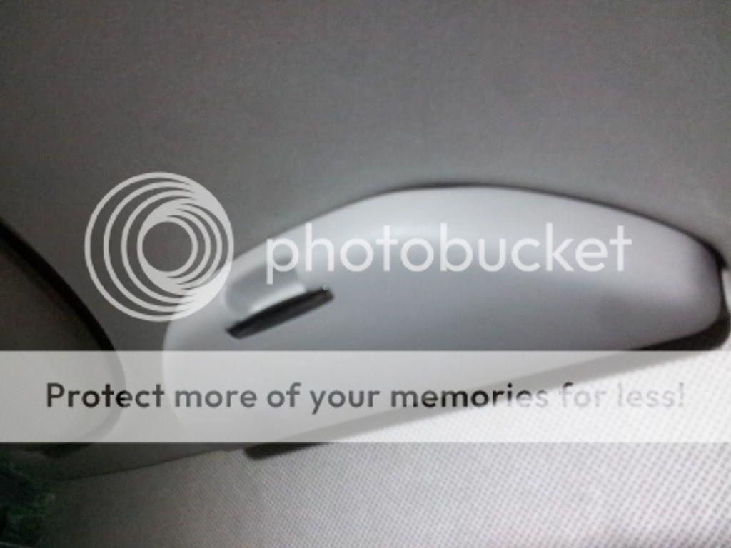

Sunglasses holder added in lieu of grab handle.....

Comin along!
How'd you find the sunnies holder fits? Mines not perfect, good idea though.

The sunny holder is a snug fit so it doesn't snap back on the spring like it's designed to......was same deal on other cars I've fitted them to (if not designed to have one).

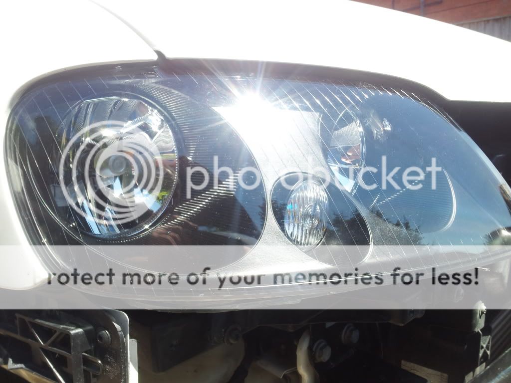

Prepping them.........I started to Scotch-Brite the mirror finish on one of them, and then was cleaning the dust off with a rag doused in cellulose thinners, when I noticed the mirroring just wiping off completely..........
So I wiped over the rest of it and bob's your uncle, it's alot less hassle than keying it all.
You just have to be careful not to soak the plastic too much as it does soften the surface of it.
The ribbing shape around the main and dip beam are a pain but with patience you can get it 80% off.
It doesn't need to be perfect, and you can abrade it all finally before painting anyway.
Left them for 15 mins to allow the thinners to dry off, then hit it with plastic primer (grey).
A quick light coat, then left 5 mins to flash-off, and then a good coat all over.
After an hour, I top-coated them with satin black paint - working from the back into the openings for a quick first hit, the ensure the ridges all got painted, and then after a couple of minutes, painted the front sides.
I've swapped to the obligatory Diadem indicator bulbs just to funk-up the look (hardly new idea, but still cool imho).
Now just got to mastic the lenses back on, and we're done.......

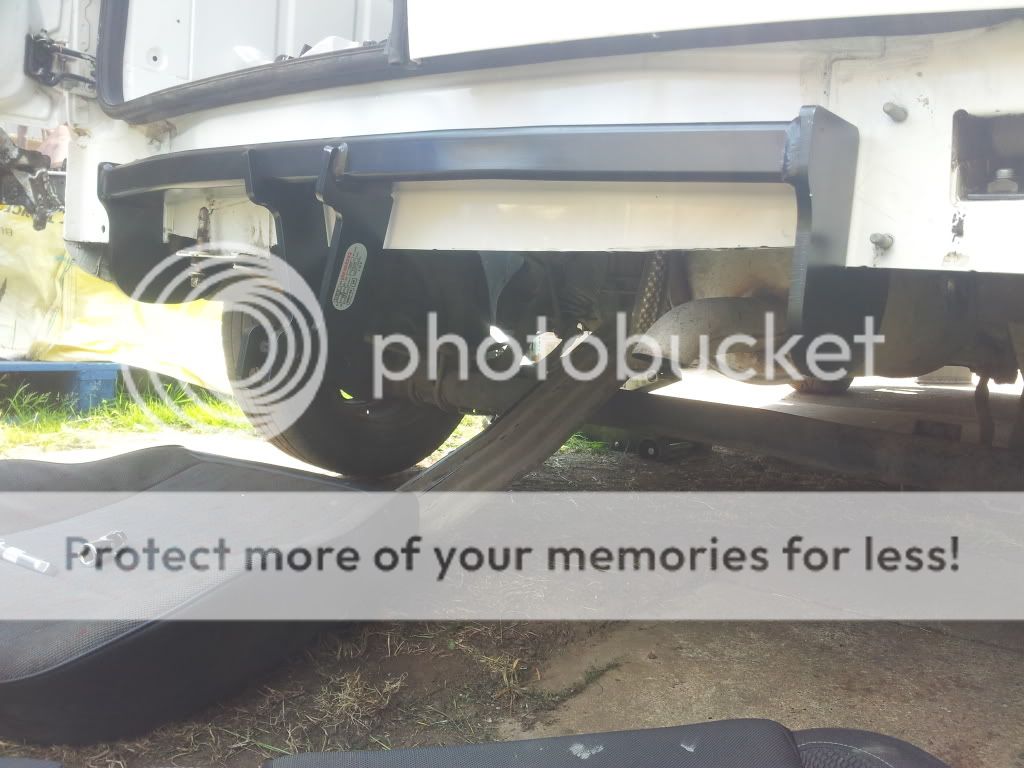

Towbar not as much of a problem as first thought........jacking the van up to take weight off the axle/springs gives enough clearance to fit towbar up to rear chassis legs.
