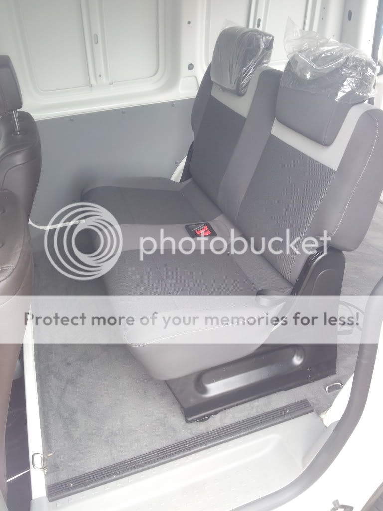

Fitting the Life twin seat isn't as easy as I expected.....the mounts at the front were positioned on the high points of the floor 'ribs' but the rear ones landed right on the edge....so made some spacers from steel tube and tacked them in place to give a solid and level base.

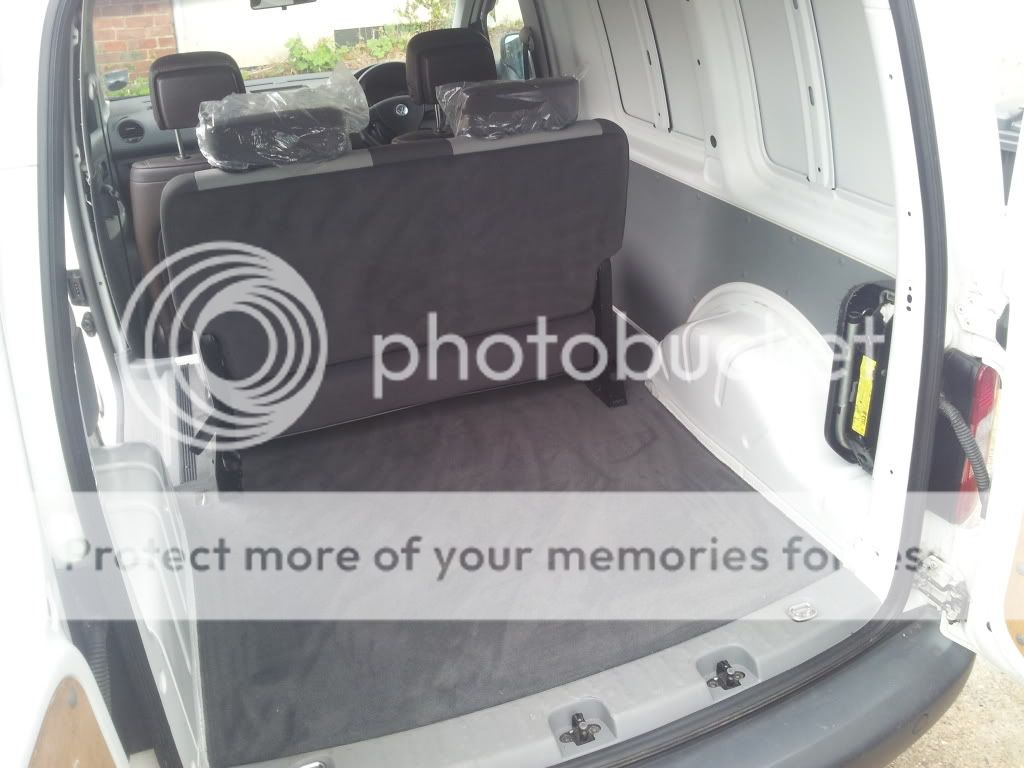

Last couple of jobs done.......
Rear brake pads replaced........were down to 1mm!
Re-fitted ply floor and got carpet fitted, mushroom bolts installed and caddy life twin seat clicked-in.
Turbo Power........
