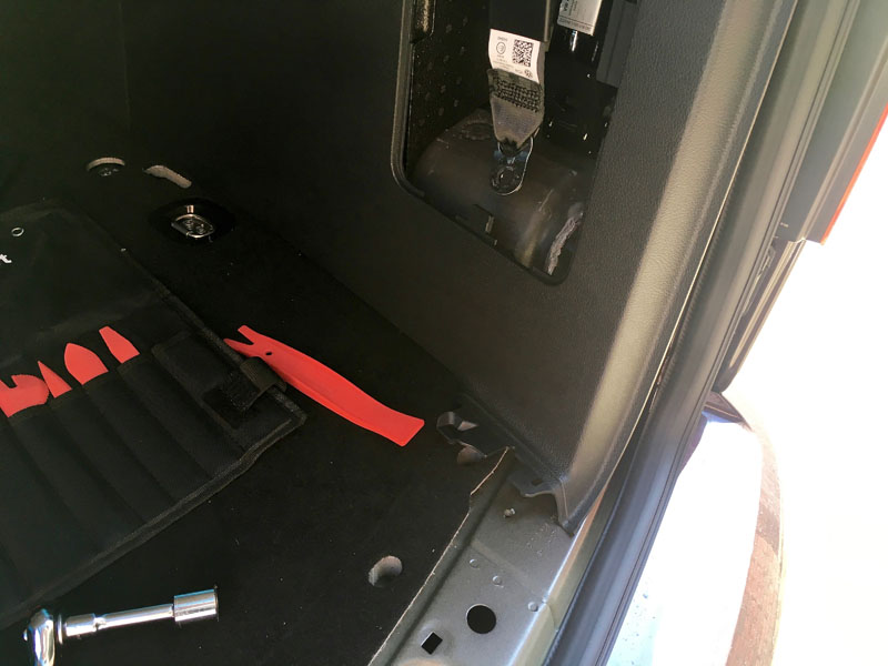

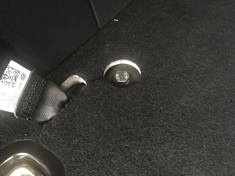

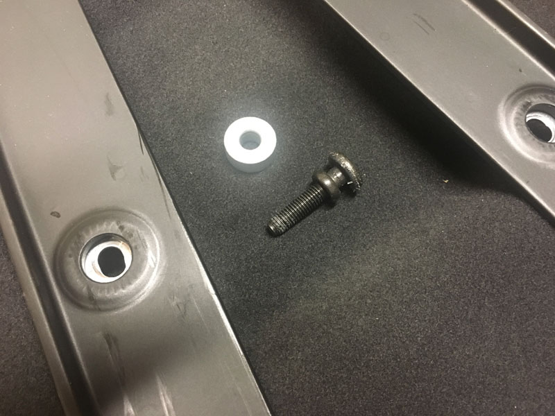

Next thing was to get the rear parcel shelf & 3rd row seats out, easy job, needed all the trim removed to get the seatbelts out, and some blanking bolts (M10) to replace the mushroom bolts in the floor.

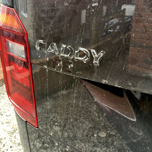

Debadging another easy one, to remove the CADDY LIFE and TDI letters.
About 10 minutes with a hairdryer and trim tools, then 20 minutes with isopropyl alcohol to get rid of the adhesive.

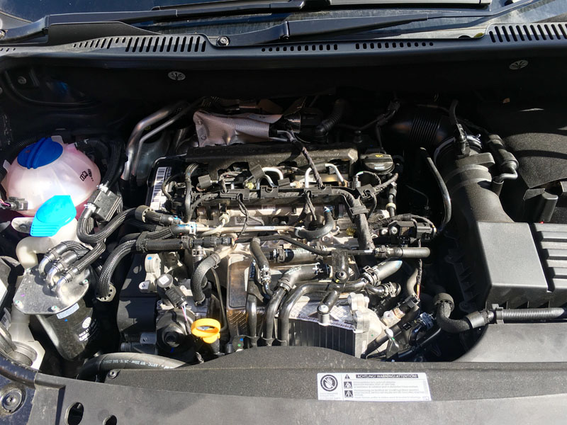

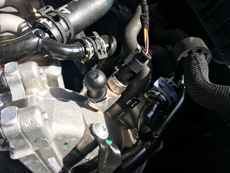

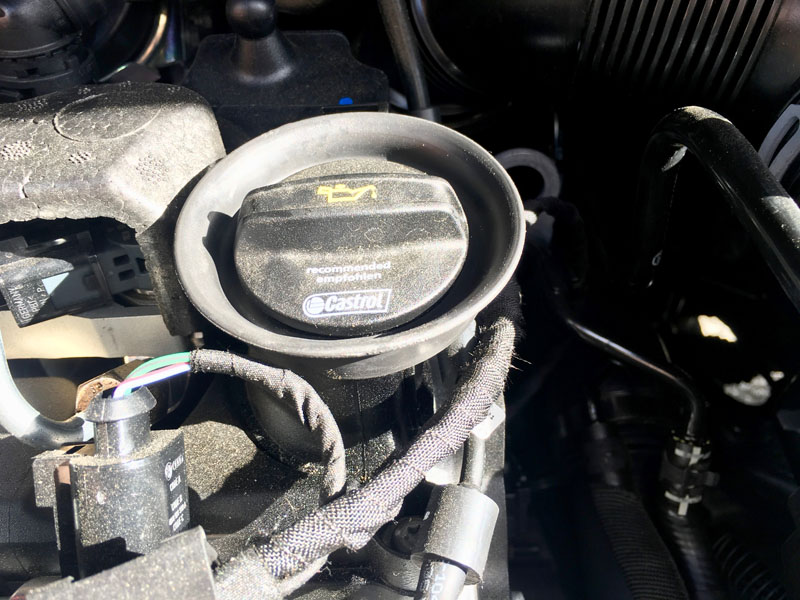

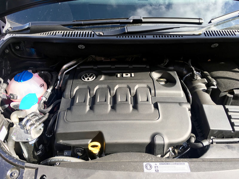

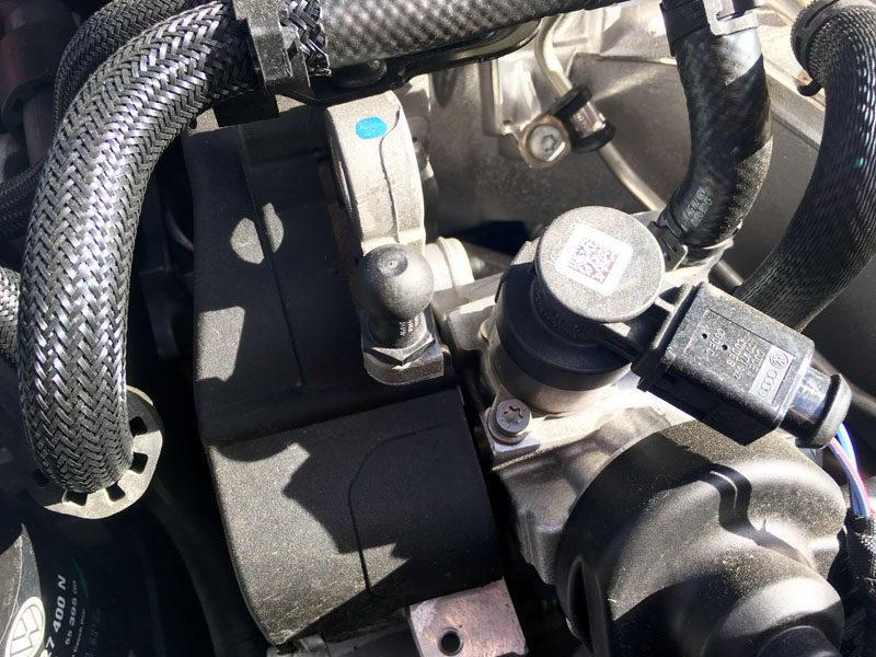

Engine cover was another easy job, found the right one on eBay from a 2016 car £35 delivered, and ordered the oil filler ring and ball joints from TPS, job done.
Part numbers for mk4 150TDI (note, my engine code is DFSB):
1x 04L 103 925 Q (engine cover)
2x 04L 103 164 (ball joints)
1x 04L 133 287 (oil filler O ring)

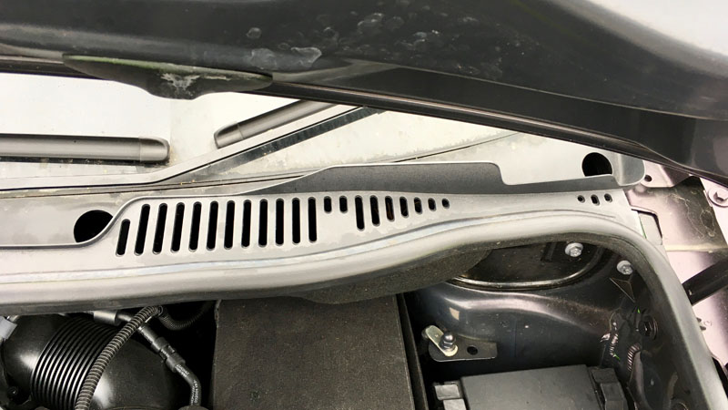

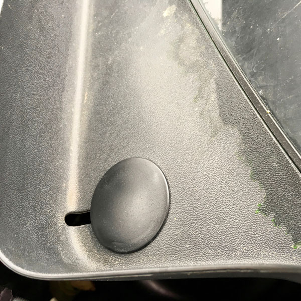

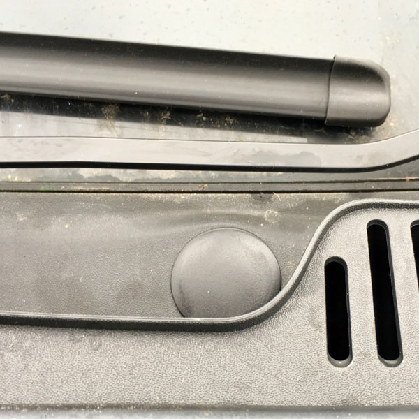

While I was under the bonnet I noticed the gaping holes near the wipers. Thanks to a link on here I found some right sized plugs for about a quid.
The original eBay seller appears to no longer have them, just look for 30mm rubber or plastic bungs / pipe ends.

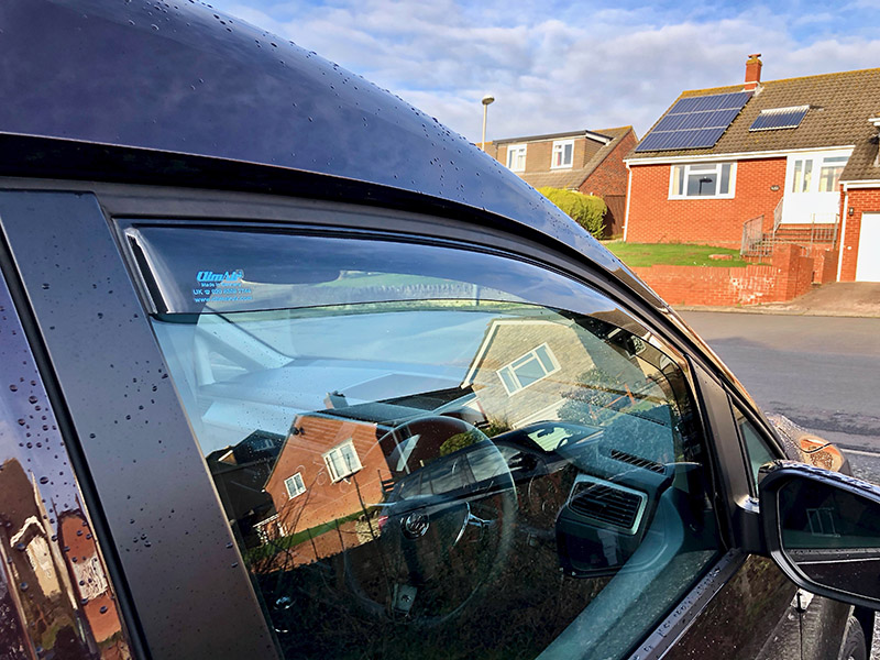

Some Climair wind deflectors, easy to fit.

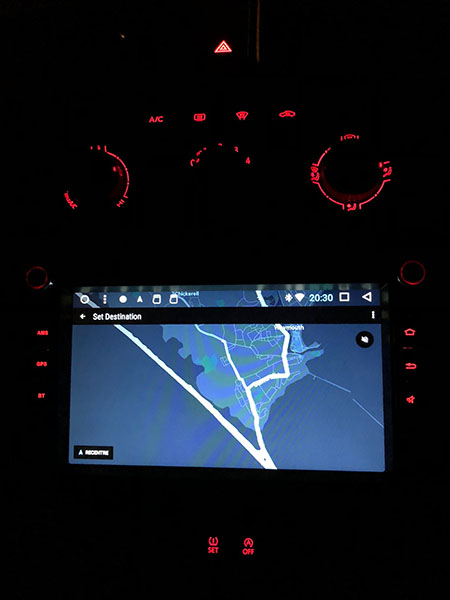

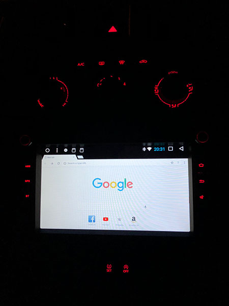

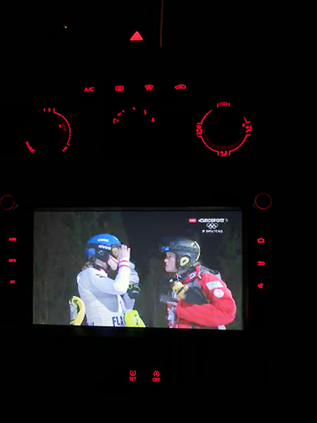

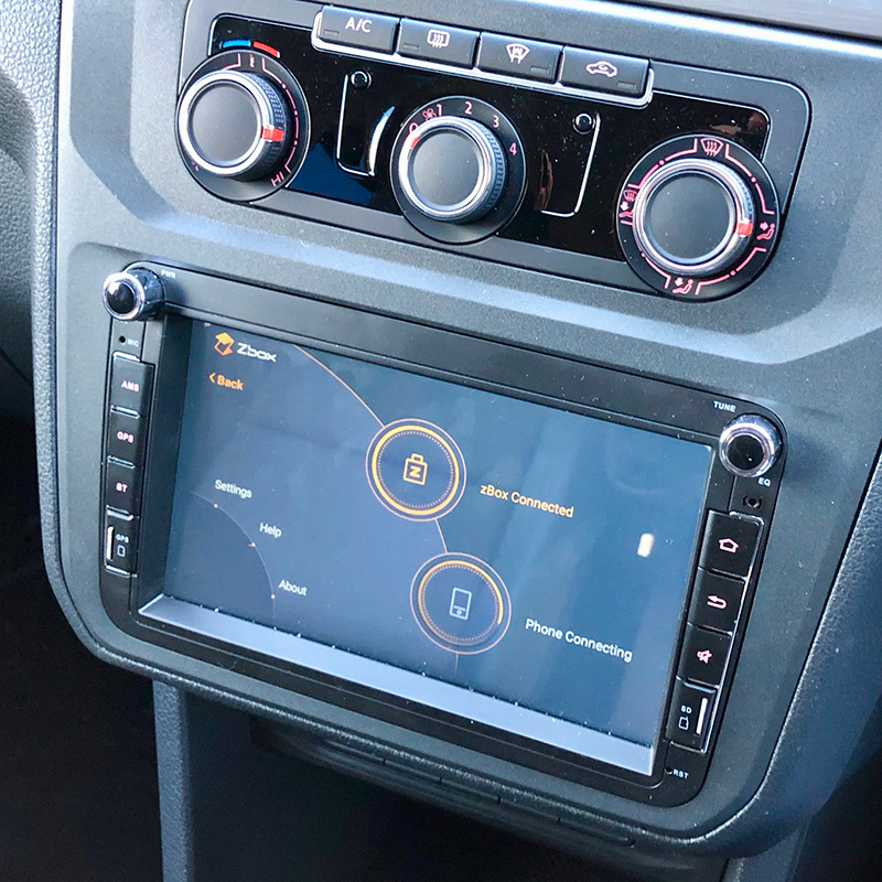

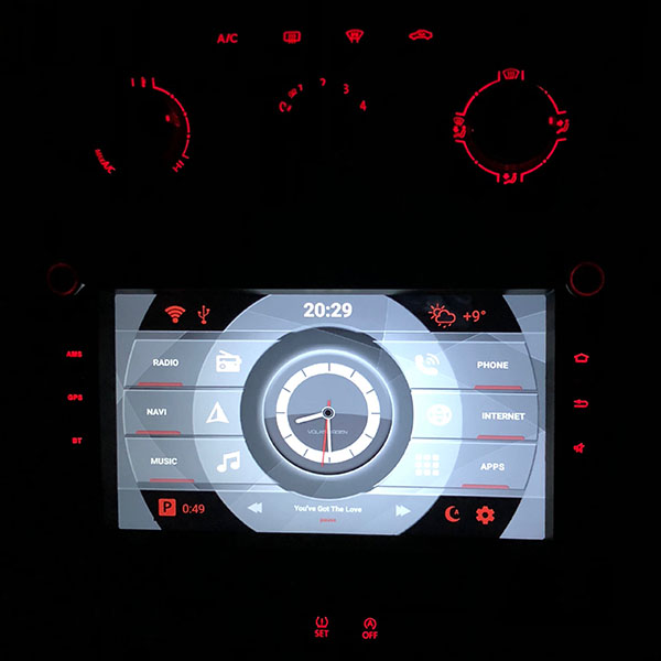

Head unit next to change, van came with basic Composition Colour, and after much research was arriving at the conclusion that this was very difficult to upgrade officially to something OEM like Discover Media due to Component Protection. Looked at various offerings from Kenwood, Pioneer, Alpine before looking at one of the many Android ones from China. Thought I'd take a punt on this as I figured that if it was no good, I would be able to get most of my money back on resale, and bought from Amazon to get the 30 day guarantee. If it worked out it would be a third of the cost of anything else and would be able to do so much more. I'm looking at putting in a rear screen mounted to the roof, and am building a media server based on a Raspberry Pi. The Android units have enough AV inputs & outputs to drive external monitors.
I've written up the experience on another thread in the Electrical / ICE section, but basically these units are great once you've binned the standard apps and replaced them with Spotify & Google Maps via the Play Store.
On this thread there's links to a few other thread where I've posted about it.
http://caddy2k.com/forum/viewtopic.php? ... 8&p=284172

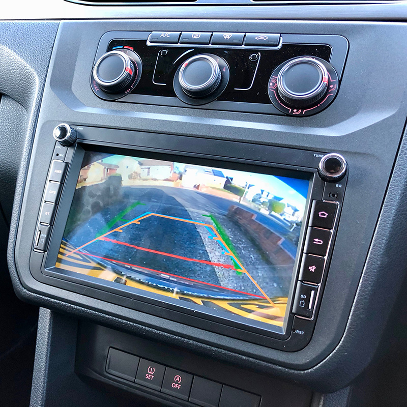

The unit comes with a can bus box and will pick up stuff like door open warnings, parking sensor visualisation etc.
Also works with the factory reverse camera via an adapter:

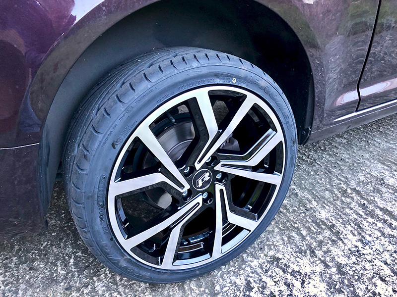

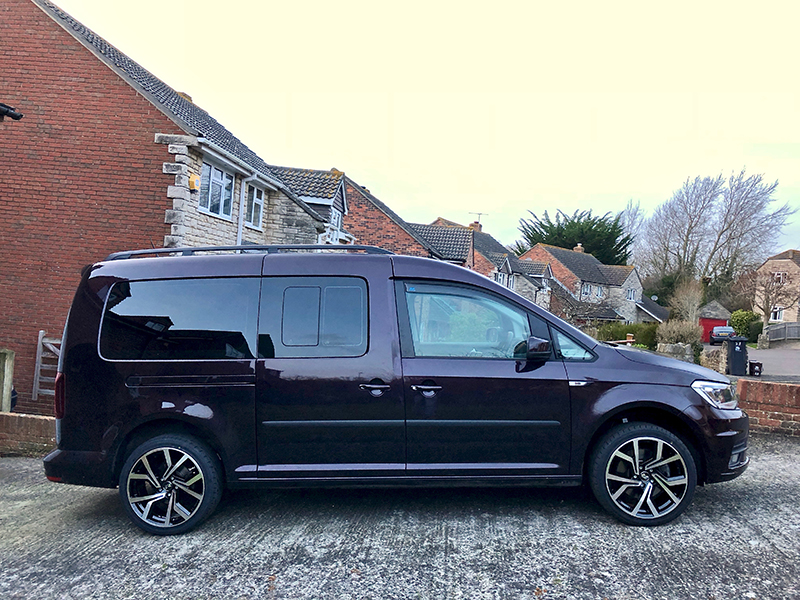

One of things that has really been bothering me is the sheer awfulness of the standard 16" Forteleza wheels. Got a cracking deal on eBay for a set of replica VW Brescia (Clubsport) wheels.
Tyres are Toyo Proxes T1-R 225/40ZR18 92Y
The lowering job has now moved much closer to the front of the queue!!

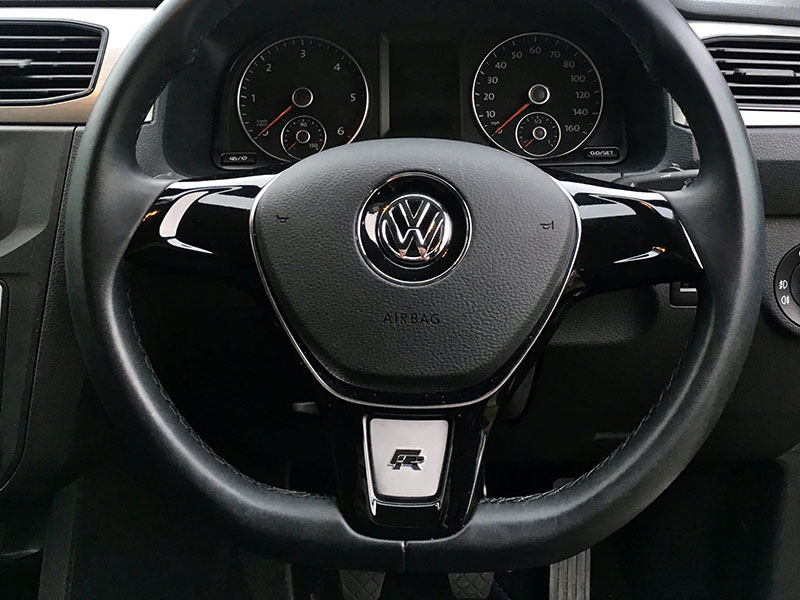

Been looking for either a replacement steering wheel, or upgrading existing one with MFSW buttons.
In the meantime, I picked up this badge from a popular internet auction site, fits nicely in the bottom.

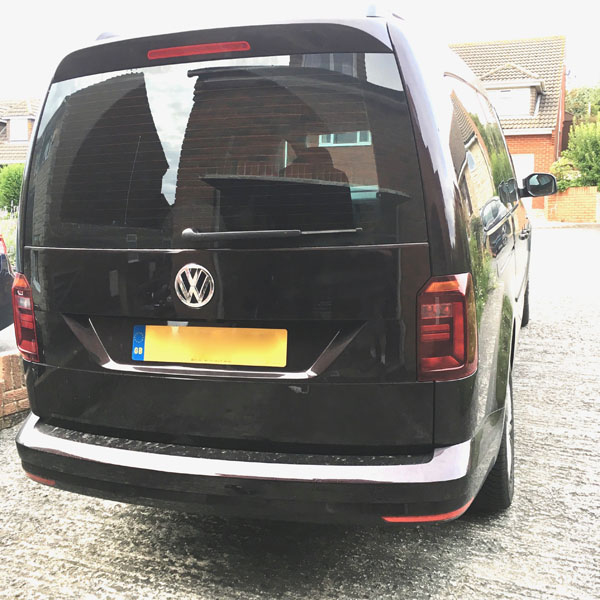

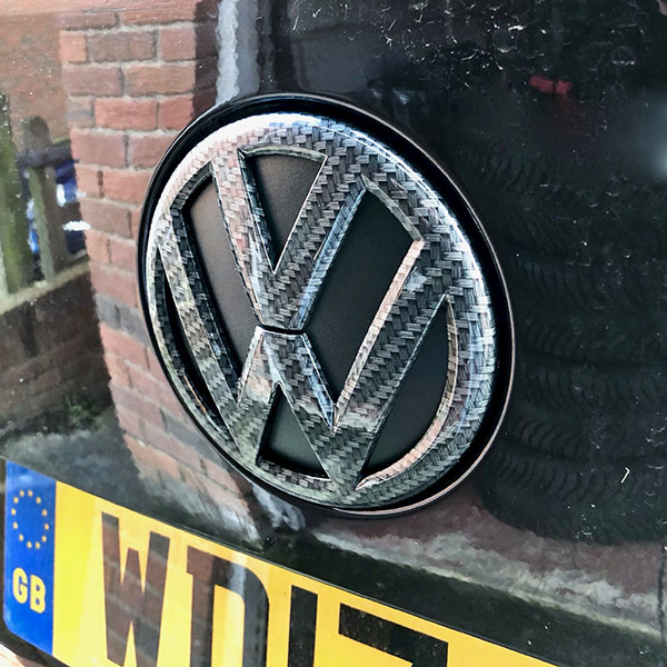

Wanted to change the rear VW roundel but wanted something other than the usual black. I investigated removal & spraying my existing one and then I found this CF one:
Badge removal again easy job with hairdryer and isopropyl alcohol.

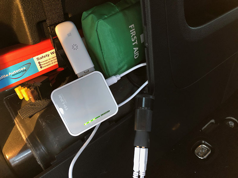

The Android head units work better with internet access, originally I was tethering from my phone, but then thought a dedicated solution would be better and not drain the phone battery if I forget to plug it in.
This is a wireless access point powered from a 12v -> USB adapter, tucked into the cubby panel in the back left side, with a cheap unlocked 4G dongle, and a cheap data only SIM.

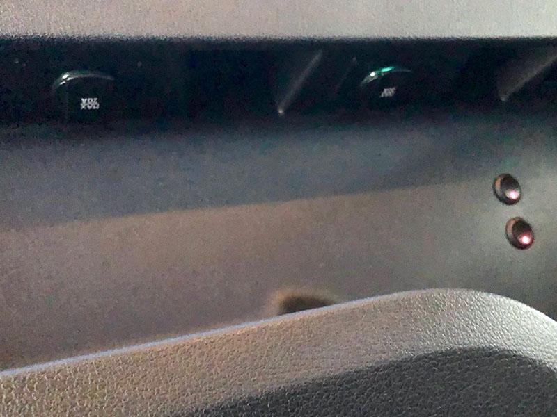

Preparing for the split charge system, I needed to install some additional 12v 20A sockets in the back, and even though I'm not ready to put the battery & DC-DC box in, I've run a live cable direct from the battery to the back left side, and have 3 additional 20A sockets switched left & right side. At the moment, they are connected straight to the van battery, but once the leisure battery goes in, the live cable will go to the DC-DC charger, then and that will charge the new battery. The sockets will then be reconnected to the leisure battery, which will also power the head unit and AV system.

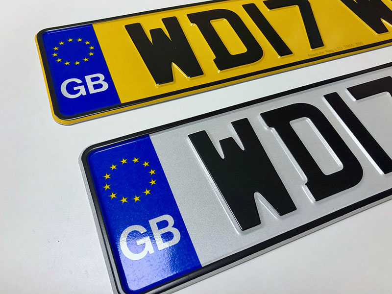

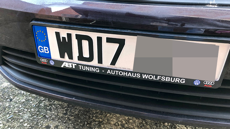

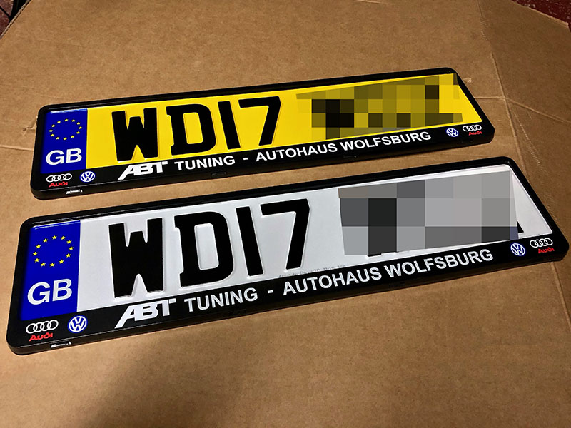

Quite like the look of pressed plates, and ordered a pair with some euroclip style surrounds, look good I think.

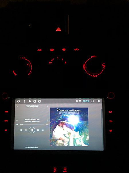

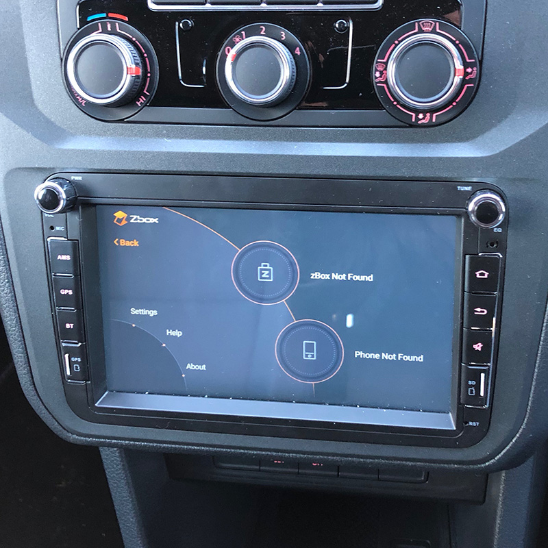

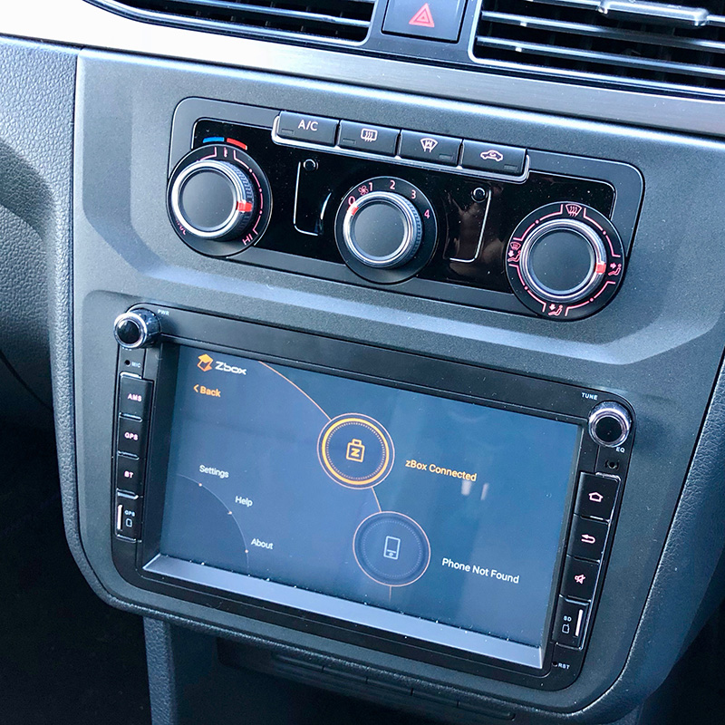

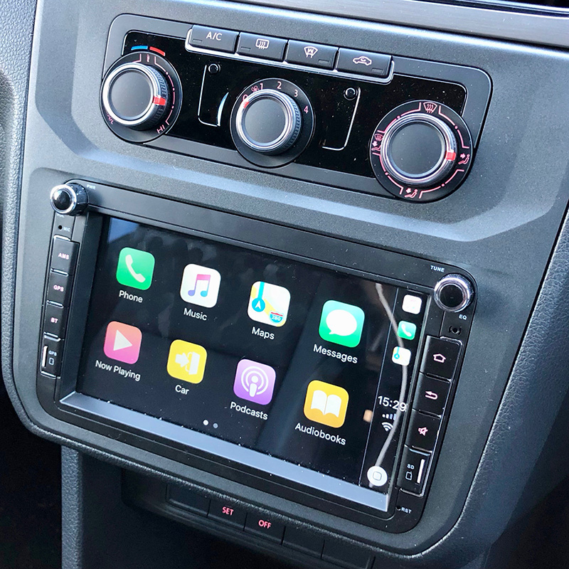

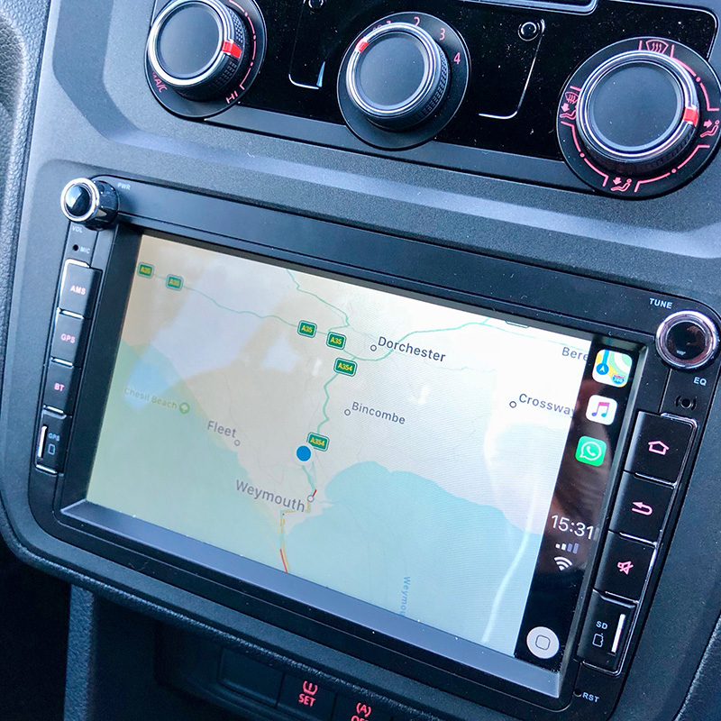

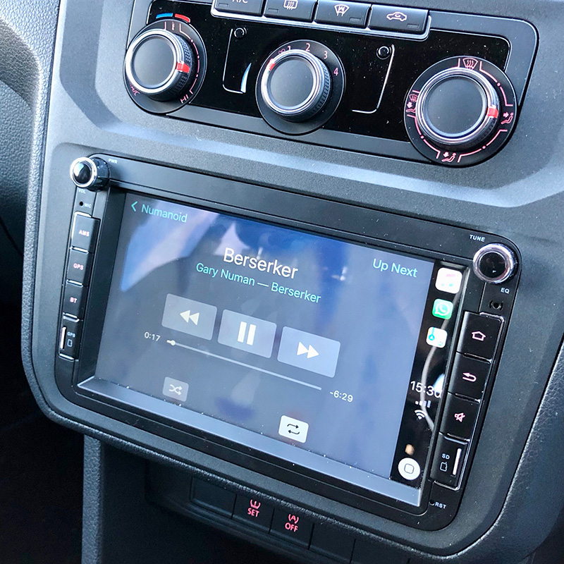

Saw a YouTube video showing somebody running Apple CarPlay on an Android head unit - thought it was too good to be true, but sure enough, found them on AliExpress and ordered one. Worth a punt for $60. Works great!
