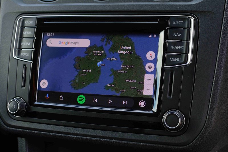

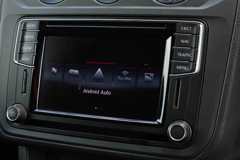

The first thing I added was a Discover Media MIB2 head unit. The sound is much better that the stock one I had. Really like the app connect and Google maps.

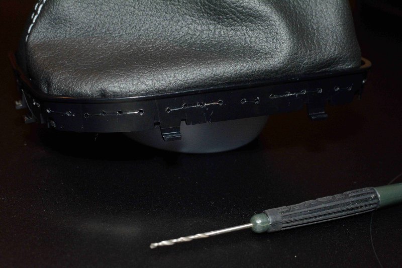

Next I thought I'd tackle the gear stick as it was a bit wore out, I was surprised as the van only has 24K miles on it. I read a post on here when i first discovered the form of someone modifying the gear stick and cutting it down. I didnt think i'd be able to handle it but thought i'd give it a go anyway. I got a Genuine VW Golf Mk7 GTD Ball Black Gear Shift Knob & Boot of Amazon. I switched the base over to the Caddy base, the staples were a hard to get out but I took my time as I didnt want to cause any damage as I normally would :lol:. I didnt want to reuse the staples as they were hard to get out so I could imagine how hard they would be to get back in. I used a small drill I use for fishing and drilled extra holes along the caddy base and then I used a needle and some mono fishing line to sew the gator to the base. Petty happy with how it turned out. I haven't had a chance to install it yet as the van in in the garage.

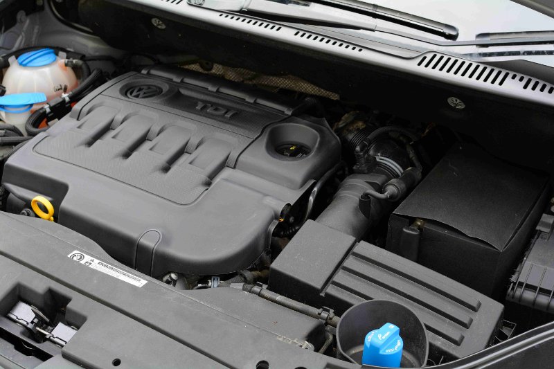

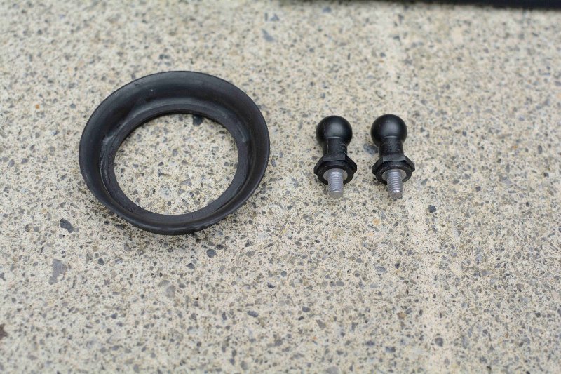

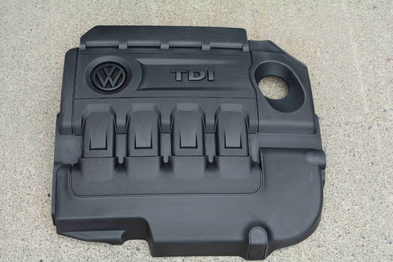

I got a engine cover 04L103925 from the bay, came all the way from Poland, It was in good nick. I got the two VW 04L103164 ball joints and the VW04L133287 washer and managed thisone myself :D

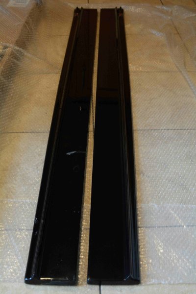

I got a KSB Auto Styling Front Splitter and the TRC Side Skirt Splitters in gloss black. They are been fitted this week when the van is in the garage.

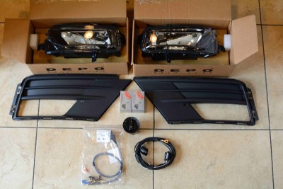

I picked up these fog lights. Wishing I had got the auto switch but Ill take care of that later.

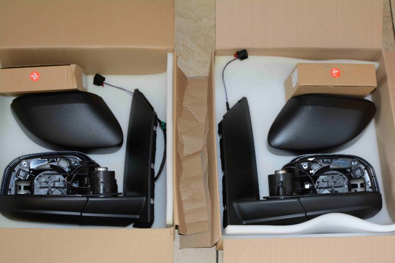

Got some Caddy Life mirrors, really liking these. They are not the electric folding ones, just the regular heated electric ones.
