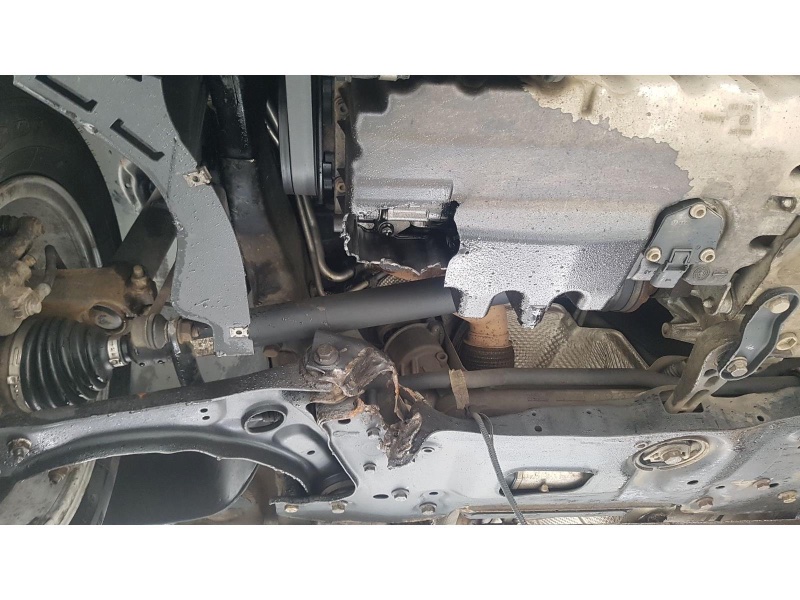

The reason it was at auction… You could just make out most of the old sign writing that was removed… guess at a few bits and finally made contact with the old owner. Turns out he hit a man hole cover that flipped and took out the sump and bent the subframe/arm metal. Turns out, he switched it off straight away and removed a fuse/relay so it couldn’t be started.
Sure enough, removed the old sump, bought a second hand one, change of oil and filter and it started straight up with no problems.

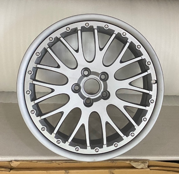

I first started with a set of Audi speed lines.
Bought them second hand that had been acid dipped… turned out they had been dipped for too long unbeknown to me and removed some metal. So the centres were loose in the barrel ever so slightly… making them unusable.
Will correct this at a later date.

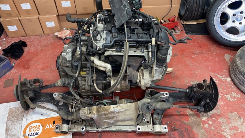

With the old subframe being damaged and steel I decided to go the full aluminium route. Again, keeping it lighter with the unsprung and semi unsprung weight.

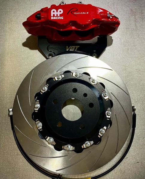

For the front brake setup I wanted to keep it light. So went with VagBremTechnic’s lightest road setup - 4pot AP Racing Radical2 calipers with bell and rotor setup.

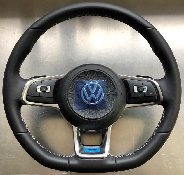

The usual mk7 gti steering wheel - opted for the wheel without cruise on it as I have always preferred it on the stalk…
