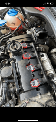

I couldn't wait any longer before fitting some shiny new parts to the Eos. Spark plugs changed for NGK Iridiums p/n BKR7EIX and some Audi R8 coils also from NGK p/n 48041
