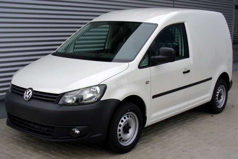

Caddy 3 is the version similar to yours, also called 2K, but yours is the facelift which is from late 2010 early 2011 onwards. The 4 refers to the next facelift which is 2015 onwards and is similar looking. The 5 is the very latest version which is completely different and has little or no interchangeable parts.
Caddy II
Caddy 3 from 2003
Caddy facelift (so still the 3) late 2010
Caddy 4 2015
Caddy 5
The MPV refers to the Caddy Life which has windows, the Kombi is when you have windows in the sliding door and second row of seats but a van rear, and Alltrack (Caddy 4) or Cross (Caddy 3) refers to a version with plastic wheel arches and different trim pieces to make it look a bit off road.
2K is the chassis identification
ZC is the year (2004 = Z4, 2009 = Z9, 2010 = ZA, 2013 =ZC.....)
The models under the 2K chassis were identified by VW as; Original 2K 2004-2010, 2C 2010-2015, SA 2015-2020.
Compatibility on sites such as ECP are not all that reliable as there are parts carried forward between models in the range, especially in the crossover/transitional years.
