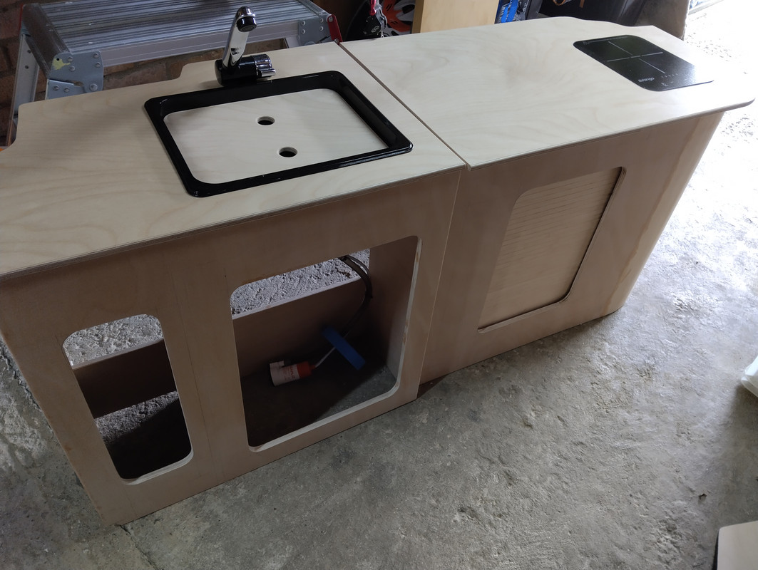

Second part of the kitchen unit. Black rectangle at end is an induction hob.
The plan is to be able to remove the furniture easily. With the sink and hob attached to the worktop it's a bit difficult to remove.

With the worktop cut in half I have now finished, for now at least (needs painting), the sink unit as a fully functioning independent unit. The wire trailing off is for the water pump. This will be replaced with a socket that will connect to a 12v supply

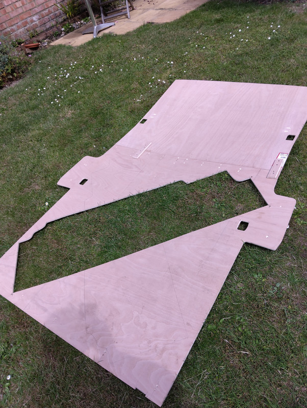

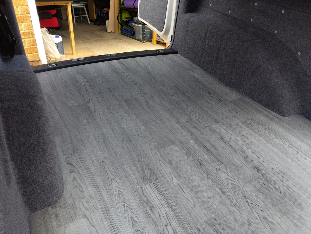

For anyone doing their floor this is a good way to get a professional finish.
The first weird picture is the original floor I cut, minus the first version of the worktop cut strategically to keep the floor in tact.
The reason to keep the old floor was to have a template for the vinyl to cut too and to not have to take the floor up again but that is what I would have done.

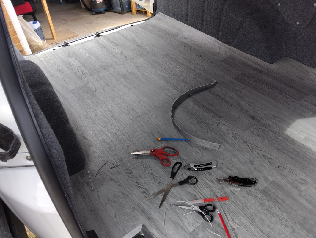

So using the template, cut an inch or two all round the template so that the vinyl is bigger than the floor.
More importantly the vinyl will now sit in the van quite comfortably, unlike an uncut sheet that would be all over the place.

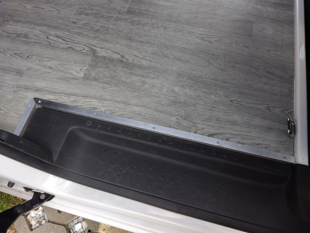

I then trimmed the door steps to the ply floor and fixed the pre drilled and countersunk aluminium profiles to the front of the floor with stainless screws to hold the front in place. I then trimmed the rest of the floor. To a certain degree the carpet lining provides a bit of forgiveness to the cut but it's worth stopping and checking at regularly intervals to make sure you are cutting the right amount off.
As per a previous post I had trimmed the boot plastic to accomodate the ply floor and allow the vinyl to tuck underneath.
And use a proper hooked blade. These are designed for cutting vinyl and only about £4 for a pack. It makes it so much easier to cut the vinyl, that it's not worth trying without.
