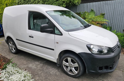

Here's my new Caddy, a 2012 1.6 TDI, it sat in a paddock for 10 years after getting in an accident, it got fixed but never put back together. I found it and have got it back on the road, but it's still got a few issues along with a massive list of things I hope to to to it to upgrade things slowly.
Because it sat outside with no front end on it for so long there's all sorts of front end connections which are quite corroded and I am going to slowly go through and replace the terminals as I get them.
Replaed so far
All 4 injectors
Cyl 3 glow plug - P0673 problem still there
Boost solenoid - P2563 problem still there
Wheels, but will be replaced again in the future
Steering wheel - new one still not working properly yet

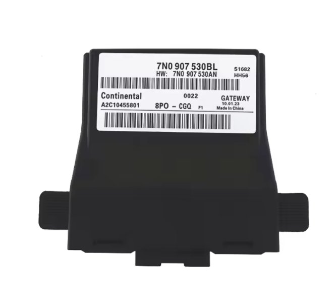

Also needed to upgrade the gateway module, cheapest place was AliExpress and it seems to be working for now.

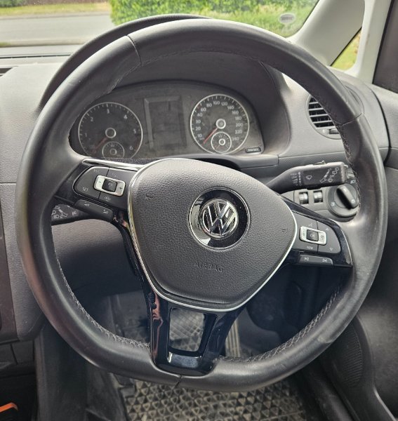

Also fitted a new steering wheel but I need to order a steering wheel adapter and a newer steering wheel module as well so nothing works yet.

Did you have to code in the new gateway module?
myounus
- Posts: 25
- Joined: Wed Dec 04, 2024 10:55 am
Re: Another White 1.6 TDI Caddy Work Van
Changing a gateway requires CP to be removed as well as coding.
It’s the master part of the CP ring.

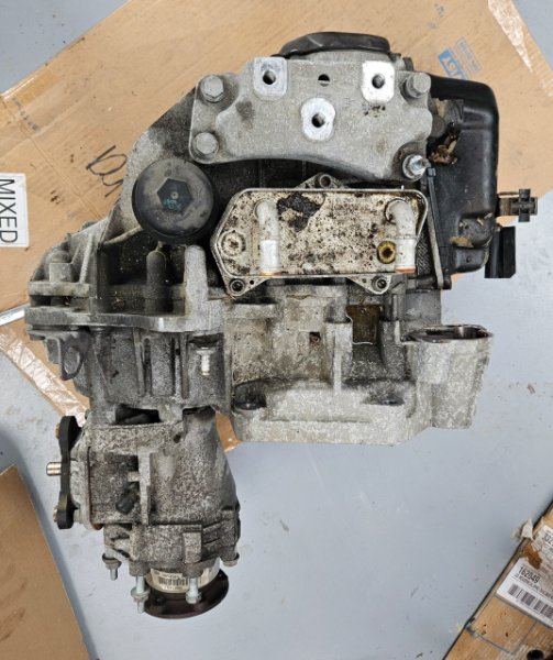

So it had been going great. Since I put a stainless 2.5" downpipe on it and a generic towing spec tune from the local tuning shop on it.
However it turns out it may have been to much power for the little 7 speed dq200 gearbox and over the course of a day it went from a funny take off in 1st gear to unable to use 1st clutch at all and dropping pressure from 60 to 42 bar pressure in about 15 seconds which is way to fast according to the gearbox guy I spoke with Friday.
Codes when I scanned it were
006011 - Cluth 1 - Tolerance Limit Reached
006300 - Function Restriction due to insufficient pressure build up
002113 - Transmission fluid pressure sensor implausible signal
006293 function Restriction due to pressure drop

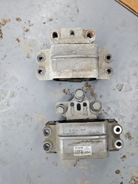

So after doing some friday afternoon and night research discovered that these gearboxes are a massive POS so instead of befitting another one which I figured was likely to do the same again very quickly because of the tune, I searched around and got offered a good deal on a 4WD B8 Passat DQ250 (I think) gearbox.
I'll put up a couple more posts of the conversion and what I needed to do once it's up and running again.
