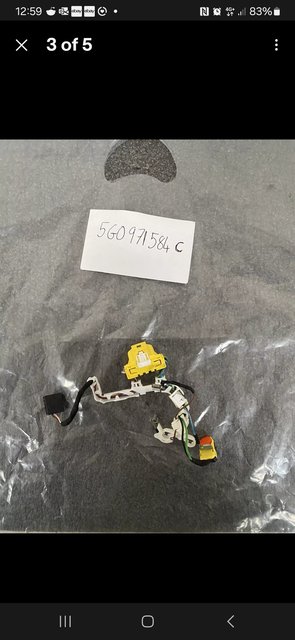

I have a BG gas van, that I'm modding in stages upto the ACC install. I have the steering wheel, airbag, I have a highline SWCM coming this week, but I do not have the correct airbag harness, or highline clock set.
I have requested for access to the other forums but has not been granted yet.
Harness first.
Will this harness work with this setup?
Or can someone point me in the right direction please?
