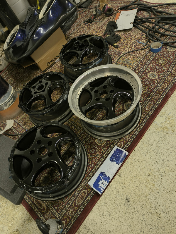

Wheels were in a quite bad shape so i started by polishing the lips. Made a diy polishing rig with an old subwoofer box and a wheel hub :lol:
Forgot to take a picture of the unholy contraption but oh well...
This was the starting point:
First they were water sanded starting with P1500 -> 2000 -> 3000. After that they were polished with medium polishing wheel, then with metal polish.
Turned out pretty good 8)

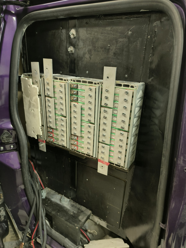

4 battery banks here
4 more to go with upgraded copper bars

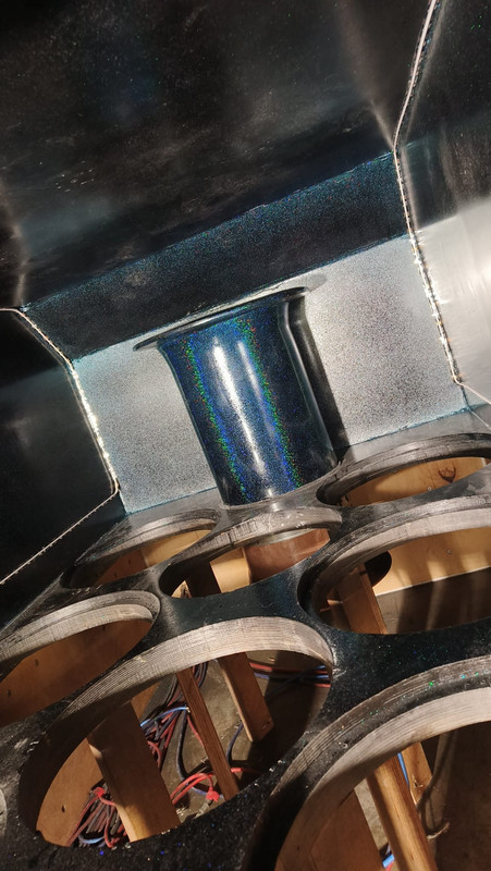

12 inch aeroport installed with some metal flake paint
Wheels are almost ready to be assembled

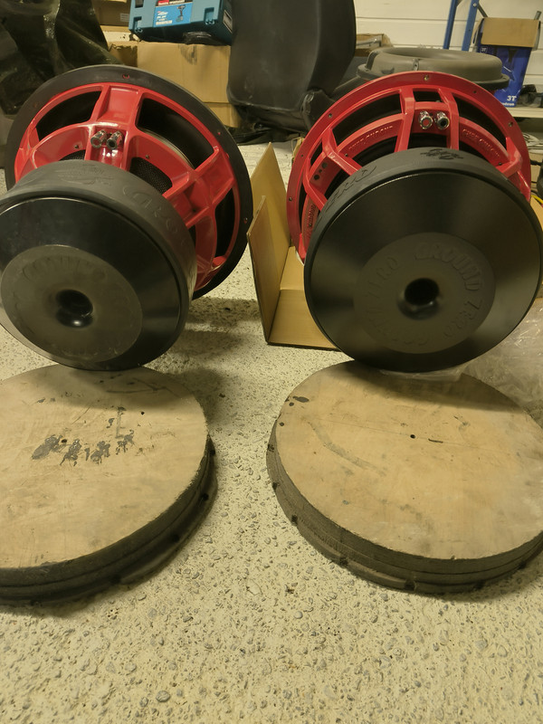

Bought the new subs, Ground zero Plutonium Xmax-II. Had the old version before and the were monsters but had some problems with the lower spider, new subs have 12 ich spiders so that problem should be fixed.
