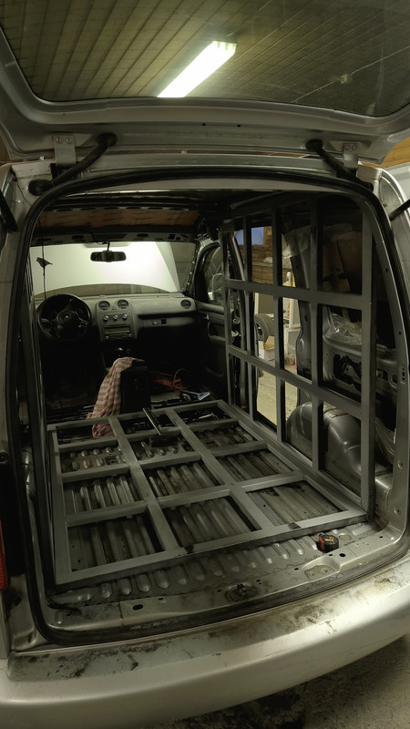

Interior got completely stripped and ready for reinforcements.

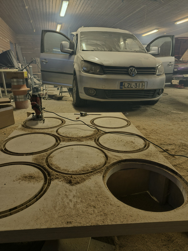

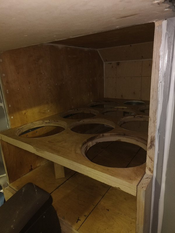

Subwoofer baffle in the making, my cheap router is begging for mercy :D

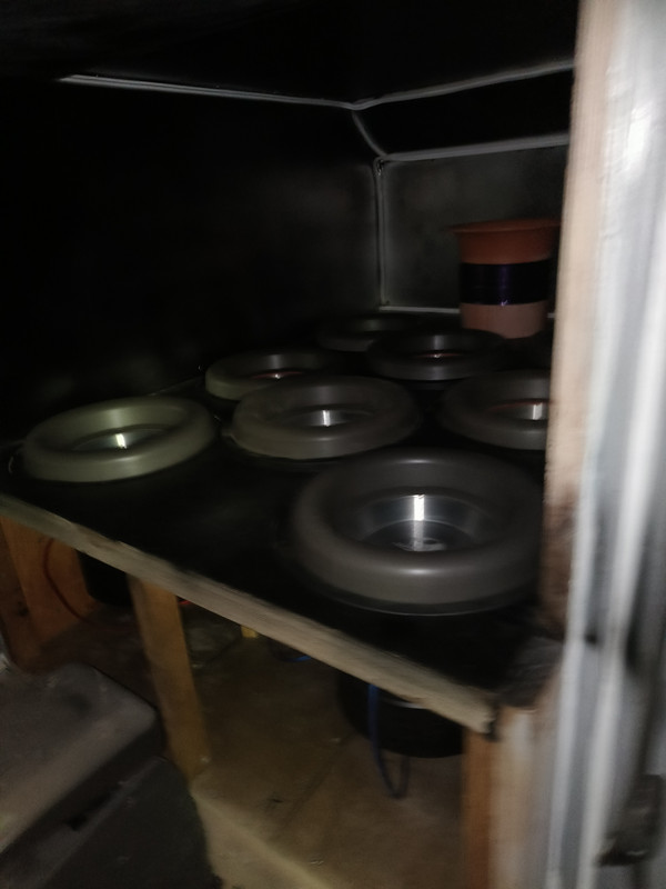

8x 15 inch subwoofers in a 6th order, almost ready. Adding some bracing to avoid any weak spots.

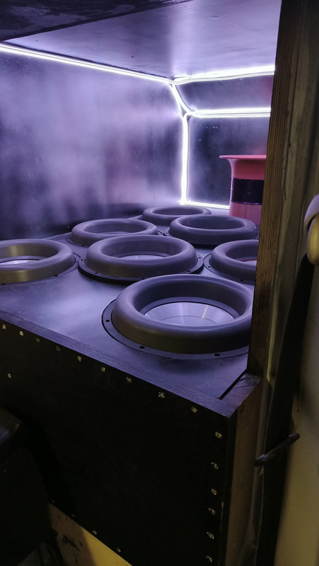

Subs are in. Ground Zero Plutonium xmaxx, heavy bastards.

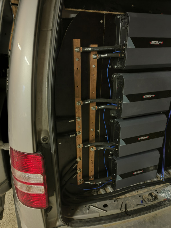

Big subs need big power, soundigital amps and lithium batteries are in. Summer is getting closer so no fancy installations.

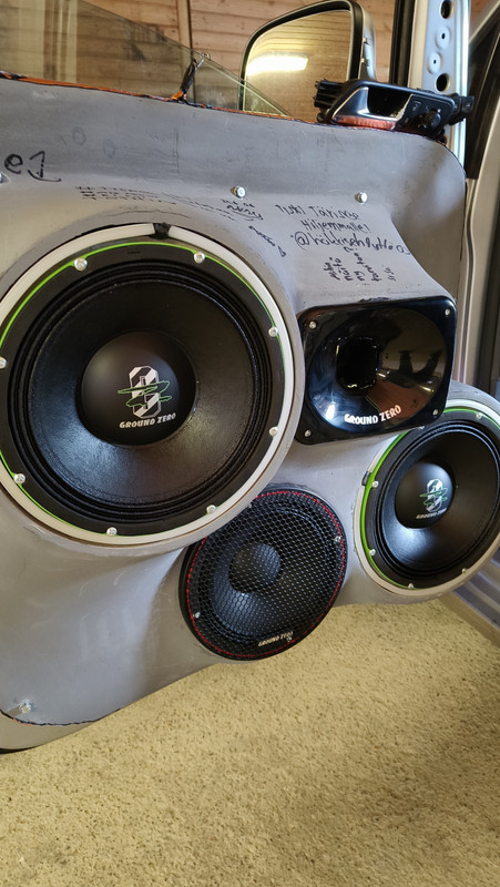

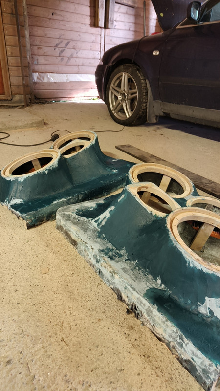

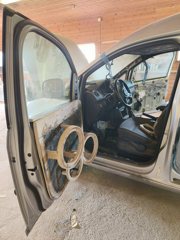

What is bass if you can't hear the music, fiberglass door pods in the making, also my passat says hi.
I still want the doors to be usable so i didn't go too crazy with them, every function is still in and they don't block any vision.
