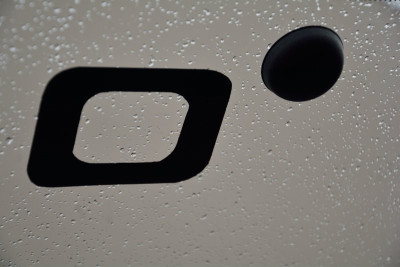

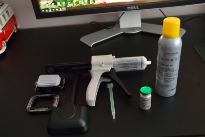

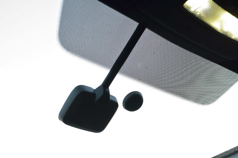

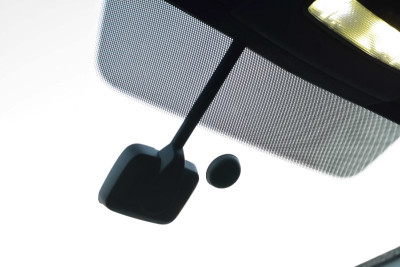

Getting ready to install OEM RLS sensor. I have a MK4 RLS also for when I get my new windshield for the front camera driver assistance programs.

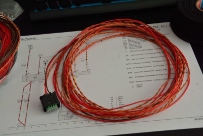

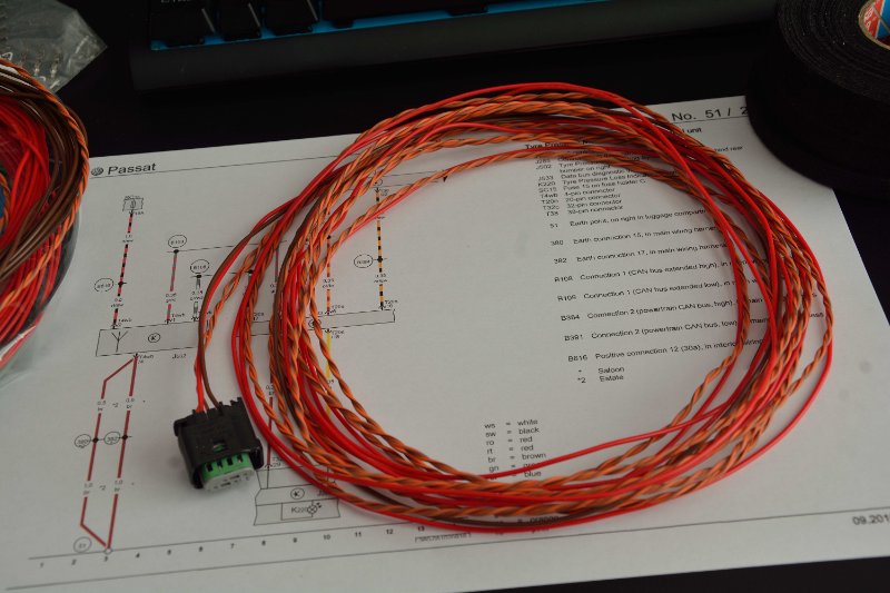

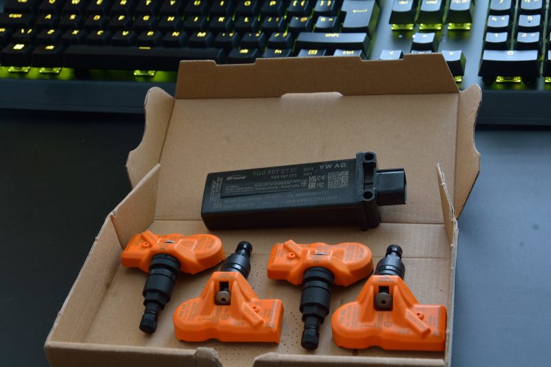

Making up a wiring harness for direct TPMS I am adding soon.

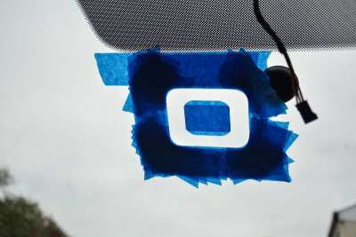

Windshield painted now, ready to glue on the bracket.

Got the TPMS control module and valves, wiring is installed now, just the valves to install now. I had the module re-flashed to H version to work with the 3D cluster.

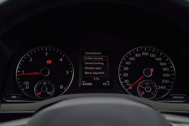

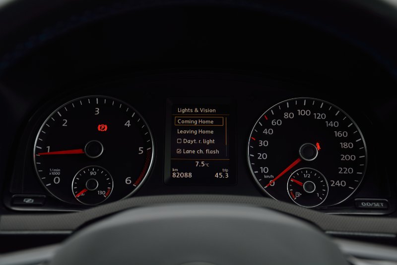

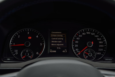

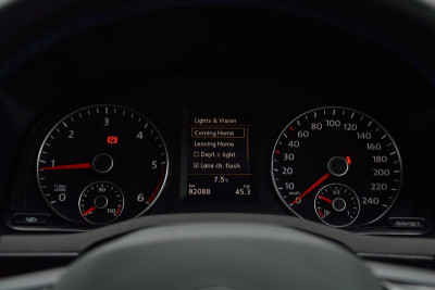

Have the RLS working now, Lights and Vision and Convenience menus added to the MFD.
Coming Home/ Leaving Home lights.
