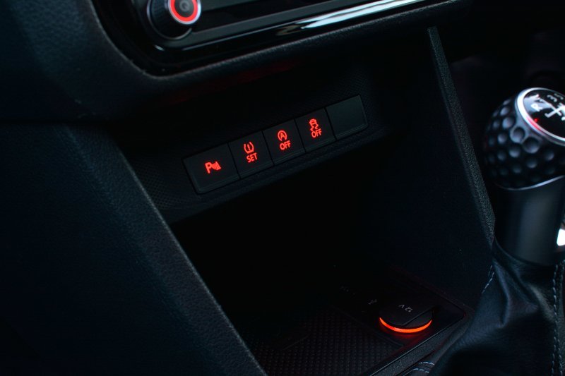

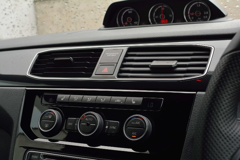

Red illuminated 12v socket installed, wired up to the light switch so it comes on with the other interior lighting.
I have a set of heated seats to install so replaced my climatronic control panel to one with heated seat buttons.

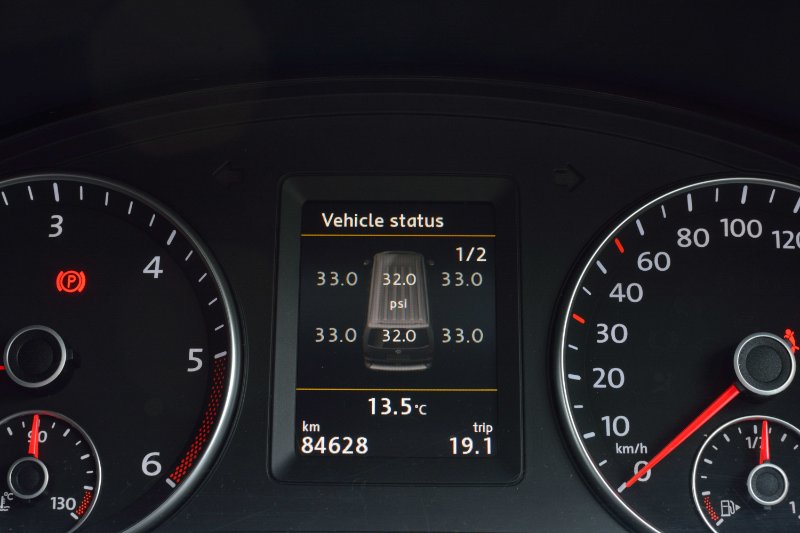

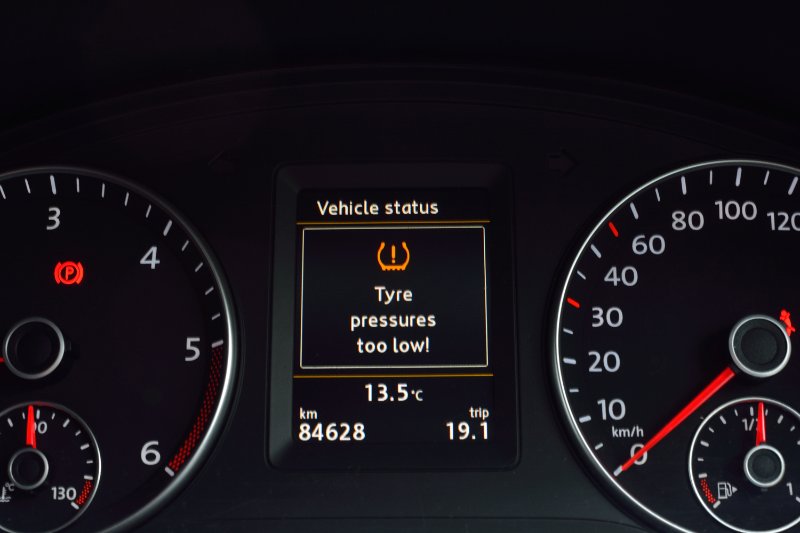

Direct TPMS working now. I had it woorking a while bit I couldnt get it to display the van image, it was displaying PSI numbers. But Robert VW edit my eeprom and now the van image appears :D

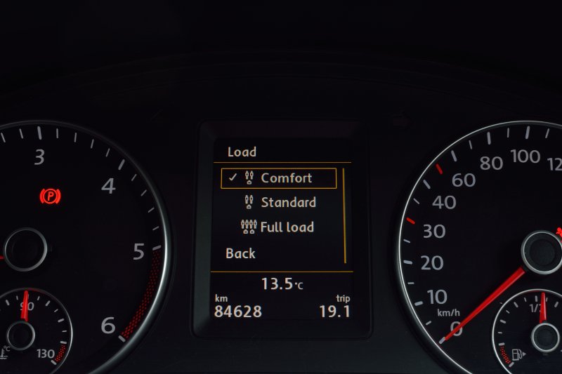

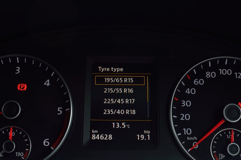

Extra options for TPMS added the the MFD including load and tyre type.

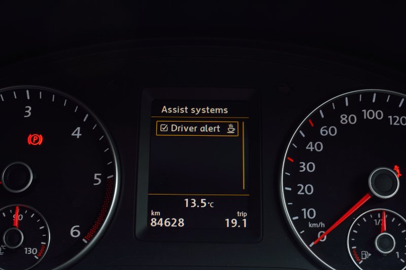

I have Driver Alert System in the MFD after upgrading the CAN Gateway.

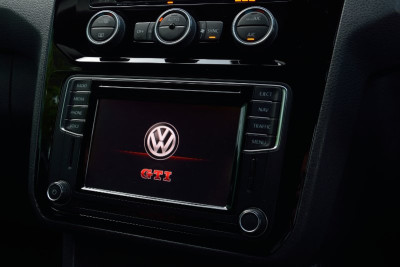

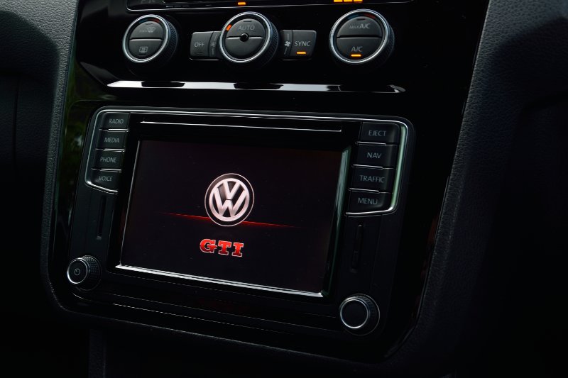

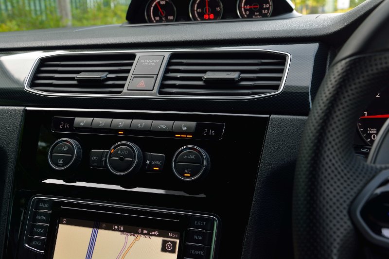

Heated seats installed and wired and changed the MIB start up screen to GTI.
