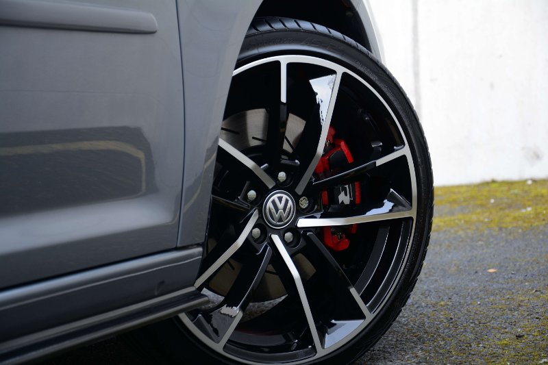

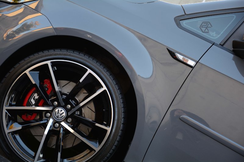

Had the Golf R MK7 front brakes and ESB front 340mm and rear 272mm discs installed today, just have to paint the rear brakes red now. Everything bolted straight on, I didnt have to change the hoses either, Caddy hoses worked fine.

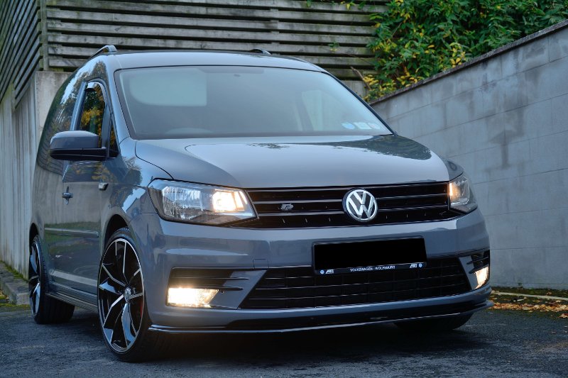

I finally got my fog lights working, my BCM was not compatible with fog lights so I bought a Can Bus Interface for the NSW. The instructions were in German and they seemed to be for a Passat and for wiring into the BCM from what I could make out. I tried 4 garages and we couldnt figure it out. I was about to give up and wire them in as shown in the How To section of the forum but this Interface cost me 55 Euro, I was holding it in my hand last week one night, sick of looking at it by this stage and I noticed tiny writing on the cables, could barley read it but it was instructions on where each cable had to go :lol:

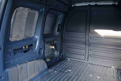

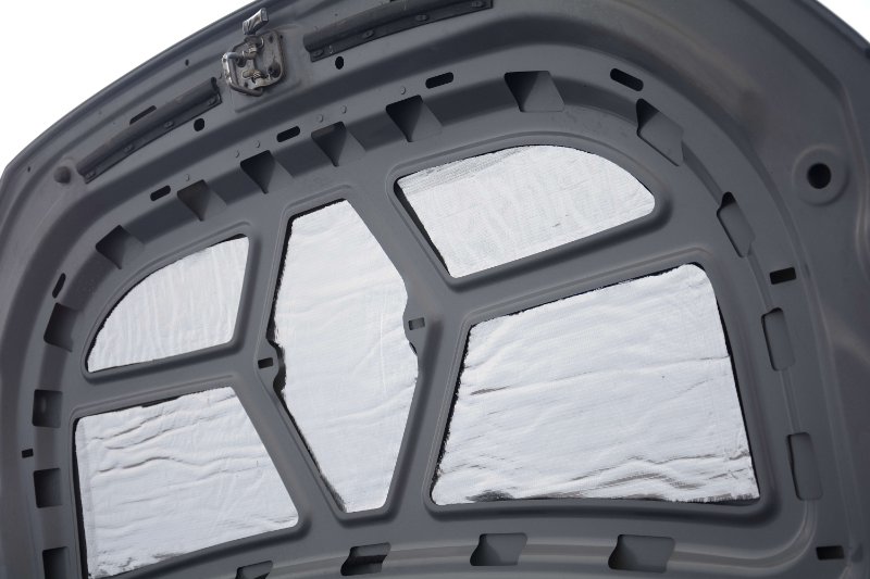

I've been doing the usual sound deadening and insulating, Silent coat on the sides and wheel arches and Dodo Hex Mat on the floor. 7mm Dodo Thermo Van Liner on the roof and sides, could only get the 10 meter roll here so I doubled up on the roof insulation.

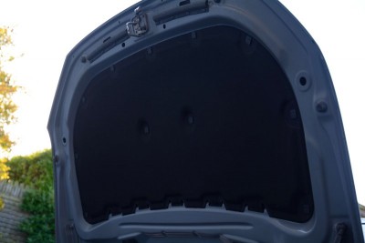

I have so much of the 7mm Dodo Thermo liner left over, looking for places to put it now, done under the bonnet and reinstalled the Sound ABS. The doors and cab are next.

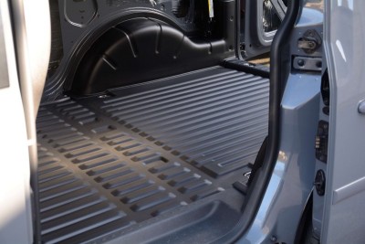

VW Rubber Mat 2k0863717 V79 and the Van Style Inner Wheel Arch Covers installed now. I also installed a new rear door sill cover 2k0864583M and 4 new cap covers 2K0863905 to replace the old scratched one that was on.

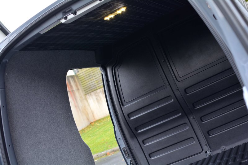

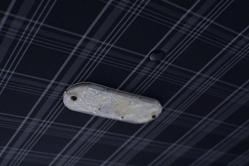

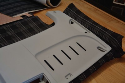

We are back in lockdown here, lucky I have some things to keep me occupied. I have a 10 meter roll of black and grey VW Golf GTi Tartan Upholstery Fabric with Pre Laminated 3MM Scrim Foam back. Cab liner and the load area ceiling are out and plan is to cover them in the tartan. I got rid of the standard load area ceiling and cut a new one out of 5mm Hardwood Faced Plywood. New VW LED Load Area light ZGB7H0052998 replacing the standard one.

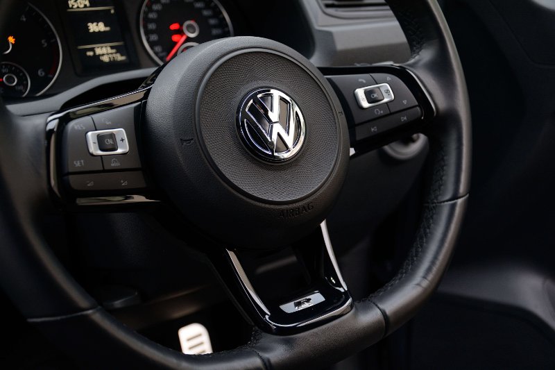

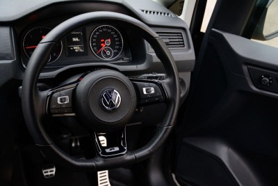

Thanks very much Walshy. More pictures coming soon of the rear load area and cabin, I have the ceilings in and rear carpeted now. Still more to come, I have a Caddy Alltrack front spoiler sitting in the back. MK7 R steering wheel with cruise control going in this week hopefully and Audi S6 Side Skirt Stone Chip Guards on route :D
Good luck finding the right Caddy.
I wasn't planning on changing but I found a seller here in Dublin selling MK7 Golf R MFSW's and when he said he would take my old wheel in part exchange I couldn't say no.

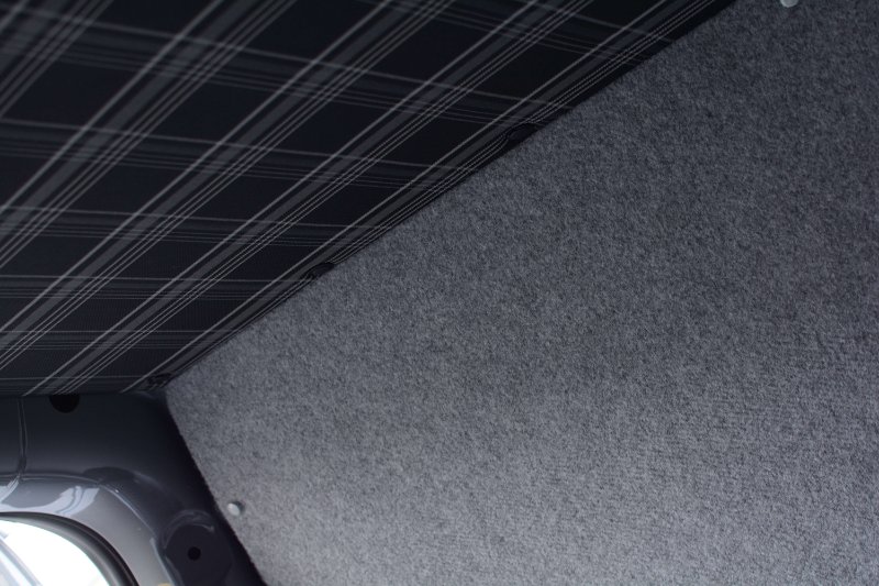

I finished the rear today, smoked 4-way scratched carpet on the sides and GTI Dark Grey Tartan on Pre Laminated 3MM Scrim foam on the roof. Really enjoyed doing it but its good to be finished.
